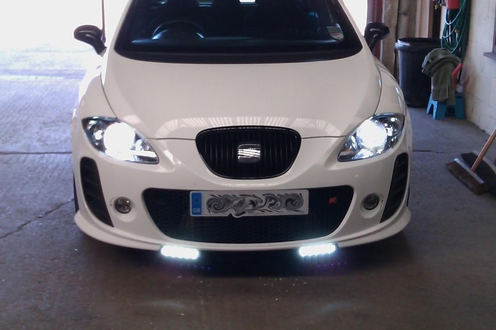

Quick update - the advice I gave regarding connecting the yellow DRL wire to the yellow/black on the car was based on the car with ignition on / engine off.
I fitted the DRLs today and wired them as mentioned previously and noticed that having the engine running gave a slightly different result.  The next six pics are:
6. Engine on / main lights
Spot the difference between 3 and 6....with the engine running, when switching on the main beam, the DRL goes dim instead of going completely off.  Not sure if I prefer this or not.  I may get the multimeter out and test things again but with the engine running this time  :ashamed: However, I'd be interested to hear opinions - DRLs dimmed with main beam or off???
6.

I can see why folks may be confused with your DRLs, Robin but I guess getting seen (for all the right reasons) is what it's all about. I was reading about some anti-DRL campaign where one of their main arguments was that DRLs take away from other road users, like motorbikes, who use their lights to get themselves seen. Personally, I don't buy that - I would rather see both and can't see how a DRL on a car would 'reduce' the visibility of a motorbike.
....In one of the many studies I read, surveys in the UK in particular, noted that when DRL's are either in headlight format or at headlight level above the ground, they can conceal the single headlight of a motorbike in front. I think you'll find that this is why bikers are against them. I can see their reasoning and agree.
This is also why I'm personally against DRL's unless they are at lower level or in LED strip format (Audi style) so they are more difficult to confuse.
Additionally, this is also why I am in favour of DRL's being switched off when other lights are switched on < This was an aspect of my DRL's which carried a lot of weight in my favour when I was very politely challenged by the UK Police. But that might be down to the individual policeman/woman.

So......i have quickly read through this very interesting thread and still would appreciate a pointer as to whether i should have the DRL,s swith off on main beam. I currently have them on all the time but could easily wire them up to swith off either on side lights or main Xenon,s.  I don,t want to get fined but then again i like the look of them with my main lights on.
Re: Blue Bullet DRL - Version 2 (OEM Style)
« Reply #100 on: September 20, 2010, 09:21:12 pm »
I run them the same as you have there and have had no problems and I do a lot of work with the Fuhrer  :smiley:
