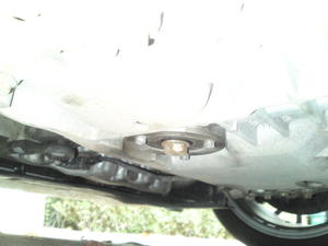

i have just checked and it looks like i have the vwr lower mount fitted already!
so really need ideas how how to fix this dam issue, cant put foot down at all!
