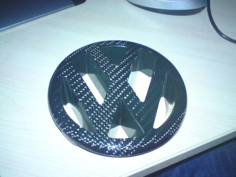

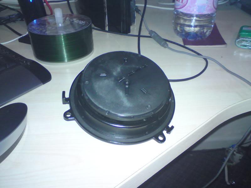

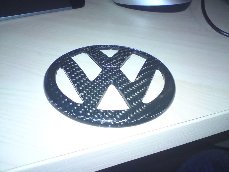

Hey Guys, with thanks to every one who arranged for the Carbon Fibre badges, I now have a Sweet pair of Carbon Fibre Badges! Although there is a problem I have the front and rear badge but have no idea how to change them. Any help would be appreciated! :)
This is what i was sent:
Front Badge:
Rear badge:
Boot handle (for some reason):
Thanks!

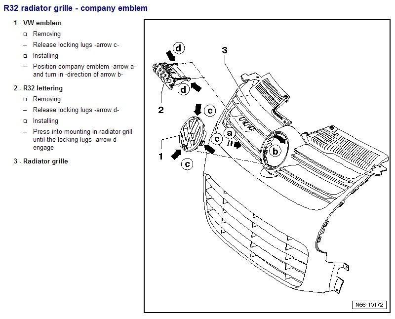

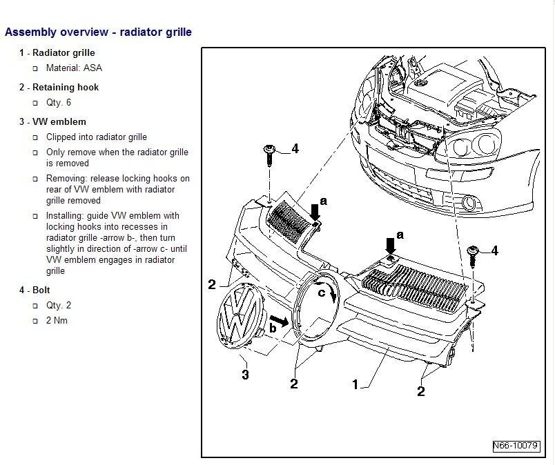

Just spotted your an .:R32
you'll need this version:

Thanks for that, will give it a go when i see my car, any idea for the rear??  :smiley:

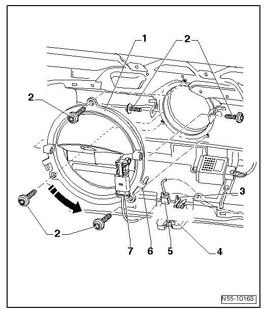

Re: Need help: VW Badges!
« Reply #4 on: February 14, 2009, 04:28:17 pm »
–   Remove rear lid trim
–   Remove rear window wiper motor
–   Separate connector -7- from release element -1-.
–   Remove bolts -2-.
–   Loosen release element contrary to the -arrow- from the retaining brackets -6-
–   Then remove release element -1-.

quick question mate,
did you buy the same gti front badge as everyone else or was your badge especially for the gt/r32?
i bought a gti grill for my gtsport and tried fitting the gt/r32 badge and it was much bigger and didnt fit  :confused:
in other words the gti badge is smaller than your r32 one, just letting you know before you got to the hassle of fitting  :happy2:
« Reply #6 on: February 15, 2009, 09:59:47 pm »
^^^^ Thats a good point Dan as the VW badge on front of the wifes Jetta is different from the GTI too  :surprised:
« Reply #7 on: February 15, 2009, 10:04:56 pm »
Manu if you find that it doesn't fit and you have the wrong size i might know a buyer for it. give us a pm if you find this is the case.  :smiley:
Offline Manu_R32
  • Posts: 109
« Reply #8 on: February 16, 2009, 01:34:00 am »
O...k, did not expect this to happen! I tried changing the front badge this weekend when realised it fit in the space but I could not twist it into place! Top Cat, i am going to ring the TT Shop, see what they say and then I will send you a p.m if thats alright? Will keep you guys posted!  :happy2:
