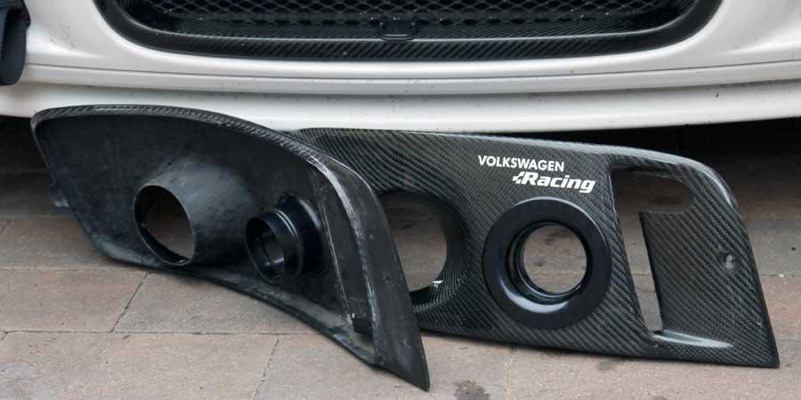

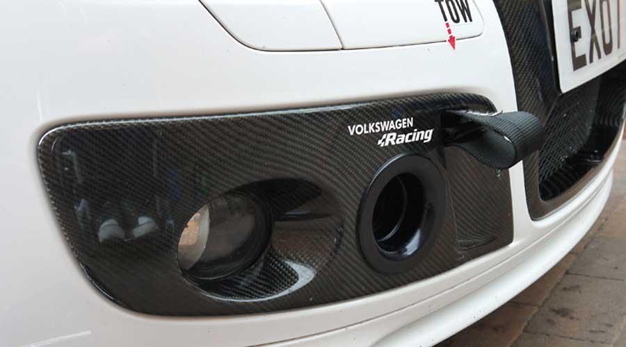

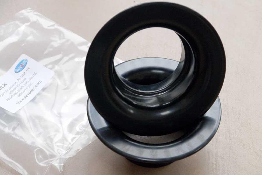

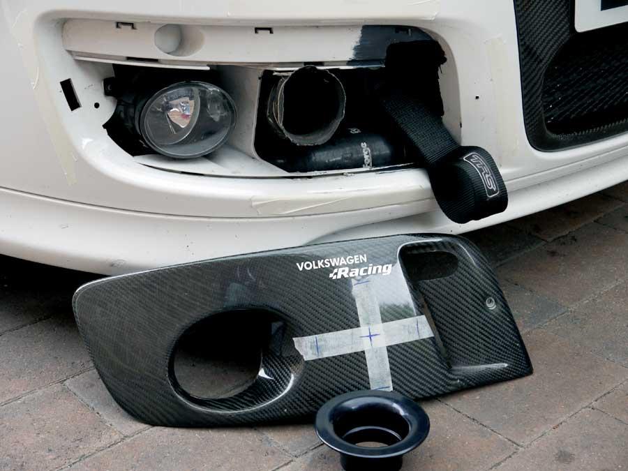

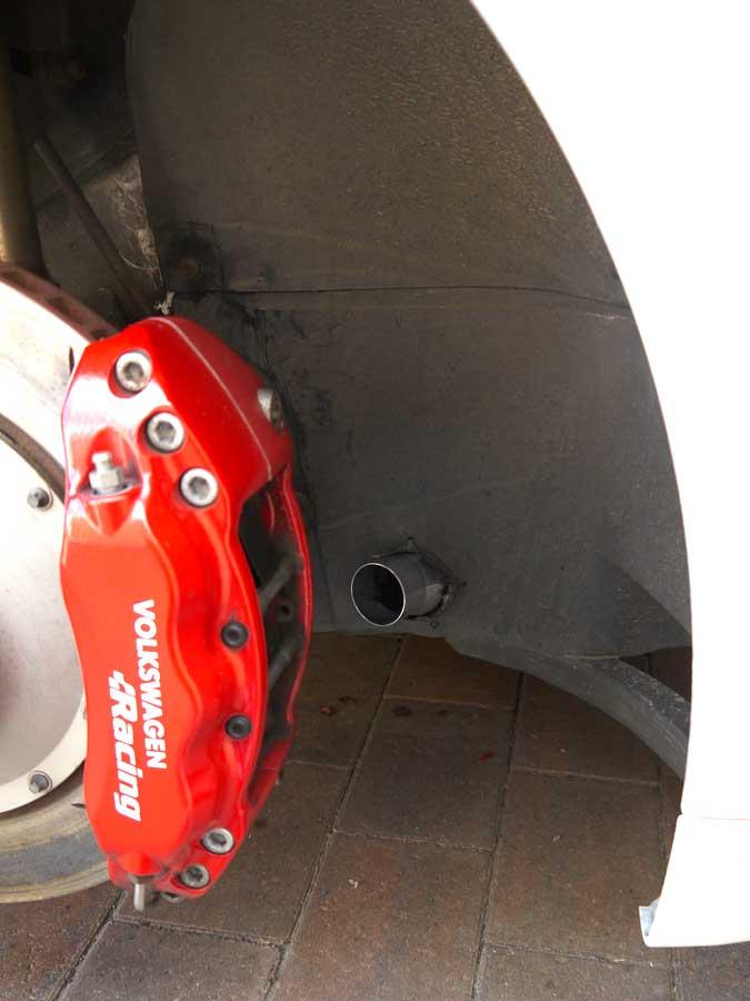

A DSG is always going to be harder on the brakes than a manual and I’d cooked them in 4/5 laps of Donington,  (I had to let Ross past in his R26R  :ashamed: it is 75kg lighter though).
Thought I’d try to improve the cooling to the front brakes  :happy2:

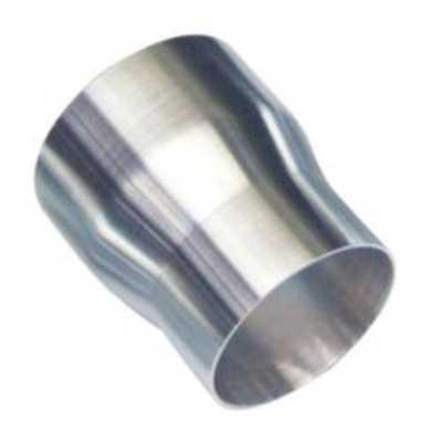

63mm Spun Aluminium Air Inlet on to 63mm Ducting.
Aluminium 60>50 Air hose reducer to get some air flow direction.
Stuck a hairdryer (not mine) in the front and seems to work OK.
I've done a track day at Bedford with this fitted but hard to tell if it worked as it was pi$$ing down.

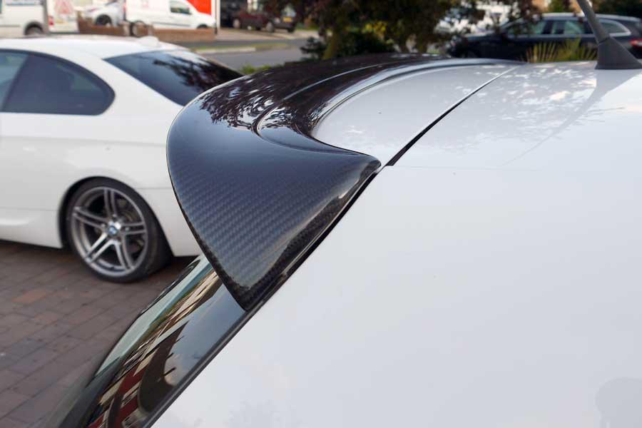

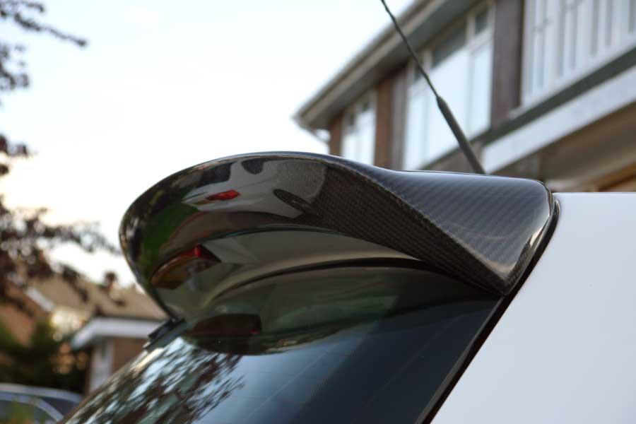

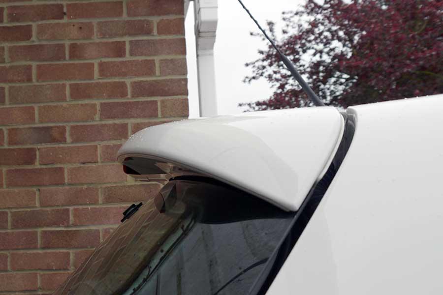

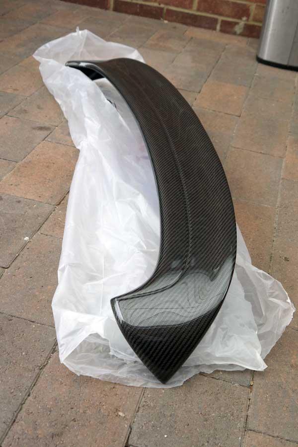

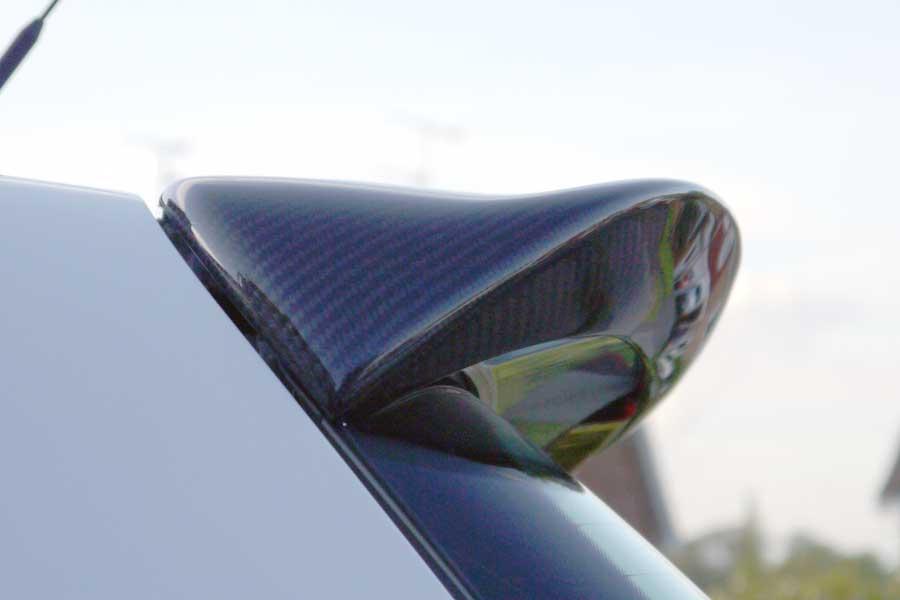

OSIR  Telson GT1 Carbon Spoiler
Before
OSIR is bonded over the old spoiler.

I think that ducting needs to go nearer to the disk as at the distance of wont have much effect.
