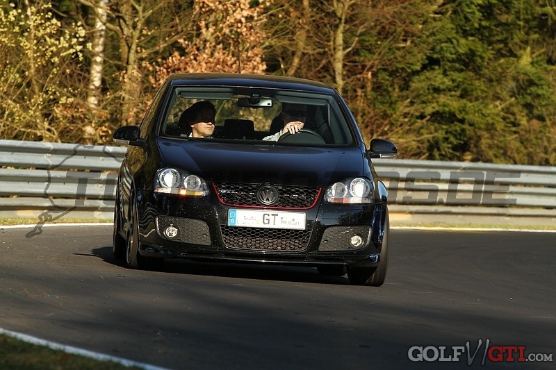

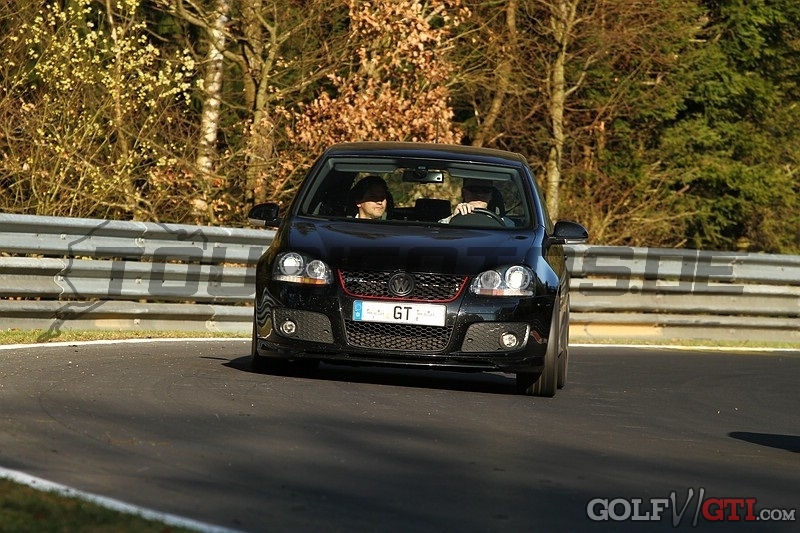

Sadly I have no video of this. Last sunday I had a visit at the ....
.... Nürburgring Nordschleife.  :drinking:
Due to business I had a trip near the Nürburgring. That's why I've run 19" street tirers.
 :smiley:
ps:
no brake issues  :wink:

Nice photos and good news about the brakes (but Nurburgring is not exactly a demanding circuit brake-wise).

I know, Rex. Guess I'd have cooked my brakes on the Hungaroring as well.
I also had some issues: no grip (I was on Conti SC3) and some rubbing.   :jumping:
No good idea to run 8x19 ET45 on the Ring.  :fighting:

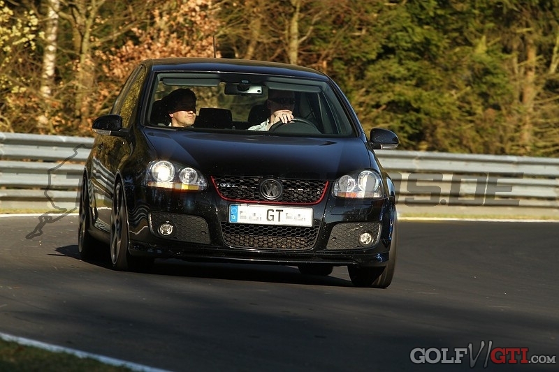

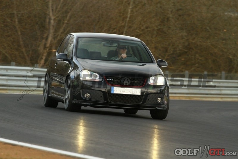

I couldn't resist and went again to Green Hell:  :booty:

And again you brought the wrong wheels  :signLOL:
