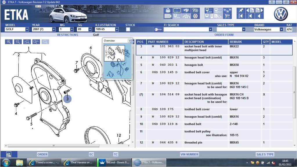

@ Damo:
Yes, because your description says socket head and it's round without any hex sides to grip.
As such small items, much to my surprise but they are German, are on the parts system it shouldn't be a problem getting them.  :happy2:

Try 'wht 002 612'- M6 x 18 T30 head around 45p.
....Cheers Dave  :drinking: - Is that a non-VAG part #?

Straight from Etka standard hardware catalogue.

I know its not the same position as your pic but I've been out to my car and it looks exactly the same as the one in your pic..
