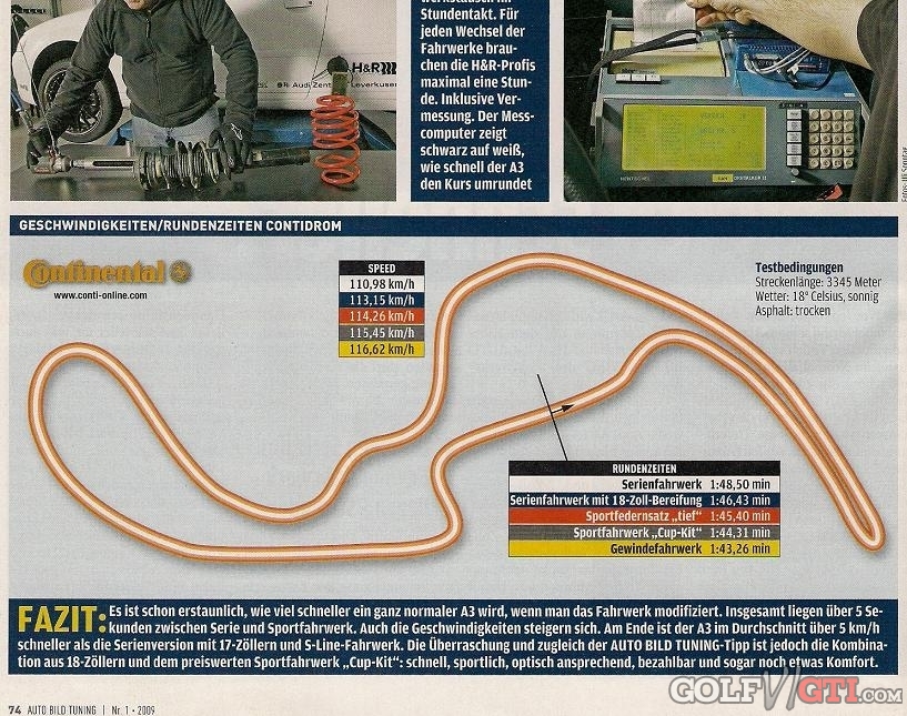

I don't know any test comparing 17" and 18" except http://www.kumhomotorsport.pl/prasa/AutoBild_0205.pdf.
But I have discussed this issue to Raeder Motorsport and some
other mates doing motorsports.
So I'm sure there is no loss of grip with the 18". Raeder prefers
225/40 R18 on Golf and A3.
Most of the professional teams currently also use 18".

I now have found one more review for you:
'White'' ist stock Ambition 17" and ''blue'' is 225/40 R18 Hankook S1 on 8x18,
both with stock suspension.
I currently run 17" on Denvers. I will defintely go for 18" Direzzas when the
Federals are worn.
