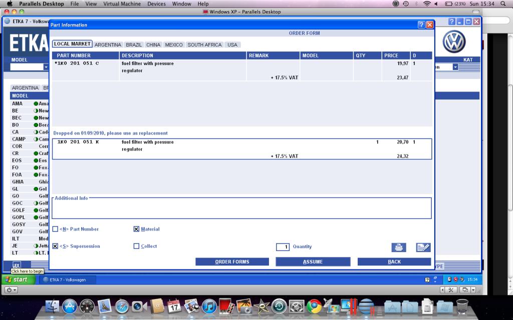

Can anyone tell me what the part number is for the fuel filter on a GTi and are they the same for all the VW petrol models on the Mk5 models?.
Thanks in advance
bacillus
Just look at my post count
-Given: 4
-Receive: 453
Posts: 6341
Re: Fuel Filter part number Req'd
Reply #1 on:
April 17, 2011, 01:50:04 pm »
No, the specific GTI one has an internal fuel pressure regulator.
iirc the part number is 1K0201051C but let someone else double check...
