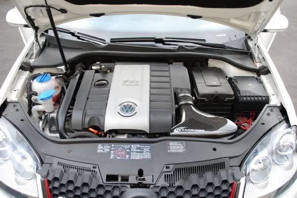

picture of a standard pirelli (hope jay doesnt mind me linking)

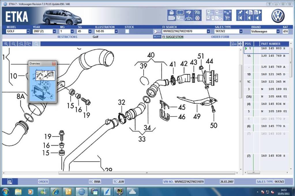

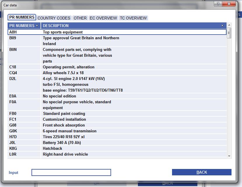

Yep, I have the charcoal cannister.......I actually broke the pipe to the charcoal cannister when trying to find the mounting lugs for the end of the noise pipe.....ARSE....as its £75+VAT....thats an expesive lean.....GRRRRRR  :ashamed:
This is the ETKA picture I got from the VW dealer.....shows the "noise pipe"......don't know if that will shed any further light on it....?
and I've check with the dealership and its definately a UK vehicle.....
I wonder if the previous owner has retro fitted it to add that extra noise??

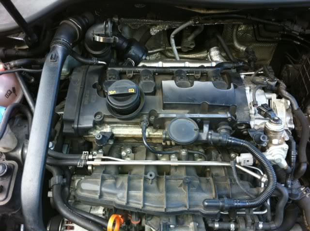

Ok, so this is what I've got fitted....definitely the "noise pipe" the yanks go on about.....
I've therefore ordered up the S3 intercooler pipe, as this cuts out attachment for the noise pipe. I've also ordered a Carbonio Intake and it'll make the engine bay a lot tidier.....now all I've got to do is trace where I'm loosing boost pressure from....I've got an air leak "pressure side" acording to the 5051d diagnosis machine....so when the pipe has arrived I'll get it up on a ramp and have a good look.
