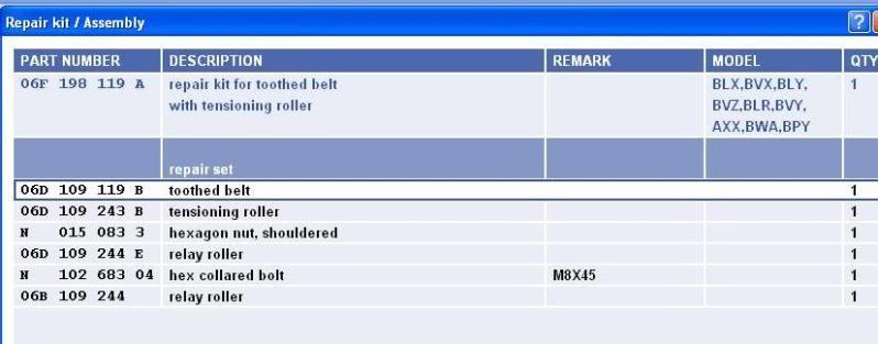

06F 198 119 A is the kit for the AXX engine 06 GTI.  Consists of below.
The only difference I can see for a BYD (Ed 30) engine is the Tensioner roller is
06D 109 243 C
« Last Edit: June 27, 2011, 07:08:56 pm by QD »

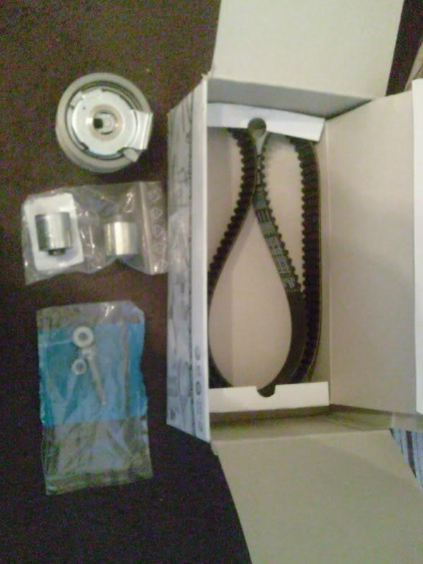

Re: Edition 30 Cambelt Kit Parts
« Reply #9 on: June 27, 2011, 08:06:48 pm »
Can anyone tell me if i have a complete kit here?
Thanks;
Its for BWJ TFSI Cupra
Offline QD MBE
  • -Receive: 102
  • Posts: 2497
« Reply #10 on: June 27, 2011, 08:10:36 pm »
Looks right.  What is part number on the belt?
« Reply #11 on: June 27, 2011, 08:13:15 pm »
06D 109 119 B , Me thinks
The AUX Belt is a shorter one to bypass the Air Con Compressor. (not pictured)

« Reply #12 on: June 27, 2011, 08:16:20 pm »
Should be spot on then.
« Reply #13 on: June 27, 2011, 08:19:56 pm »
Thanks.
Having it done at Dealer.  They want 90€ extra for taking aircon compressor off  :fighting:
