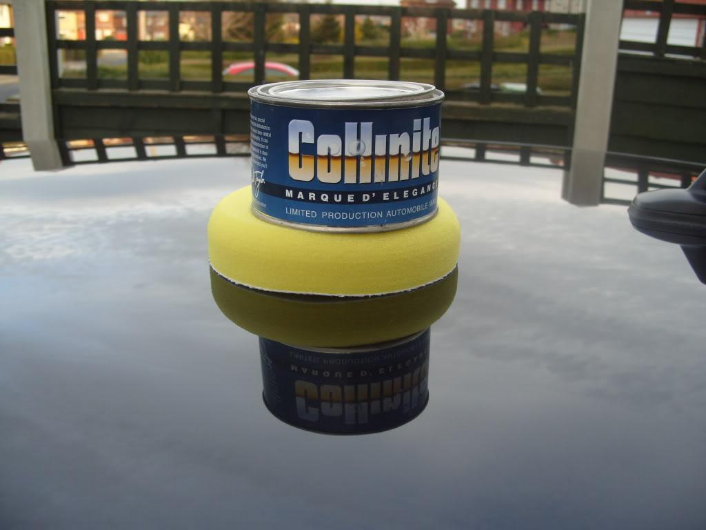

Well it was forecast nice weather for the weekend so thought I would start a good clean on the car. I started friday about 1pm below in order of job.
Friday
Rinsed car with P/Washer
Soaked with Snow Foam and left to dwell for 10 mins
As no 1
Soaked wheels with heavily dilute Megs S/Degreaser and aggitated with wheel brush
As no 1
TBM wash with Zymol auto wash and Megs MF mit
Saturday Morning I started again
Clayed with Sonus green - lubed with diluted CG extreme Maxi Suds 2
As no 1
Rotory polished with sonus polishing pad and Megs #80
Rinsed off once more just to get rid of the dust and polish
Sealed with Megs #21
Waxed with Collinite 915 Marque D' Elegance & a Megs applicator
 Sunday
Waxed again second coat of #915
Im sorry I only have after shots not progress pics or befores but it wasn't that mucky any way.

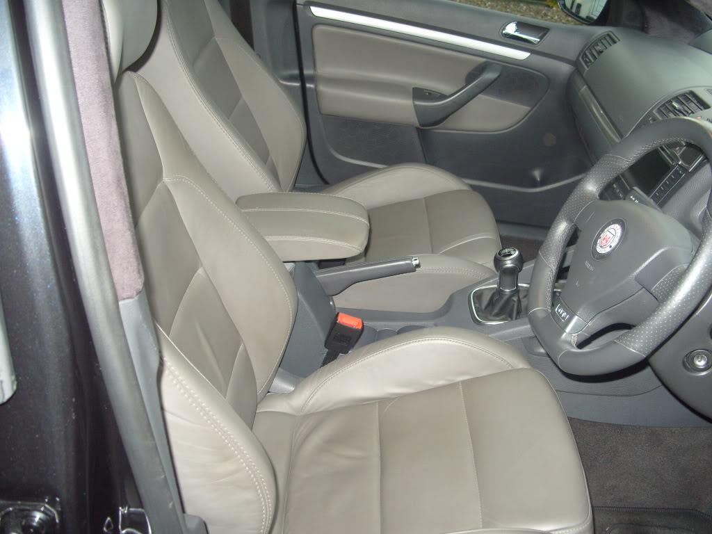

Golfman(Scott) asked for a couple of the interior so thought I better clean in here aswell

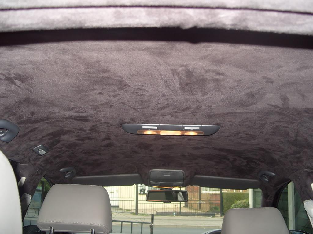

Black suede headlining
full leather re-trim in porsche grey nappa

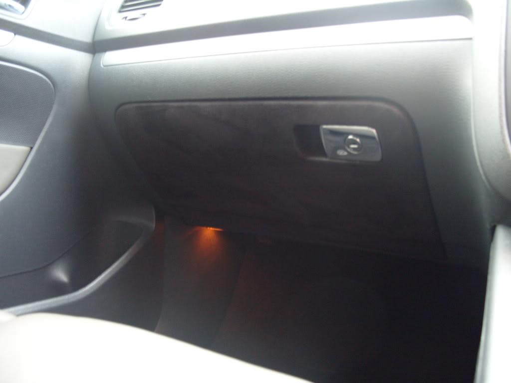

Last one left over suede put to good use on the glove box lid.
looks a bit purple but still cool as hell. how much and where did you get it done
