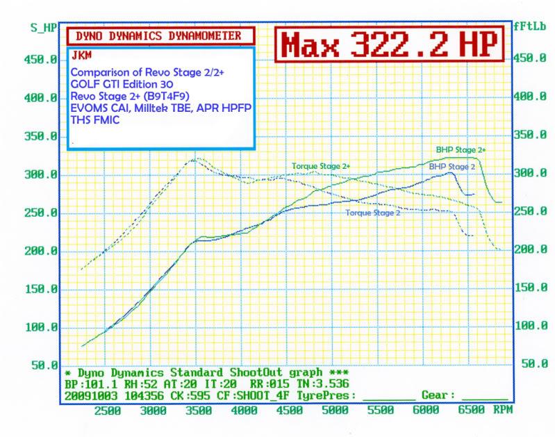

BHP and torque will depend on which dyno the car goes onto to be honest. There are plenty of build threads on here that have info on this (mine for one) so worth you trawling through those [search is your friend].
These are some figures, comparing Stage 2/2+ on JKM's rollers (note other mods in place)
I actually get better fuel economy when genral driving m,apped over stock. But I'm not bothered with fuel costs, you have to pay to play..

Thats a really useful graph Dom, I have similar hardware to yours (Miltek TBE, APR pump, ITG intake and Forge Cooler) and only running Stage 2 revo. Assuming you have run the same mods with S2 and S2+ how different do the two maps feel on the road. Looking at the graph I'd assume it pulls harder from 4.5k and holds onto the power longer?

Worth noting that the same setting, similar ambient temp and pressure have seen variations in dyno readings from 322 (above), 345, 368 bhp. So yes, it is a lottery. What you should be looking at is the difference between the two sets of graphs to look at relative performance differences. With the APR HPFP the difference in mid range is immense between 2/2+, although overall I think that Stage 2 is a more rounded package.
