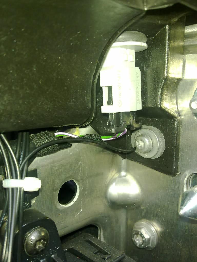

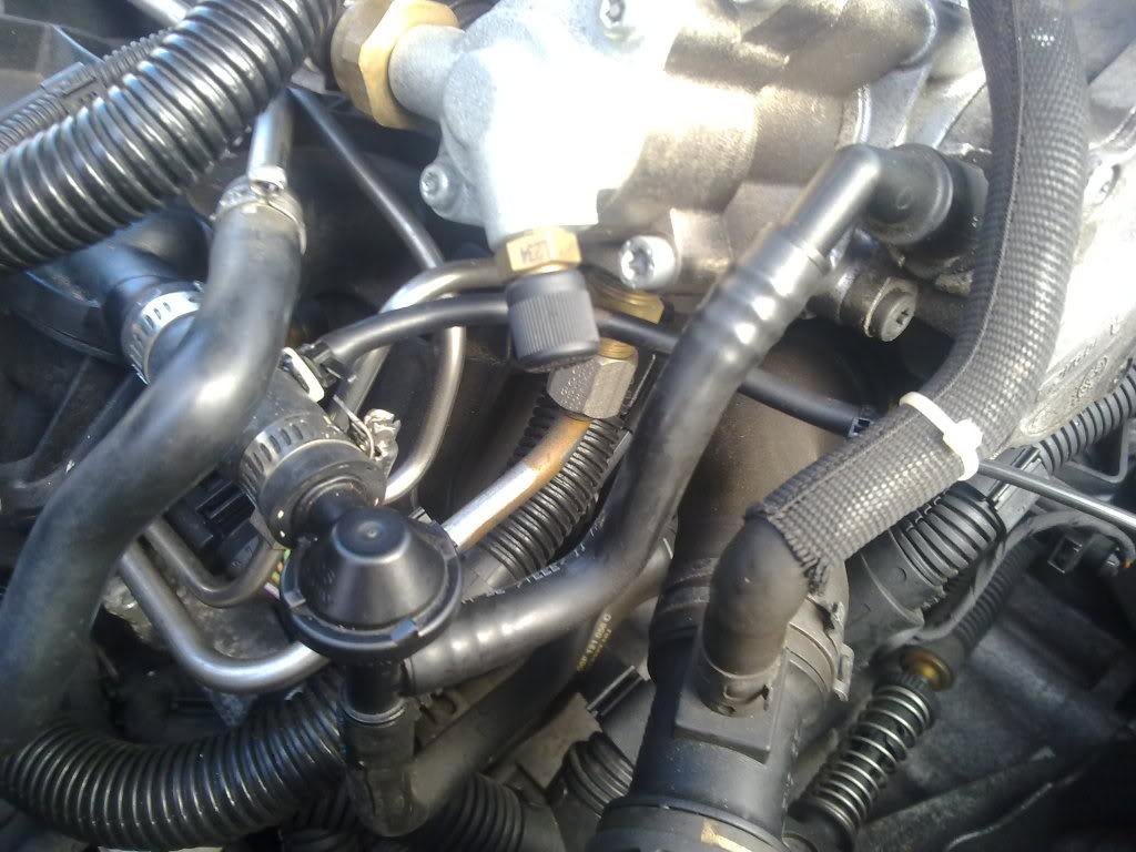

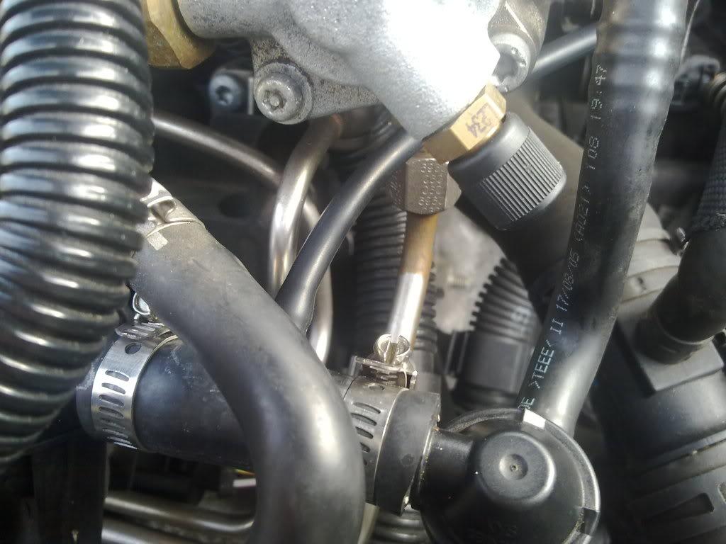

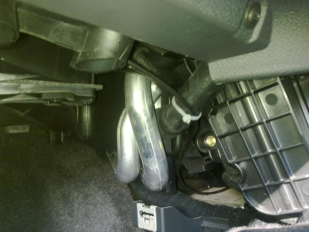

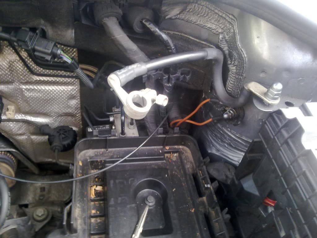

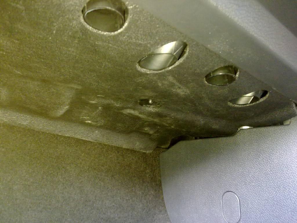

« Reply #4 on: November 01, 2011, 10:16:55 pm »
mine
then i ran it into the cabin behind the battery, then under the dash all tidied away
earthed
Offline Dan648v
  • -Given: 28
  • Posts: 795
Re: Vacuum tap for boost gauge??
« Reply #5 on: November 01, 2011, 10:19:57 pm »
Now thats perfect mate!! A pic speaks a thousand words!
Thanks for the help lads!!  :happy2:
