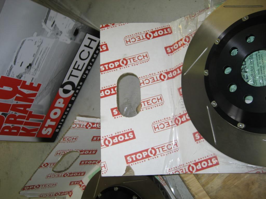

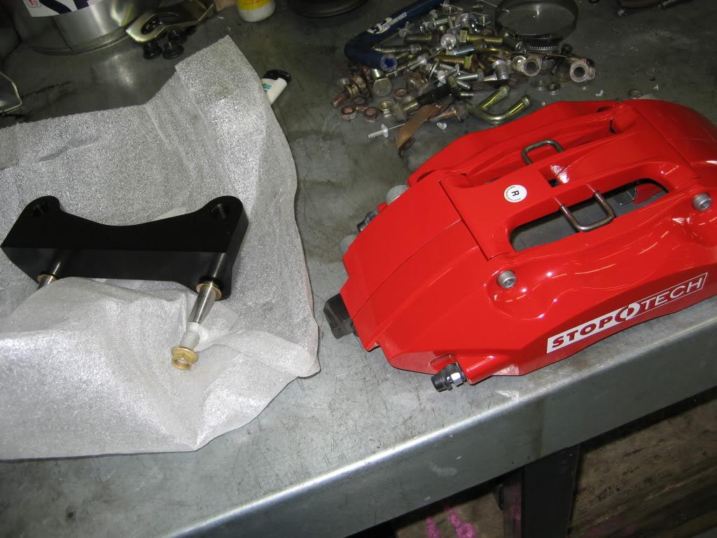

The kit (part number : 83.893.4300.71) comprised of:
  • 2 x Stoptech ST-40 Fully forged aluminium calipers - in RED (DOT and TÜV approved) (only 3.6KG each)
  • 2 x Stoptech stainless steel brake lines (DOT  and TÜV approved)
  • 2 x Stoptech Billet aluminium hats (DOT  and TÜV approved)
  • 2 x Stoptech billet aluminium brackets – T(DOT  and TÜV approved)

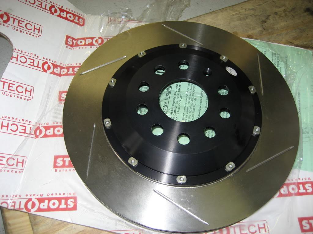

  • 2 x Stoptech AeroRotor Disks in 228 x28 size – non-zinc coated, slotted (DOT and TÜV approved.
The caliper uses a standard FMSI D372 Porsche pad – So, I could have chosen from Pagid, Ferrodo, Hawk etc.. but because this is a road car, I chose the Axxis ULT Carbon/Kevlar pad – it’s got great initial bite and is pretty disk friendly.

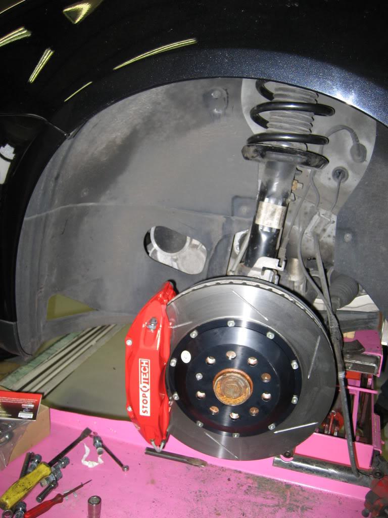

DBM fitted the kit. Fairly straightforward.
The calipers I chose don’t have pad wear, so the pad wear sensor had to be looped, but that was the only modification. They do sell a kit that allows that feature to be enabled on the ST-40 caliper.
The kit is a straight bolt on. The dust/moisture shields at the back do not have to be removed, just bent slightly back.

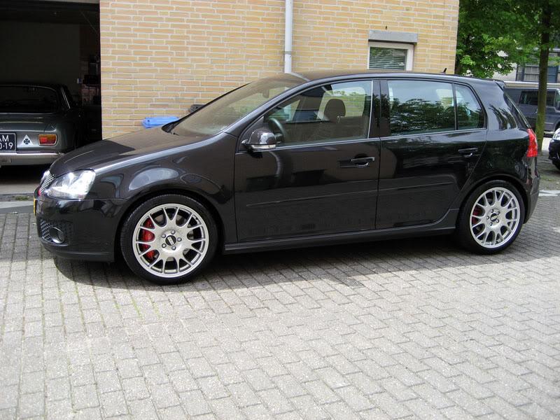

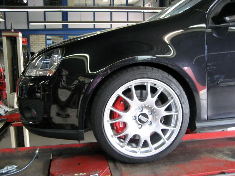

Now, the obvious thing... the caliper is pretty large (of course this is the point, because pad area and contact patch on the disk and then the disk’s ability to deal with the heat is what makes good feeling reliable brakes) and its width means that it doesn’t fit behind the standard wheels of our cars.
Having done some research and measurement, you need a wheel that has the following dimensions to clear it (just), 18x8 5x112 ET44 – such as the dimensions of the BBS CK wheel.
Or you can add spacers.
On an ET50 or ET51 18x8 wheel, you need 5mm  at the minimum.
Diameter of the wheel is less critical, this kit would fit behind a 17” wheel, but the face of the inside of the wheel and its offset from the hub are crucial measurements.
