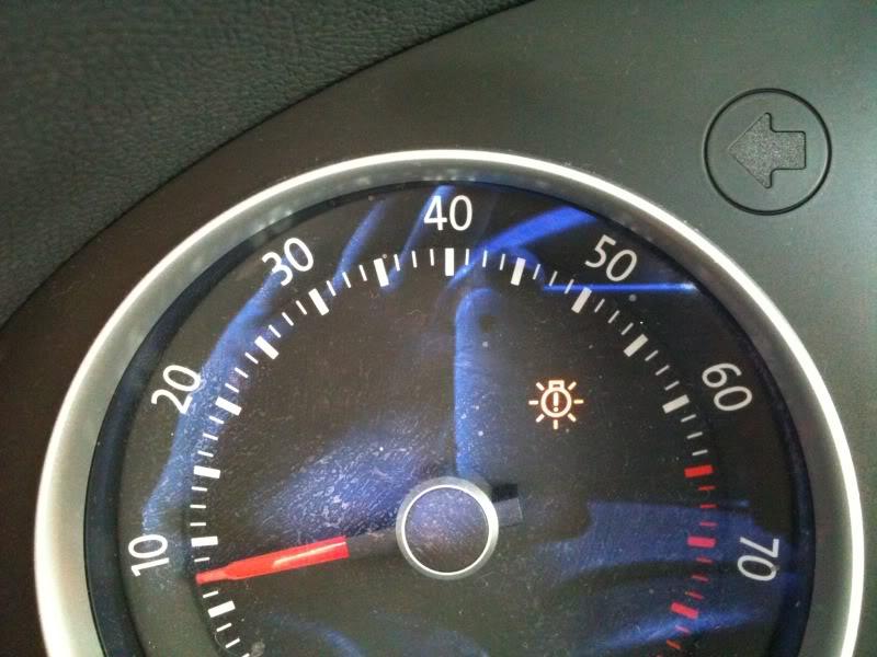

Hey all, can anyone tell me what this means? ive lost my manual.....
thanks in advance, hopefully nothing to serious...

It means you have a light out somewhere

Thats a bulb warning light. You either have a bulb thats blown or a resistor has blown. check your number plate bulbs / footwells / sidelights.
Sometimes the message pops up and tells you which bulb it is.

When you turn car on usually tells you what light is defective.
