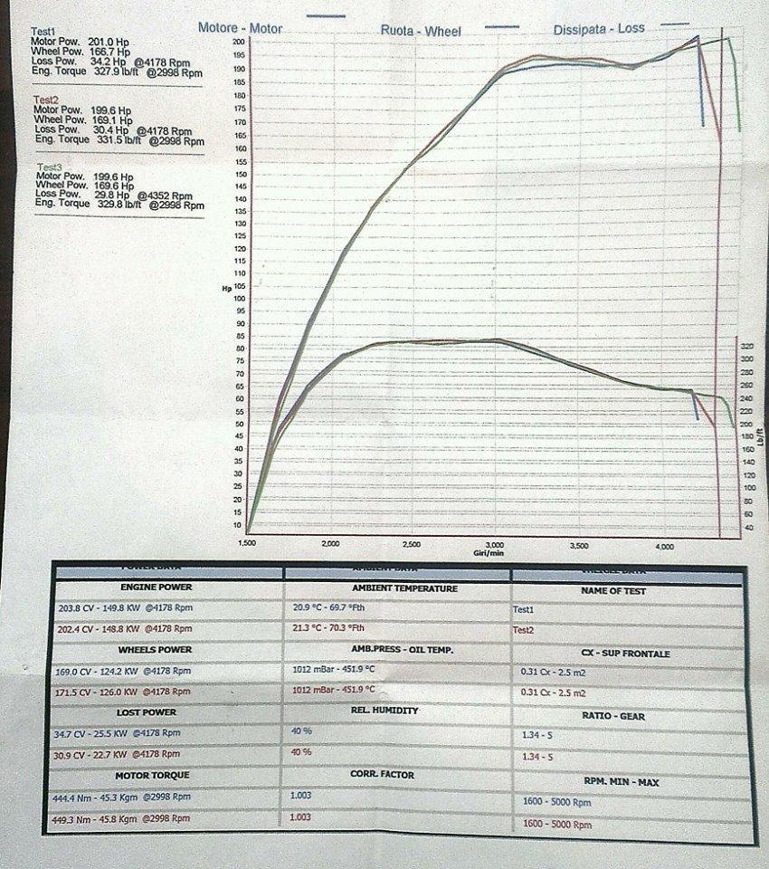

So today I attended a local charity rolling road event. Here is the print out:
I little bit lower than when it was last done but the rolling road is said to be a truthful one so I'm not too fussed. I also believe there is some room for improvement after speak with a couple of people.
Watch this space.

Hey, its still a 200bhp diesel Golf.
I would be very proud of it.......Love your motor!
Matt
good results Matt..would worry on the figures of the rolling road- long as it drives ok that's the main thing

There is that yes BUT with the amount of smoke it chucks out it should be running more. Mapped correctly a smokeless 200bhp is achievable. Mine is over fuelling a fair bit so I believe there are some adjustments needed which will reduce smoke but also give better power and torque.
As you can see between 3500 and 3750 rpm the power drops off for some reason then rises again. Something else that can be smoothed out.

good run matey,  that's with a temp of 20oC odd  of warm air blowing, get it on a cooler day to you see the difference  :wink:
