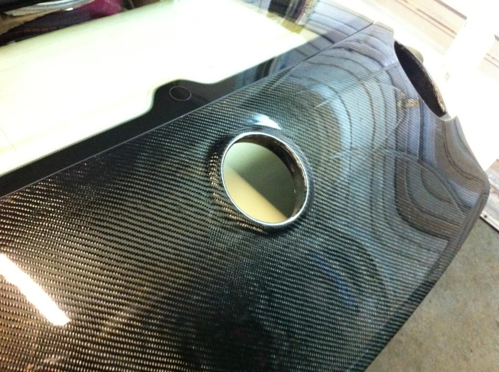

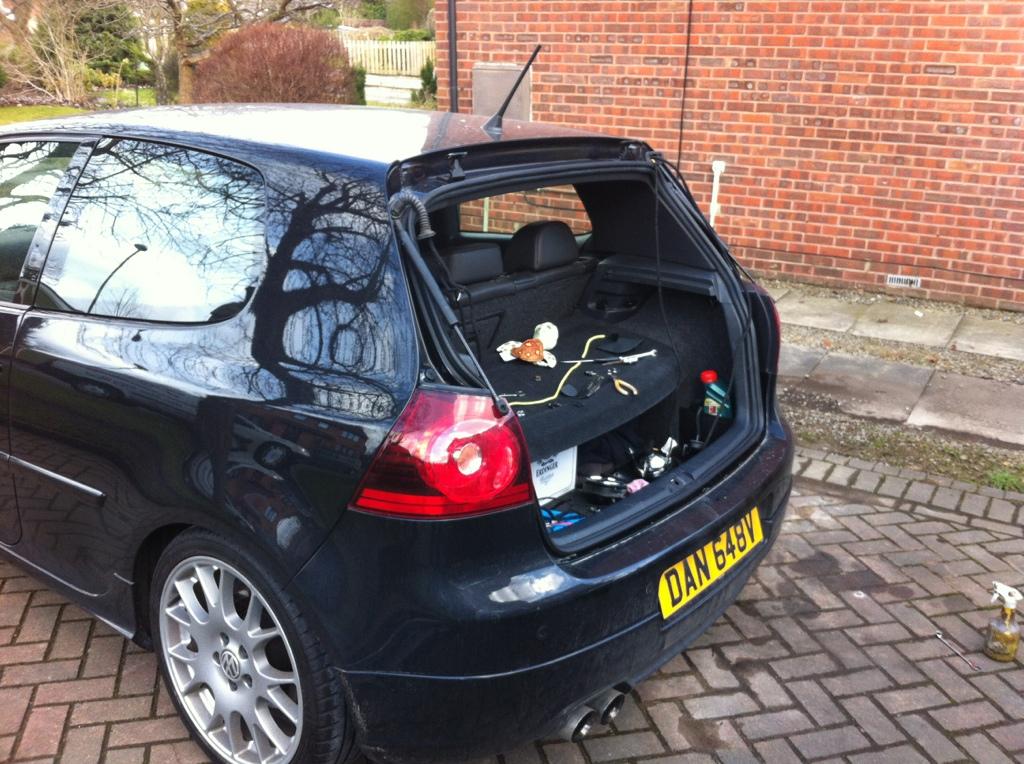

I managed to find a few spare hours on mothers day so dragged my dad outside and got a hand fitting my Seibon Carbon boot!
Where to start?! got all the boot plastics off to be left with alot of loom and bolts! took the lights out and boot handle and stripped the loom back and fed it back out of the boot, popped the struts off and hinges and it was free!! and bloody hell was it heavy! i forgot to weigh it as it was freezing but it was a 2 man job carrying it!
We reversed all the jobs and the Seibon unit was on!
Few things to note:
-the boot lock needs nuts and bolts as there are no captive threads in the Seibon boot
-the holes for the boot badge dont line up (2 of 3 did) and some material needs filing away to let it fit on the inside (no damage to the carbon)
-its now very light so be careful letting it open as it will now smack you in the chin!!! :wink:
Apart from that alls good!! No pics of fitment but will get some when the weather allows (you'll see the problem im having below!) Weight wise the Seibon unit must easily be less than half the weight of the standard unit, the difference was crazy!
I now am sourcing a new GTI spoiler to fit to it and a top brakelight to fill the hole. Pictures below, enjoy  :happy2:
When the suns out ill give her a clean and youll see how the weave pops in the sun just like the front wings!!
