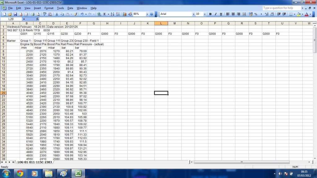

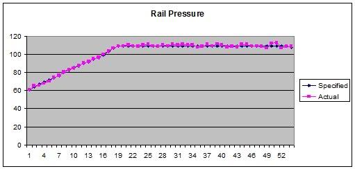

Do this look right??
i thought the boost seemed low for standard but then its meeting requested and so is rail pressure
the car just felt very sluggish
it has the newer dv, bsh pcv fix, evoms intake and full milltek
cheers

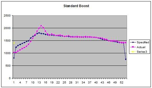

this is my mates standard gti k03 logs
seems like his is boosting more than yours, he might have a faulty DV also.

Re: Standard Logs
Reply #2 on:
March 07, 2012, 09:54:02 am »
yeah just doesnt seem to be boosting right sure previously it was boosting to about 15psi on my gauge in 5/6th now its maxing out at about 9
i have some previous standard logs, just trying to find them

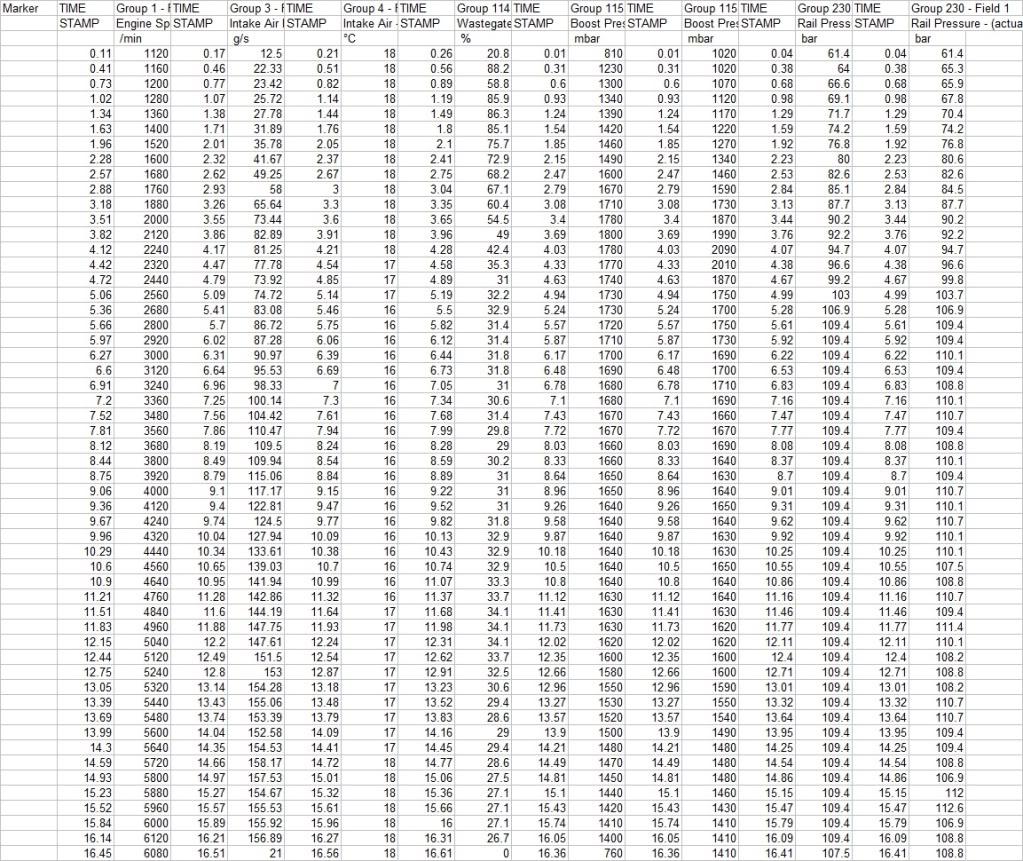

It could be me but your wastegate duty cycle seems unusually low compared to what I've logged in the past.
I assume you were at WOT when you did that log?

Re: Standard Logs
Reply #5 on:
March 07, 2012, 03:33:43 pm »
yeah wide open throttle

Re: Standard Logs
Reply #6 on:
March 07, 2012, 03:43:45 pm »
If possible try logging Throttle Plate Angle (block 054-4) and Accelerator Pedal Position (block 054-3) to double check your wot is really wot.
