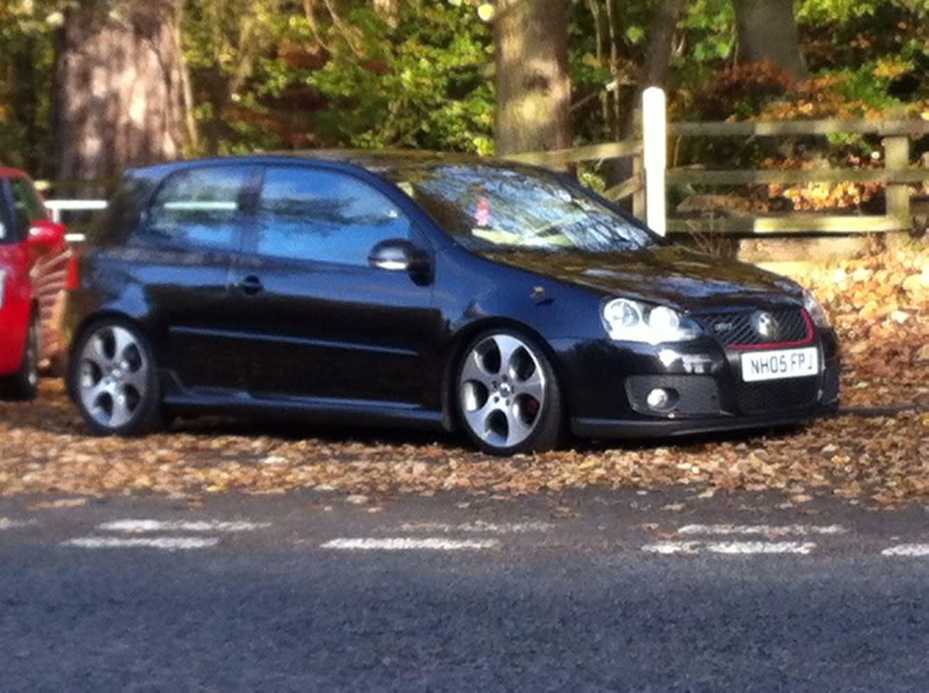

I was lowered this much on coilies and didnt have any troubles with rubbing after arch screw mod. 225 tyres all round. Ap coilies wound fully down on rear and two threads off of fully down on front
Re: lowering my mk5
« Reply #11 on: March 06, 2012, 07:53:02 pm »
Great Pic  :congrats:

Offline mato
  • Posts: 37
Re: lowering my mk5
« Reply #13 on: March 07, 2012, 07:16:20 pm »
cheers for the reply boys how much s the red gti lowered on the coilovers? :happy2: nice pic
