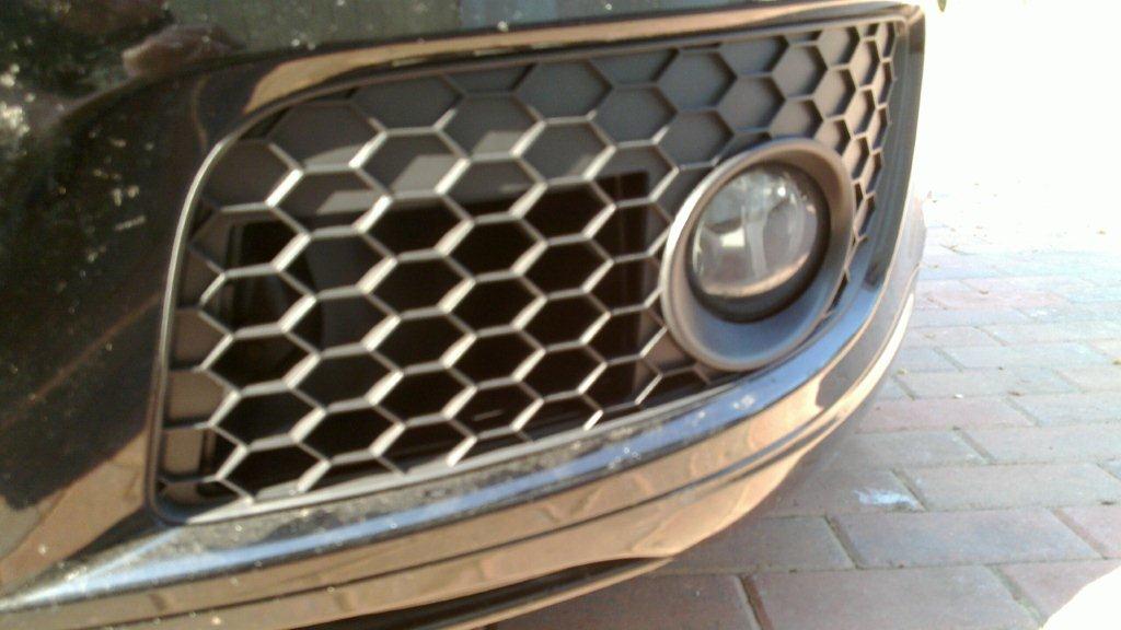

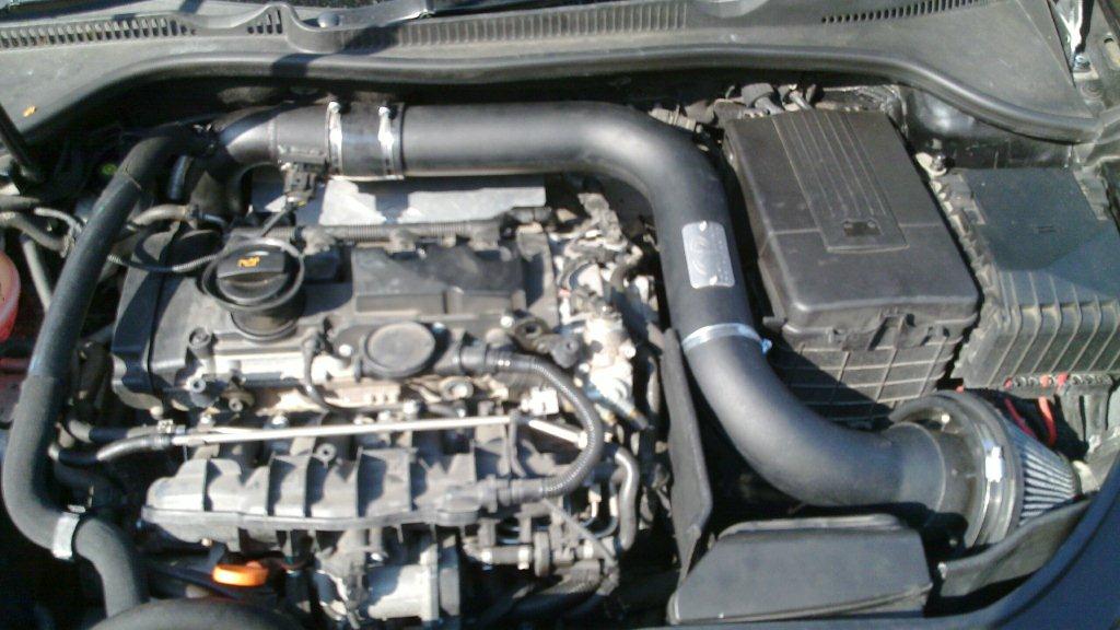

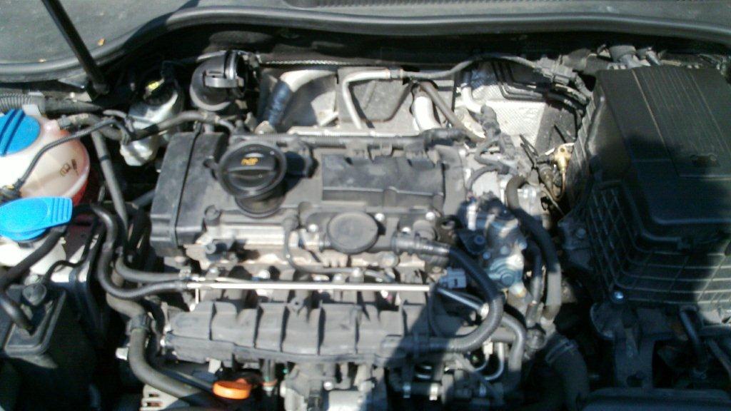

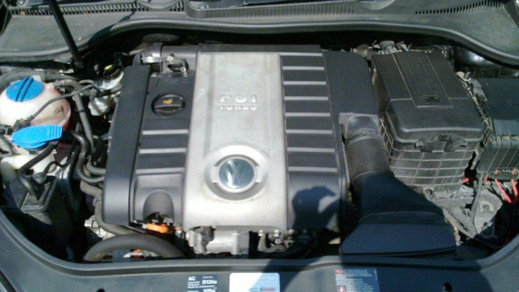

The first thing i done was to install a genuine golf mk5 bra
Then install Evoms intake/ heat shield & Open air intakes
I must say i was very impressed with the sound and performance increase mid-range.!

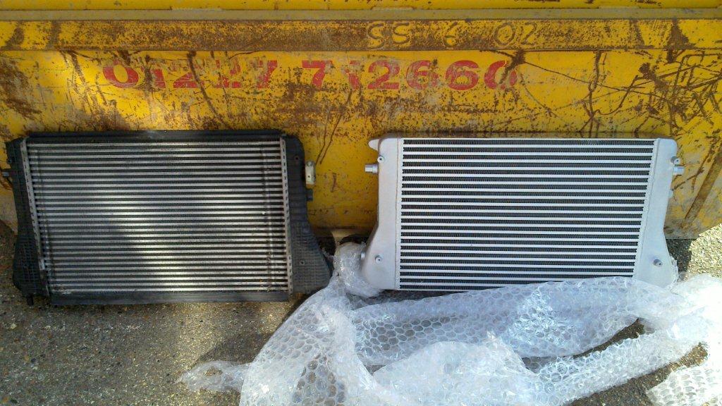

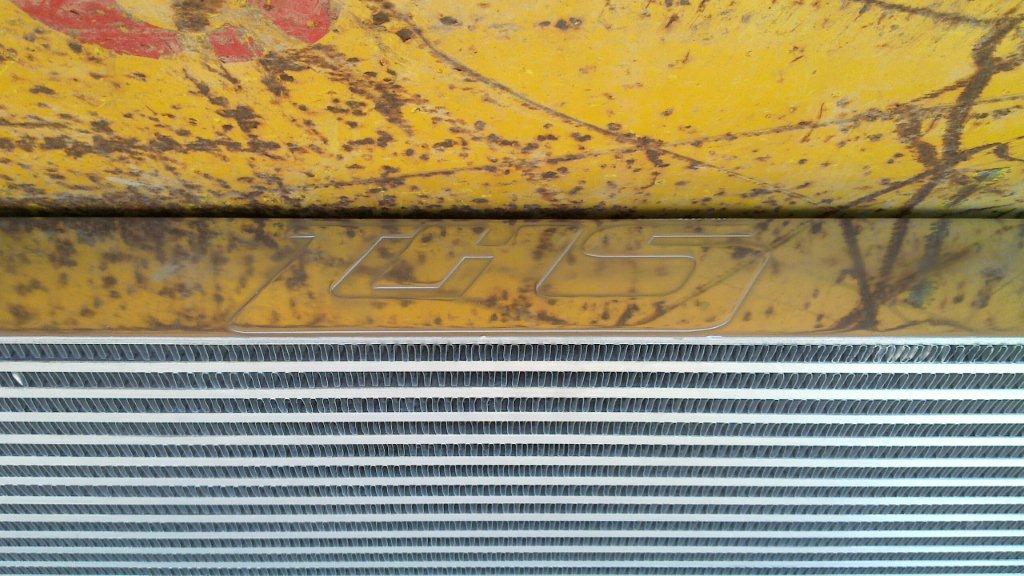

Then i went about spending 4hs of my life installing the IC

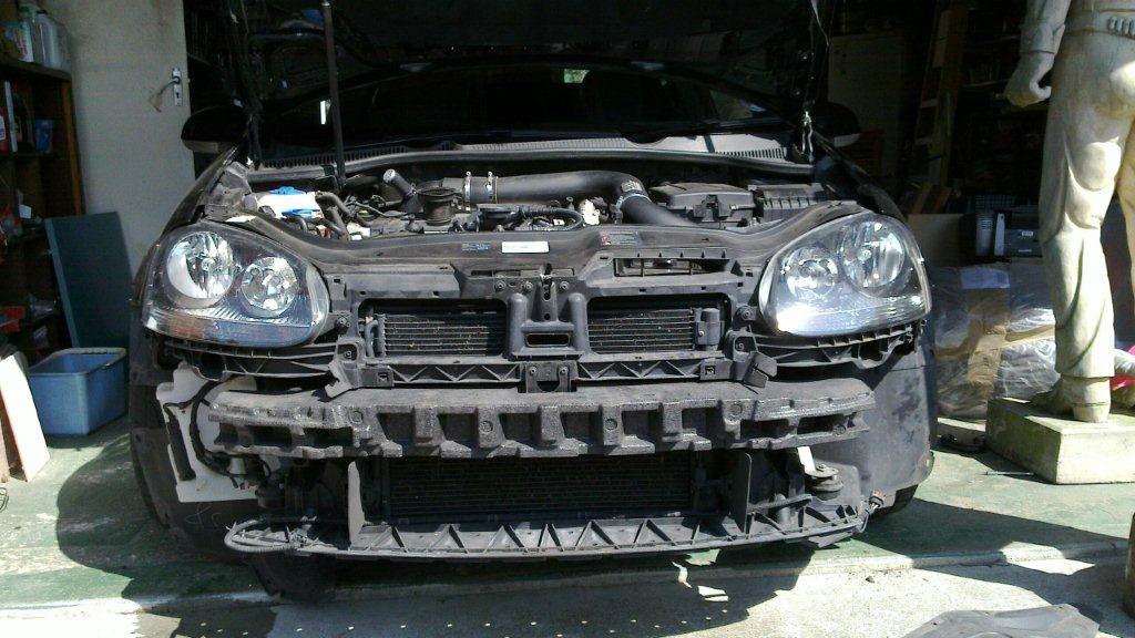

The day begun by me stripping a few bits off the car and also removing the bumper,

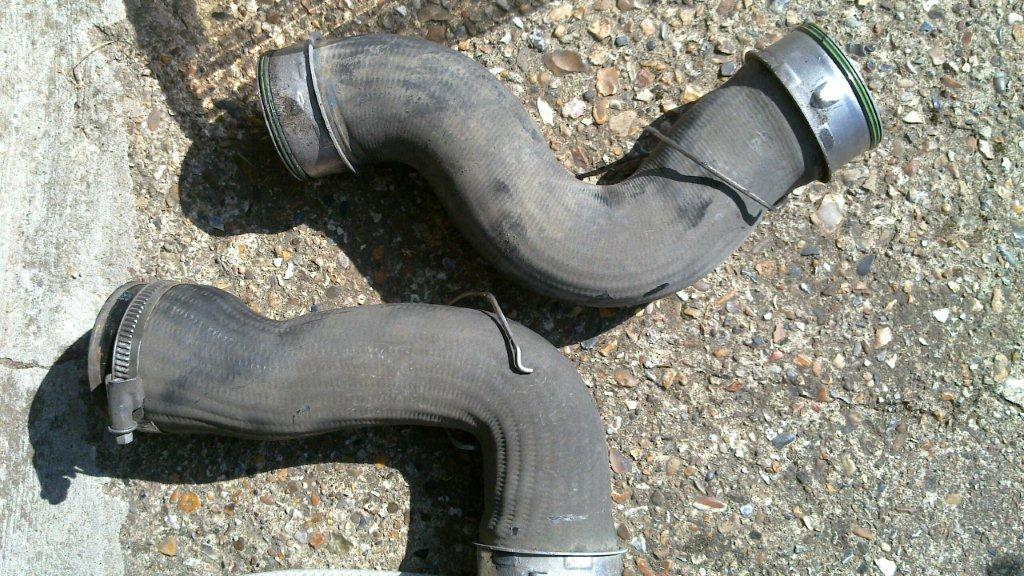

I then removed all the IC pipes and found myself a nice little boost leak, the stupid C clip had slipped off

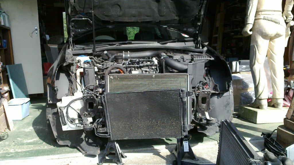

Once all the pipes were removed, i had to remove the front panel!  This part was rather interesting. I had to balance all the rads with one hand while pulling away the front end!  Job done after a few magic tricks.
I supported the rads with some axel stands and went about removing the standard IC from the rad pack
new v old
Then i installed the new IC in place
Then put all the back together!!   Witch was the easy part
You really could tell the difference once you started to do lots of sprints... the recovery time was fantastic

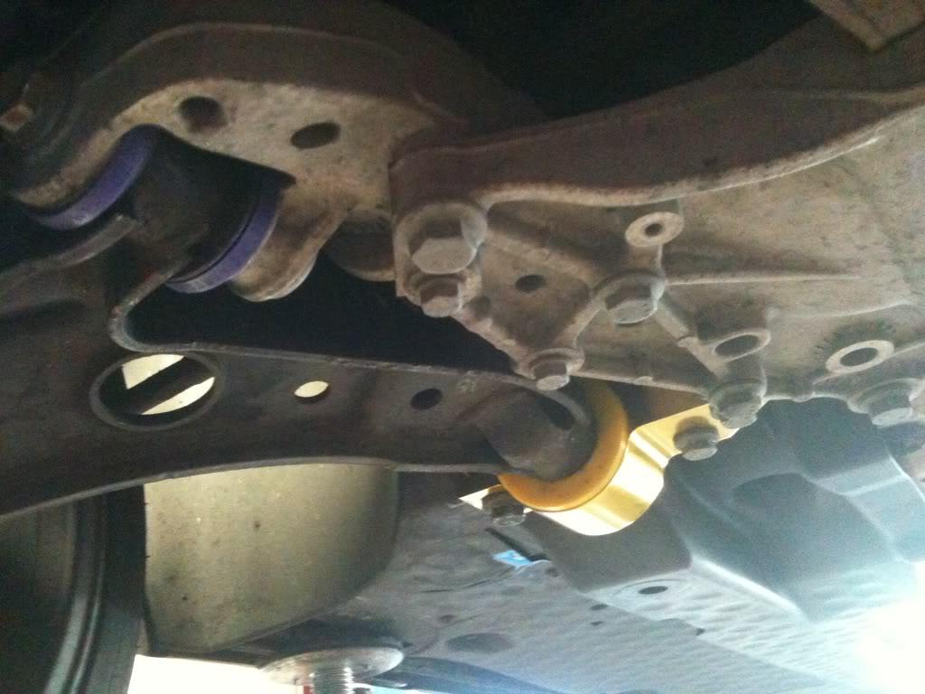

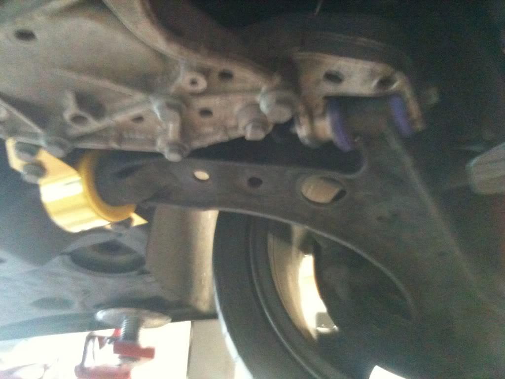

On the same day i installed the Walk anti lift kit (very easy job)

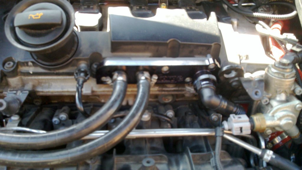

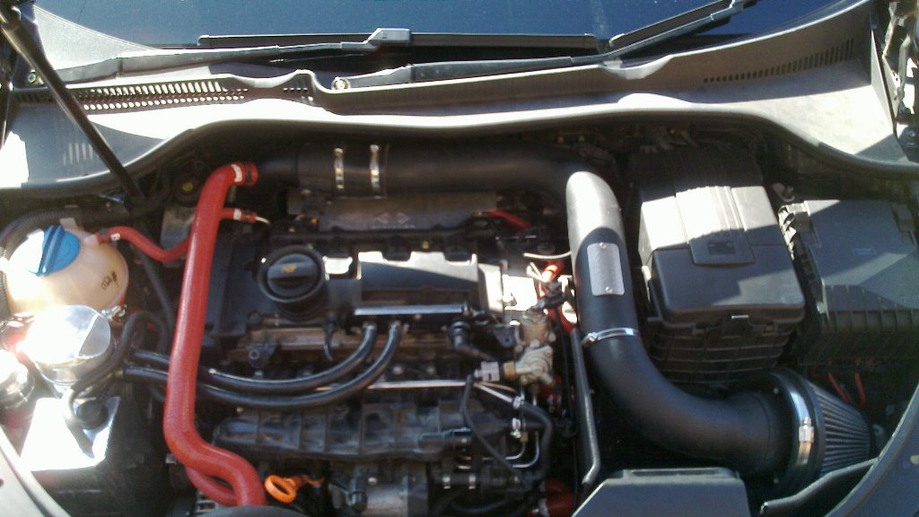

The next thing i done was installed the K04, S3 injectors.
With
Neuspeed K04 discharge pipe
Neuspeed Hiflow IC pipe
Forge Throttle body hose
Forge coolant hoses
Forge DV hose

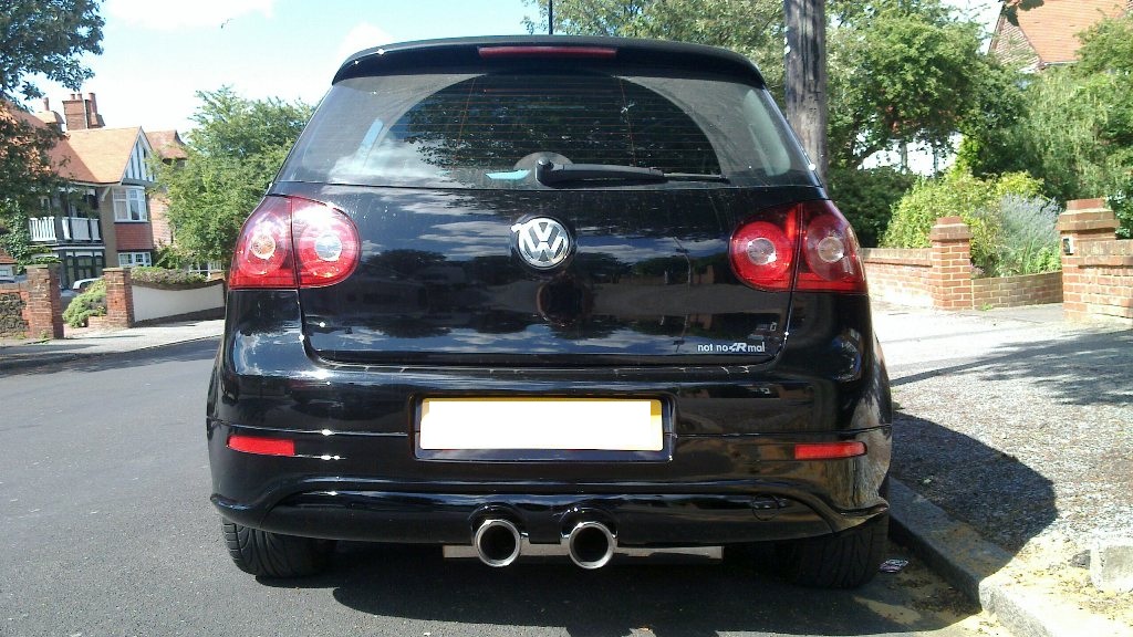

Full milltek system
Neuspeed front n back anti roll bars
APR HPFP
THS engine mounts
I cant find any pics of me installing them.... :(  think they are on another pc somewhere

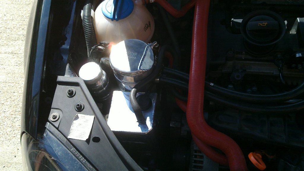

I then installed the forge catch can, carbon filter covers

I then dragged the car to nick at r-tech for a custom remap!
This was nicks information
A bit of a task this Mk5 GTi with S3 turbo/injectors and HPFP.
The hard part was getting the fuel constant via the air flow correct so the fuel trims are within reason,and the injectors not dumping fuel as the turbo is spooling.  Step1 re-scale injectors on a stock map and set the rail pressure maps to work with the HPFP, this took around days of trial and error testing and logging.  Next step was to tame the boost and make sure I had full control, the first thing I noticed with running the k04 on the k03 mapping was that under load at higher rpms the boost would creep off the scale, I would ask for around 2250mb, the ecu would ask for the correct load and boost but becuase of the k03 n75 mapping being on a lower scale the n75 realted maps would allow too much duty cycle.  So it was another 2 days getting the boost correct and with in maps sensor range and having the n75 act for the k04,  it got the the point that the actual boost was running 200mb below the requested line... at this point I had safe control so time to wind the n75 up in increments to give a little spool up over boost which just clipped the 2580mb map sensor and fall back to the requested boost 2400-2300mb. Next task was timing nice and easy to get a base point as the S3 timing maps and scales fitted in place nice..   now just a matter of keep adding the timing in until the ecu started to pull back on the correction of the car stopped making any more power.
I have really enjoyed doing this job as I was taking a lot on doing it, but knew with enough time I could get it bang on. I had no aim of chasing peak numbers, just a car that pulled and pulled like a bitach to the red line.
The final result was 335bhp 310lbft @270.25gs..... £80 woth of fuel used on the dyno and road.

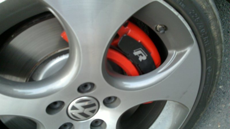

I then installed the r32 Brake setup
I thought they where fantasic but needed somthing more as they would heat up to fast (track) :fighting:

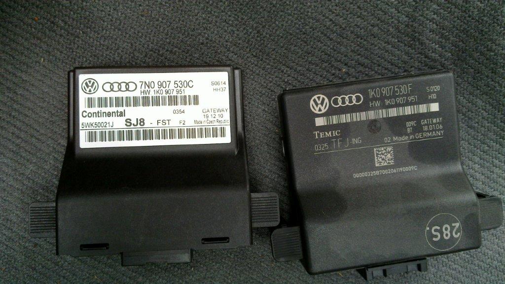

Installed Canbus update and rcd510 DAB  ( What an arse!)
Installing this was harder than fitting the turbo!! i smashed my head and hands up for this!
I did not have a DAB connection so used the FM worked fine.
Recoded with vagcom
I then installed installed Highline clocks and created a read me for everyone
How to, Midline to highline retrofit
http://www.mk5golfgti.co.uk/forum/index.php/topic,33055.0.html
add more in a sec

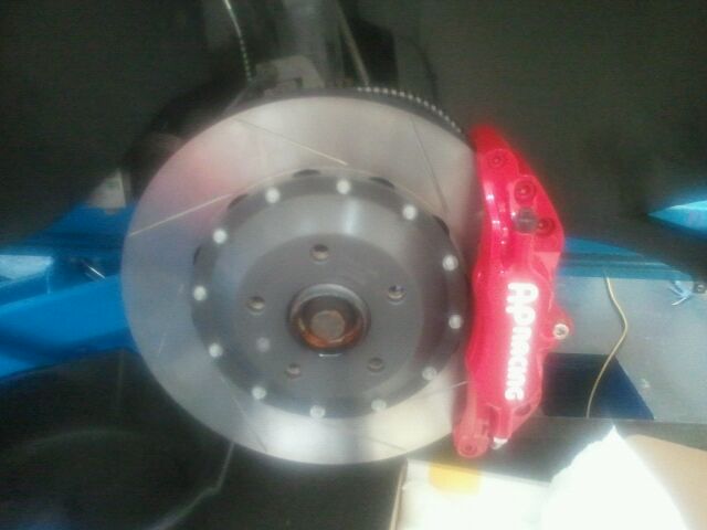

I then needed to upgrade my brakes again  :party:
AP Formula Big Brake Kit
These brakes are fantastic!
