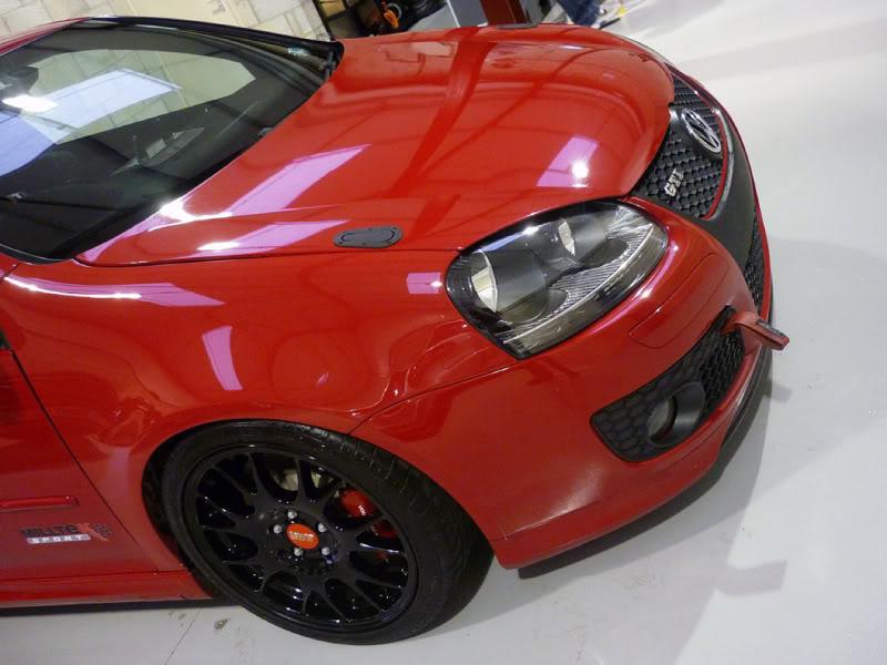

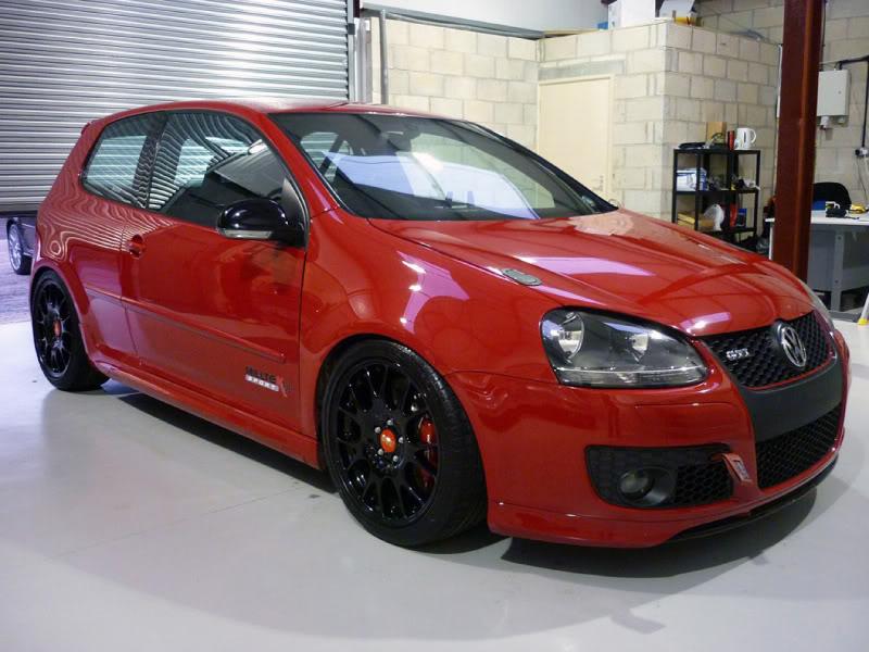

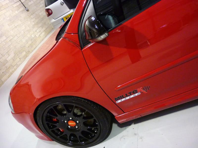

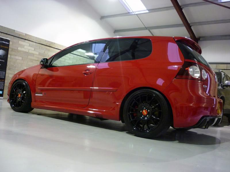

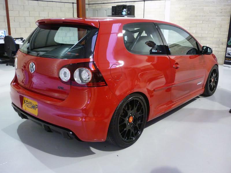

Hello Again Chaps,
Well I'm sure you are all familiar with this particular MK5!  :wink: As Steve was off to the Nurburgring for a thorough test of the new hardware and software on his car, he asked his most favourite detailer to give his car a spruce up ready for the trip!!  :jumpmove:
Due to time restrictions (yes Steve was late!  :laugh: ) there are no before pics I'm afraid, but I'm sure you can all have a wild guess at how she looked!!  :wink:
It was agreed that a light enhancement would be carried out, including a light interior detail.
- Wheels cleaned using AS Smart Wheels, vikan/lambswool brushes, decontaminated with Tardis/Iron X
- Tyres/arches cleaned using AS G101, vikan brushes
- Citrus pre-wash via foam lance, to remove loose debris/dirt, high pressure rinse
- Bodywork, door shuts etc washed using Auto Finesse Lather, 2BM and lambswool mitts
-Paintwork decontaminated with AS Tardis, contamination remove using Iron X

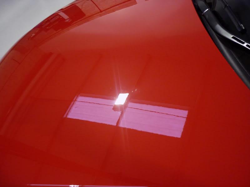

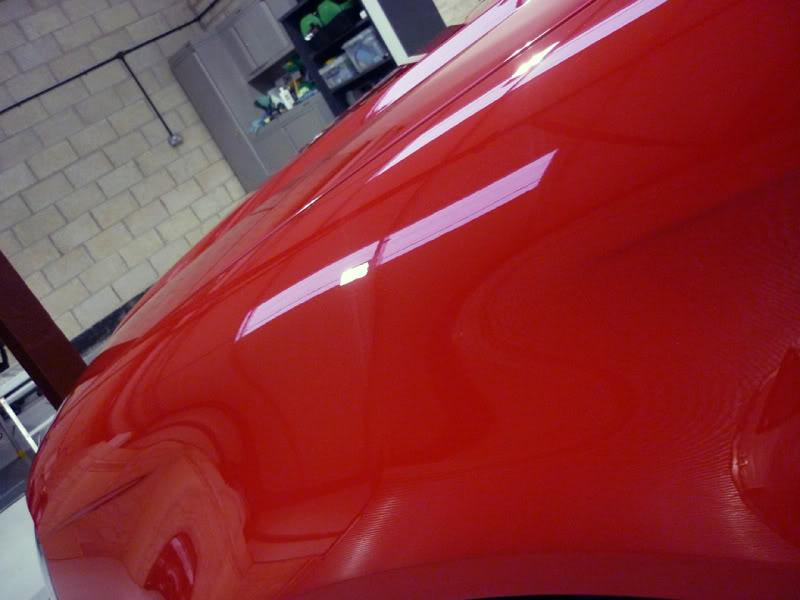

- Paintwork Cleansed with Lime Prime via DA, removing light swirl marks/haze, preparing paint ready for wax. Several areas had bad hazing, these areas were given a few passes with a microfibre pad to give a little more bite.
- Dodo Juice Purple Haze applied to paintwork

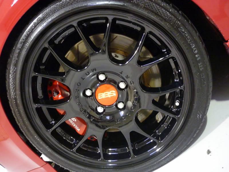

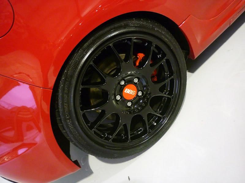

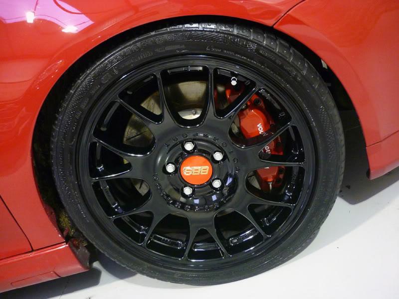

- Wheels lightly polished by hand, sealed using Mint Rims
- Tyres, plastics and rubbers dressed with Car Pro Perl, glass cleaned, exhaust/chrome polished
- Light interior detail, include mats/carpets clean, fabrics, plastics etc, glass cleaned

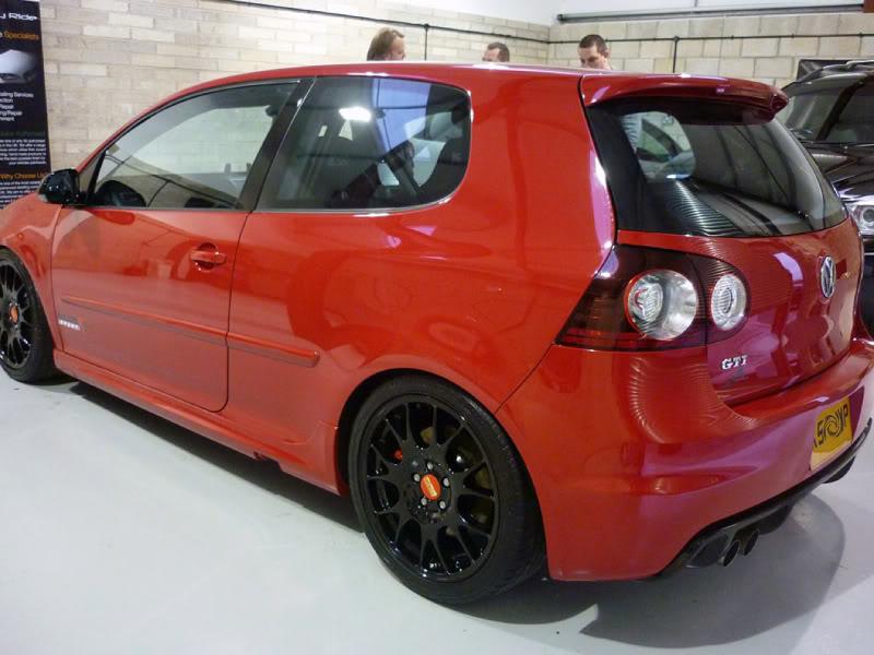

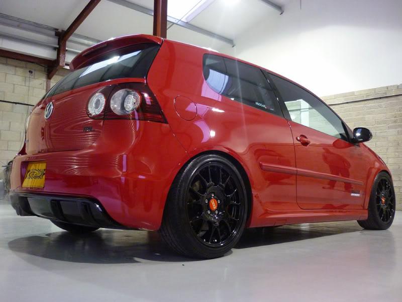

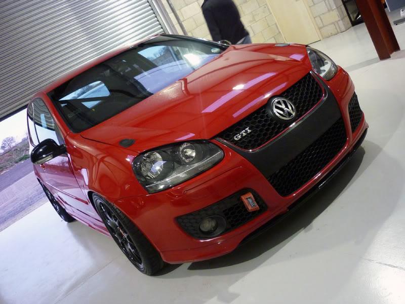

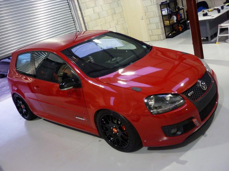

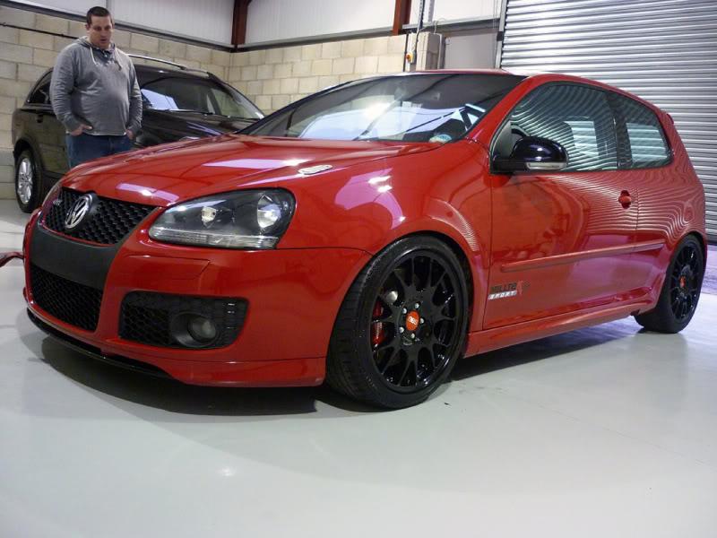

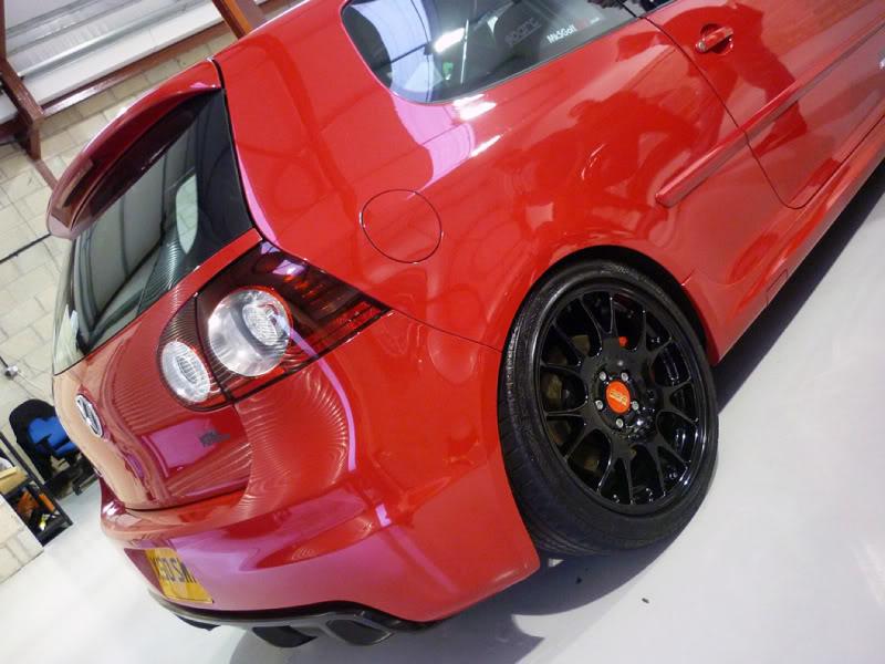

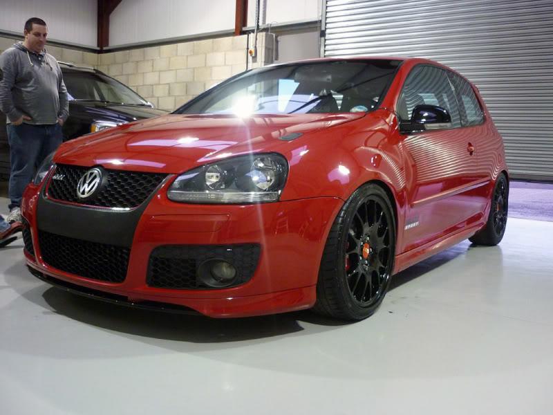

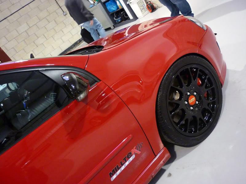

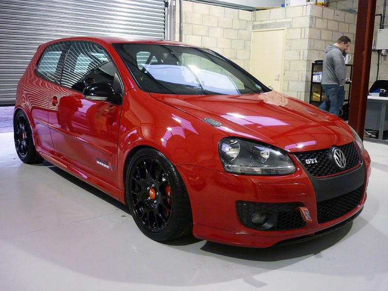

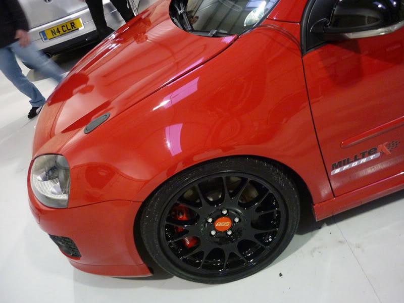

About 8 hours worth of work ended up with this:  :evilgrin:
I think we all agreed she had never looked so fresh, but we also agreed there was more room for improvement at a later date!
Thanks for reading!  :happy2:
Nathan & Gaz

Looks real good. Tornado Red done proper is very good.  :notworthy:
Re: DMR Ring Prep - Boss Man's Red Missile!!
« Reply #3 on: March 22, 2012, 10:31:14 pm »
The skylights really help bring out the shine in the paintwork, so I'm puzzled as to why the Boss looks so glum in the pics!
Sorry Steve, I know you love the green and purple rims but the car looks awesome with black rims.
« Reply #4 on: March 22, 2012, 10:35:16 pm »
looks perfect with the black rims

what bumper is that? looks  :evilgrin:

very tidy :-) but whats with the pink lighting in the reflections Nath?
« Last Edit: March 27, 2012, 08:06:05 pm by Saintsteve »
« Reply #10 on: March 27, 2012, 09:58:49 pm »
thats just what tends to happen on a red car when light late afternoon/evening light comes thru a roof light an reflects off it??
« Reply #11 on: March 27, 2012, 10:06:49 pm »
It is 'Tornado Pink' Steve what do you expect!  :pomppomp:
As Jay said, it looks as though it's the lighting from the skylights in the Roof!  :happy2:
