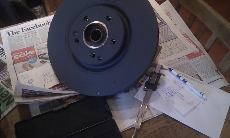

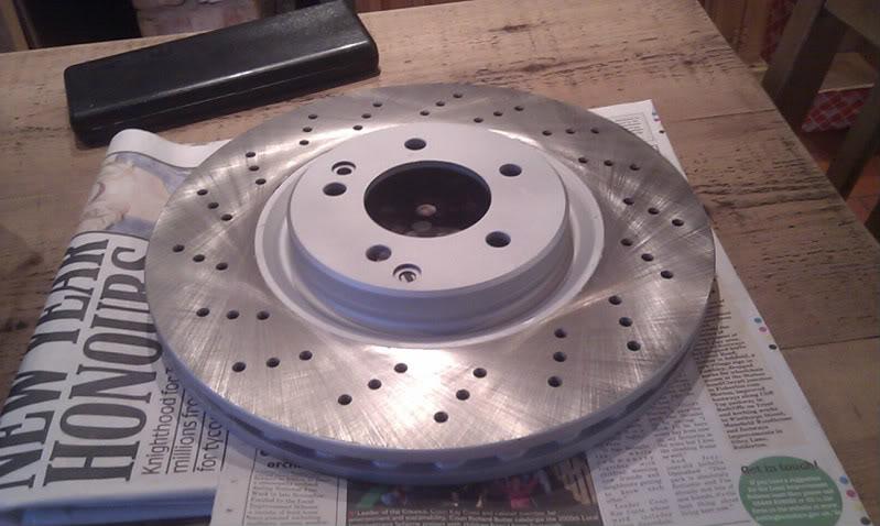

Also been measuring up for adaptor brackets - disc here is in the zinc primer stage!
And one finished disc after a coat of VHT aluminium and a bake in the oven at 200deg C!

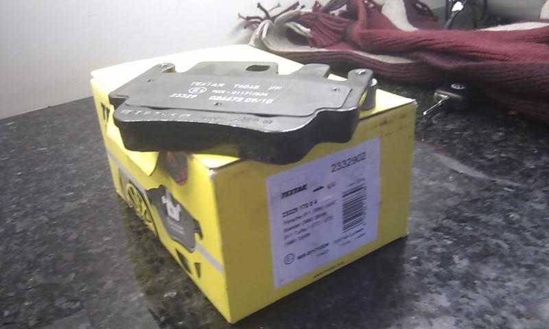

if you bought cayenne rear pads then you'll be able to find a suitable wear sensor from a tourag, the rear pads from a 4x4 might not perform as well as dedicated Porsche fronts....the weights on top of the pad make me think they're cayenne rears, 996 fronts don't have the weights and use pad dampeners which are the same as cayman s ones which are cheaper.

Cheers for the input again Dave. Pads are definitely 996/boxster s fronts. States on the box and they were sealed.

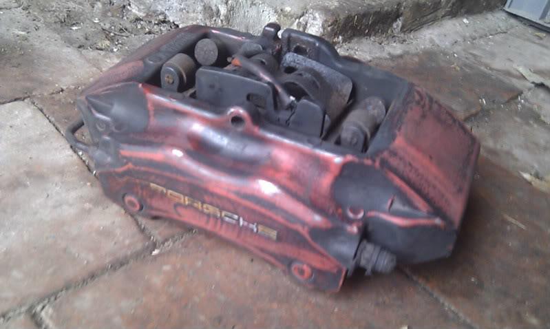

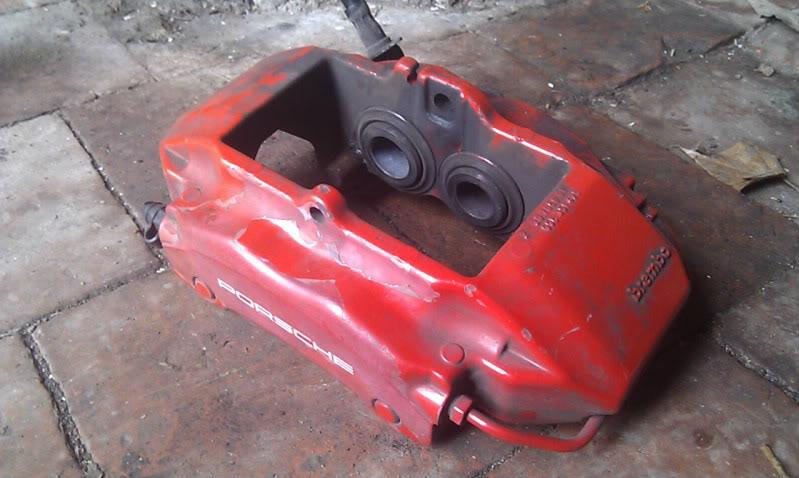

But I have some calipers.....ugly ass things they are too.
It gets worse!
Been a bit warm this one, melted the rubber around the bleed nips, and smoke stain galore.... :surprised:
Luckily though - on removing the pistons there is no damage to the seals at all - all is well. I just damaged one dust seal removing them tho. All pistons moved freely which is nice.

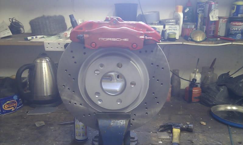

I offered up a caliper just to keep my enthusiasm going!
Discs now drilled to clear M14 lugs, and for the disc retaining screw - although the latter took me a few attempts to line up... :ashamed:!
Dropping it all off at the machine shop tomorrow hopefully if my carrier and caliper bolts come from TPS. See if they cant knock something up without a drawing....I havent had time yet to CAD it up.

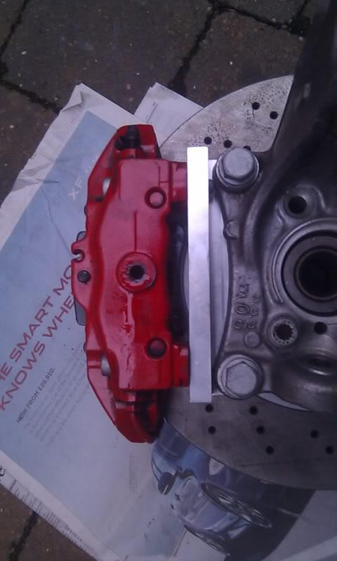

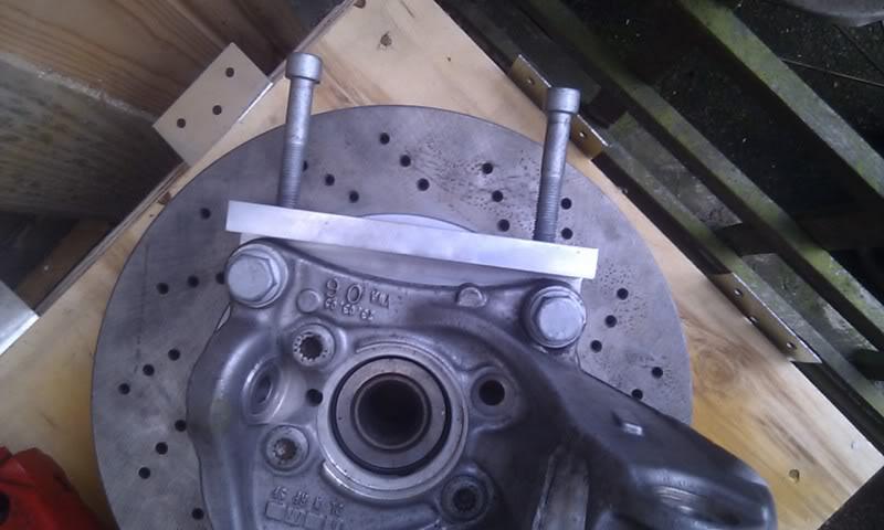

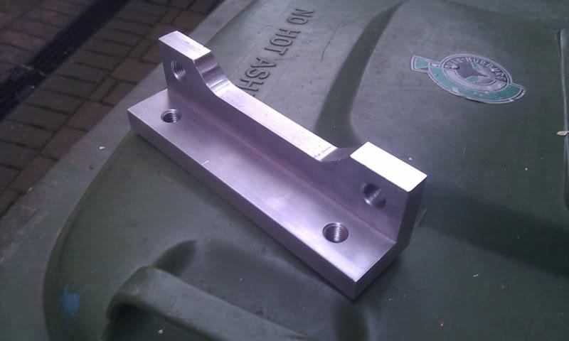

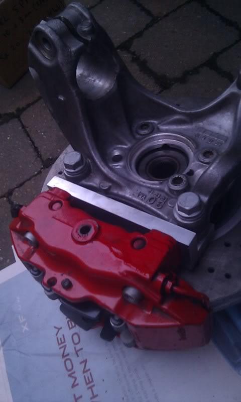

Carrier is mocked up and seems pretty good - but it just needs to pull the caliper in about 3 or 4mm more as the pad is just overhanging a tadge. It was one thing I said to the machine shop that was critical but hey ho, they didnt charge me much at all.
You can see we did them mounting from the front so atleast you can get to the bolts with the disc on...not sure it this means they will fit the GTI hub aswell as the ally hubs...cant remember what Ive read about this!!
Had a play with a wheel and it looks like 12mm is the wheel spacer requirement....hopefully as that is what I have just ordered! My only concern is if 12mm spacer will work with the TT arms. May be too much.

Ok couple of comments if that is helicoiled Ali and I think I'm right in saying you need to take 3-4mm off the top surface then either use m12 x1.25 helicoils and bolts or convert to steel

I am having the calipers machined down instead of the carriers - I didnt think there was enough meat left either!
