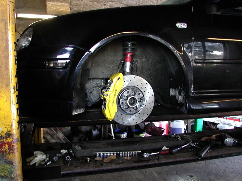

Yeah ATS DTC. I believe...one.of the lightest around.
The brakes on same tt....Cayenne 6 pots over the oe rs 370s?
Probably GT3RS calipers over RS4 rotors with Phaeton bells.
996.351.431 & 432 if you fancy a pair of eBay! They're the same as the PCCB ones just red.....got ceramic piston tops too..
Very different from the cayenne caliper half the weight, radial mount HUGE pad
As fitted here to a Mk4 R32 by yours truly for a nutter that V6'd and 4mo'd and supercharged a 1.4S LHD Mk4!

Pedal feel with standard mk5 m/c?
Surprisingly good - best ones to get though are Carrera GT Rears - only ever had one set in my hand as you would imagine they dont come up on the bay very often piston sizes 28/32/36  :love:
