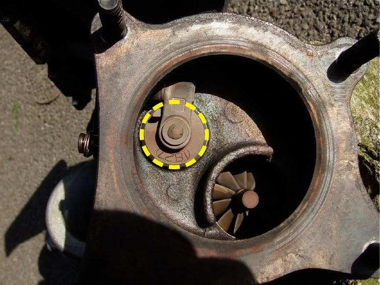

Thanks, Joe. I'll be posting a pic of the actual crack soon. [Er....I'm referring to the crack in the manifold and nothing camel related!]
Re: Troubleshooting a Boost Leak....
« Reply #18 on: December 23, 2008, 11:03:16 pm »
^ The crack can be seen as indicated by the arrow. This would be causing a minor leakage around the circular flap when closed.

A comment made from a turbo specialist I spoke to - he said he would be suprised a crack that small (and sealed on top) would cause much of a leak.
Robin,
were the turbine blades inside the turbo checked?  just wondering if there could have been some wear on these too which wont have helped.
« Reply #22 on: January 09, 2009, 08:09:15 pm »
....Well, it wasn't "much of a leak" but it was a leak nonetheless.
Robin,
....Yes they were checked AFAIK and found to be okay.
