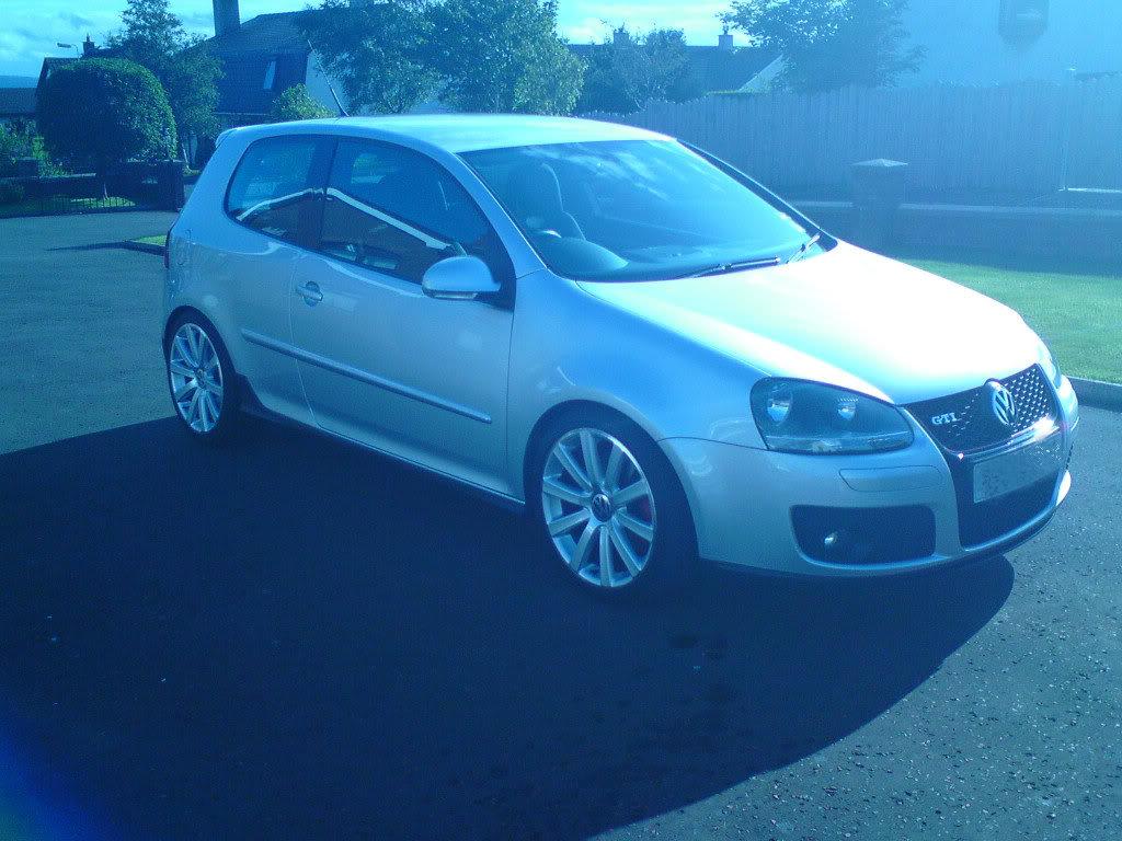

Been on the forum a while now & thought it was about time I added in my GTI...  :happy2:
It came with heated seats, headlight washers, heated windscreen washers & a few extra bits...

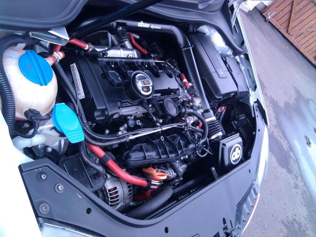

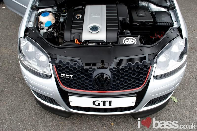

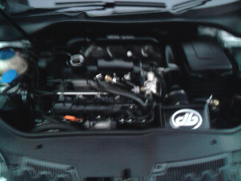

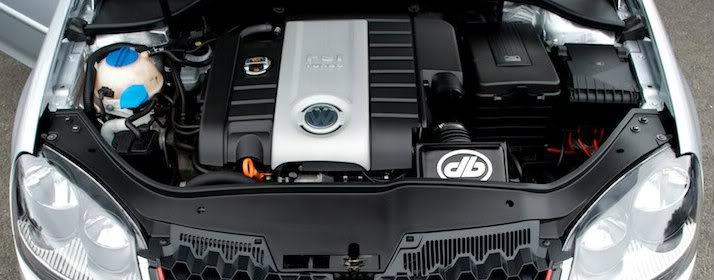

One of my 1st mods the CAI
with the R8 oil cap cover , all i ever did was clean it untill the slippery slope started  :jumping: :rolleye: :jumpmove:

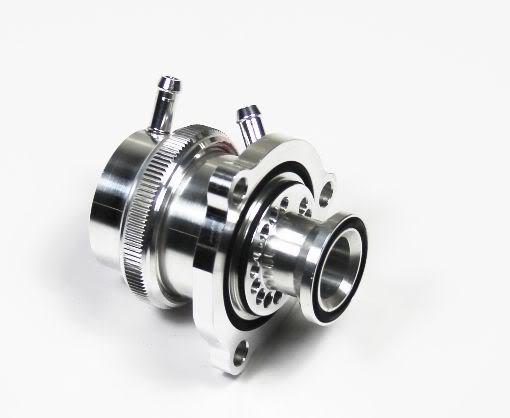

Added 1 of these... From forge
with #
From Newsouth
« Last Edit: July 02, 2012, 04:03:34 pm by scopes »

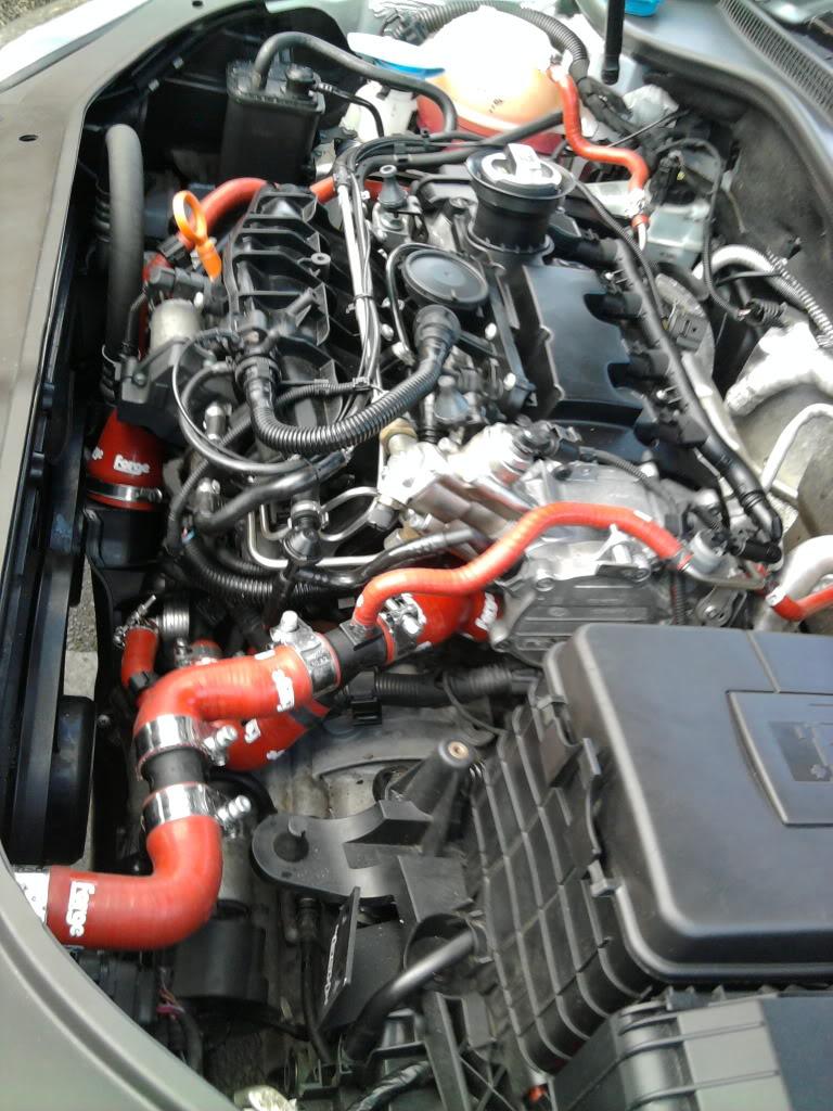

Added a BSH catchcan tried it for a few month's or so  :rolleye:
Sorry about the bad pics these where taken of my phone at the time  :ashamed:

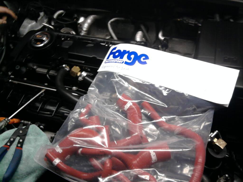

Some sexy red hose's  :evilgrin:

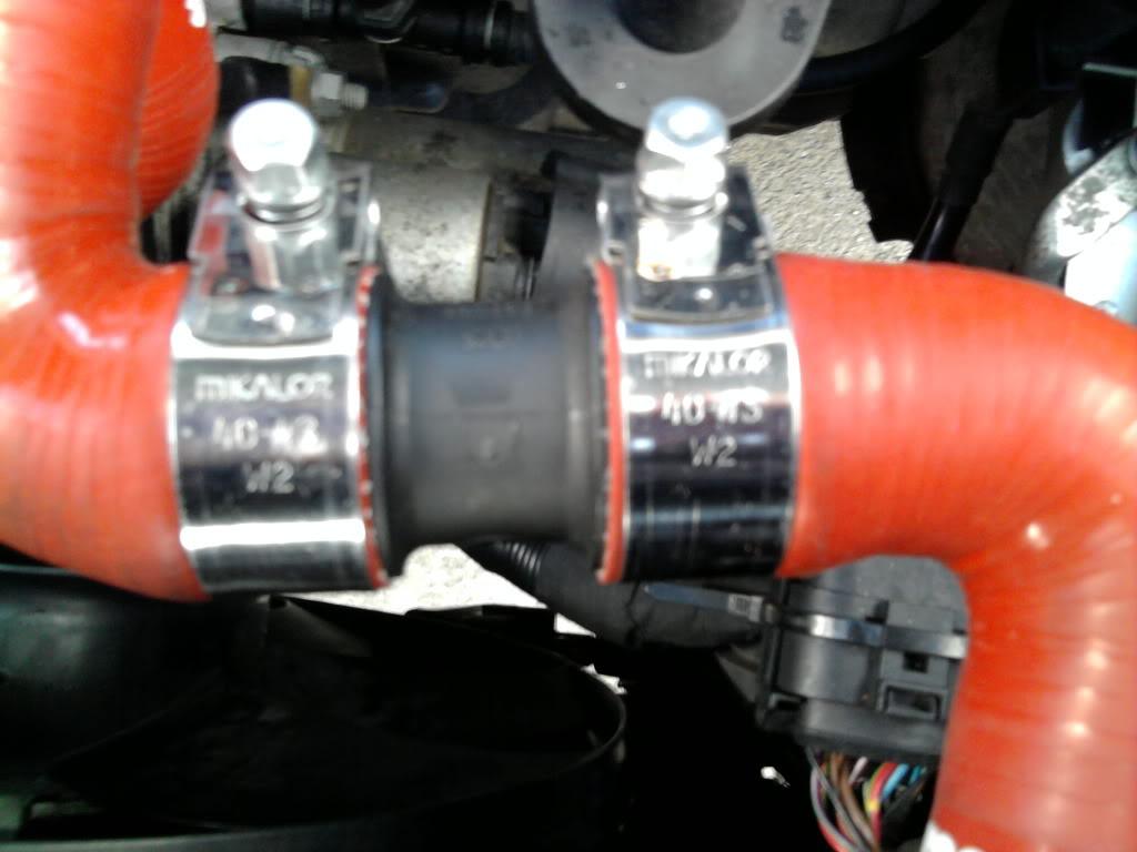

some clamps to hold them in place

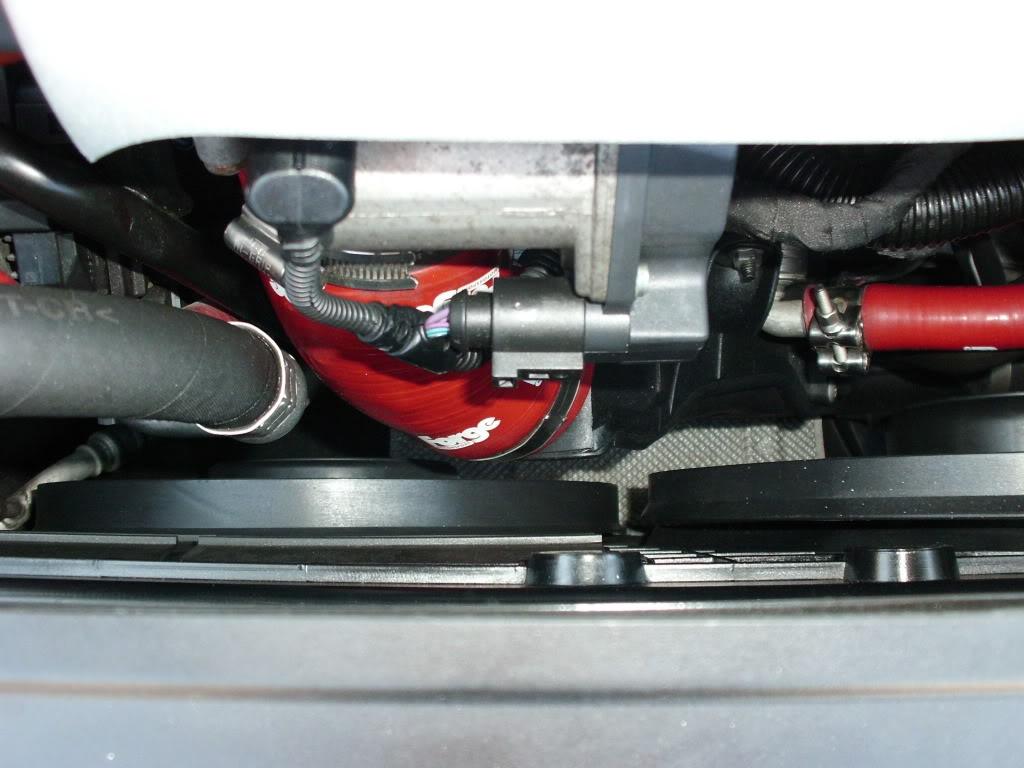

With the Forge throttle body pipe
At around the same time i think i removed the catchcan...

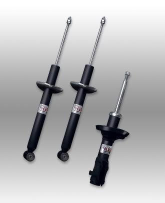

So with more power mods done, handling had to be sorted out...  :driver:
A set of KW's at the ready
Sport shock absorbers  :notworthy:
 KW Sport Shock Absorbers meet all claims of a modern high-performance damping system. All KW sport shock absorbers are specially developed with a sportive damping setting for road-use. KW engineers are using all their knowledge from suspension development and motorsport to find a perfect setting during extensive road testings. The twin-tube gas shock absorbers are equipped with hardened, chrome-plated piston rods and offer ideal protection against stone chips and corrosion. A new innovative monoblock rod guide and seal system raise the pressure resistance, reduce the friction and enhance the capability. The new working piston with V-shaped Teflon seals reduce the friction losses to a minimum and ensure a high temperature-resistant and long-lasting damping system. All KW sport shock absorbers are equipped with a rebound (shortened stroke), assure optimum bore-stroke ratio and arrange pre-stressed springs. A big part of the rear axle shock absorbers is equipped with spring plates which are height adjustable by slots. This enables to vary the car height in 5 additional positions.
•Characteristic curves specifi cally for the intended use
•Extensive road testing for optimum road-holding
•Optimised working piston with V-shaped Tefl on seals
•Pressure resistant monoblock guide and seal package
•Extremely low-friction and pressure resistant system
•High temperature-resistance and constant damping forces
•Hardened, chrome-plated piston rods
•High-quality components, modern production processes
 and optimum quality control guarantee reliability and durability
•Shock absorbers with shortened stoke, in some cases with spring
 plates height-adjustable by means of slots
I had these installed with my KW's:-  :innocent:

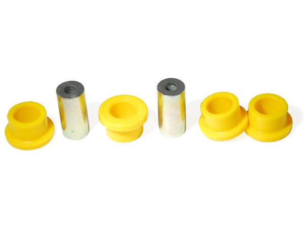

With the shocks & springs i added:- The Whiteline anti lift kit
My Big mate Tim Advised me to get these at the same time aswell, without these before long i would have needed new bushings! Im glad i listened.
Polyurethane replacement bushings for your front control arms
Key Feature and Benefit
 Whiteline bushings utilise the latest technology polyurethane materials combined with effective designs such as the internal bore knurling and grease retention lips for optimum lubrication & performance.
Features and Benefits
 Whiteline utilises the latest polyurethane technology to provide bushings with the combined physical advantages of a solid bushing such as strength & geometry retention with the extreme flexibility characteristics of rubber . All bushings supplied feature internal bore knurling to maximise grease retention and eliminate squeaking.
To help reduce wheelhop & understeer  :driver:  also look good when up on the ramp!
They did work, less slip when putting the power down on dry & wet roads, tourqe steer was no longer, but a new set of tyres was  :signLOL:
For those who dont know about whiteline:
Whiteline Anti Lift Kit (WALK) is designed to add 0.5 deg static positive caster to both front wheels while changing the nature of front anti-dive & lift. The low compliance bush also maintain higher dynamic positive castor. By changing the front control arm geometry - the new alloy mounts coupled with the new low compliance polyurethane bushes change front suspension attitude. This leads to superior traction under power including cornering & dramatically reducing understeer & front wheel spin. The additional castor coupled with the new firmer bushes supplied serve to dramatically sharpen initial turn-in response then forcing more consistent alignment angles through the corner due to the reduced bush compliance
