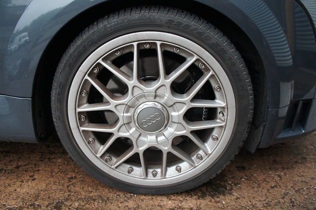

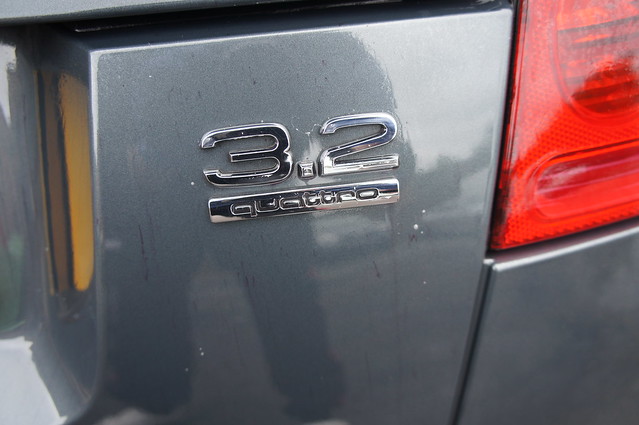

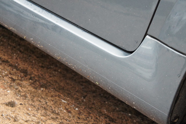

A few before shots - nothing too bad, just general light road grime:
DSC07803 by RussZS, on Flickr
DSC07805 by RussZS, on Flickr
DSC07806 by RussZS, on Flickr
DSC07807 by RussZS, on Flickr
DSC07808 by RussZS, on Flickr

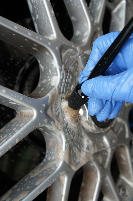

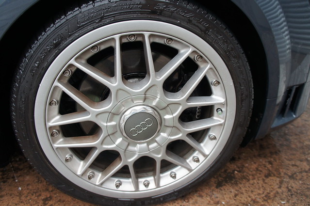

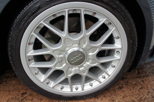

Wheels were dealt with first:
DSC07809 by RussZS, on Flickr

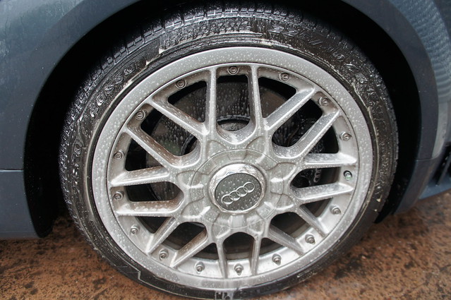

Liberally covered in Auto Smart Smart Wheels:
DSC07810 by RussZS, on Flickr

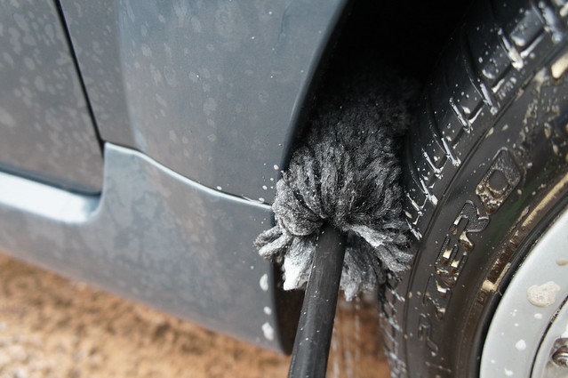

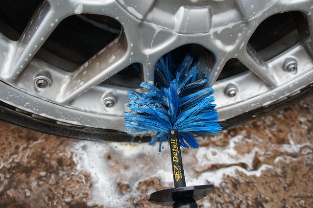

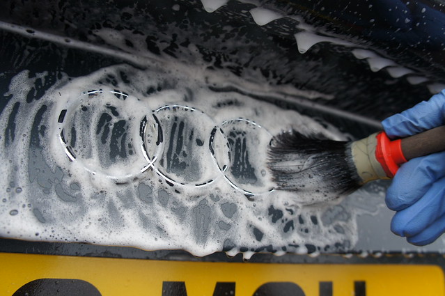

Worked with various brushes:
DSC07811 by RussZS, on Flickr
DSC07812 by RussZS, on Flickr
DSC07813 by RussZS, on Flickr
DSC07814 by RussZS, on Flickr

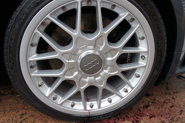

and rinsed clean:
DSC07815 by RussZS, on Flickr
IronX was then used to remove any brake dust pitting and fallout, but very little was present:
DSC07816 by RussZS, on Flickr
DSC07817 by RussZS, on Flickr

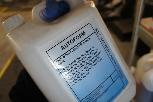

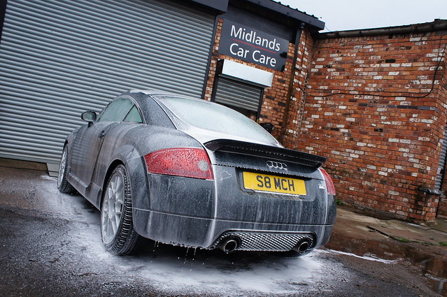

Next Bilt Hamber Auto Foam was used to begin breaking down the general grime present on the car ahead of making physical contact with it:
DSC07818 by RussZS, on Flickr
DSC07819 by RussZS, on Flickr

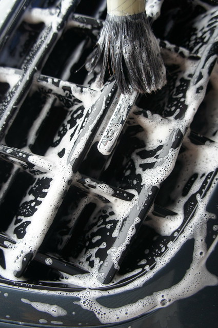

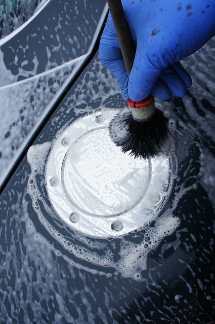

Next Surfex HD was used on the more intricate areas around the car:
DSC07820 by RussZS, on Flickr
DSC07821 by RussZS, on Flickr
DSC07822 by RussZS, on Flickr
DSC07824 by RussZS, on Flickr

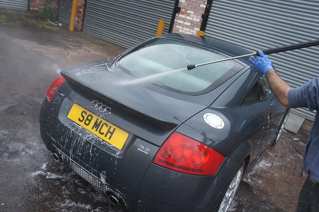

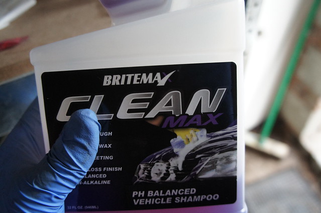

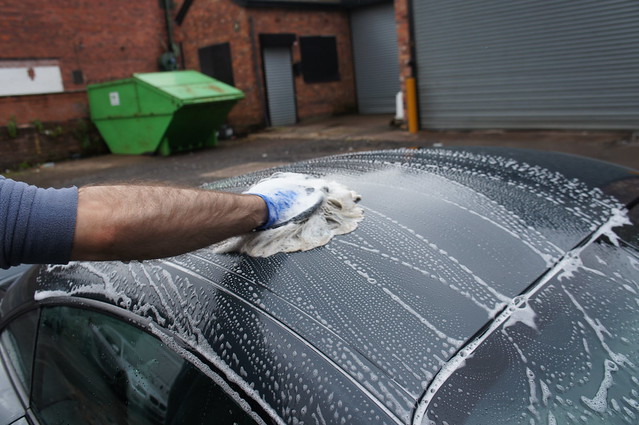

Next the foam was rinsed then the car was safely hand washed with BriteMax CleanMax and CarPro Mitt:
DSC07826 by RussZS, on Flickr
DSC07827 by RussZS, on Flickr
Then rinsed again:
DSC07829 by RussZS, on Flickr

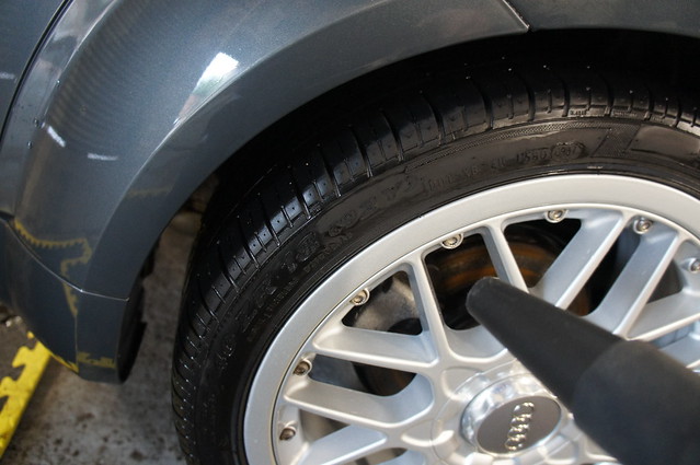

Whilst the car was being clayed, I began drying parts of the car with my 'blower':
DSC07834 by RussZS, on Flickr

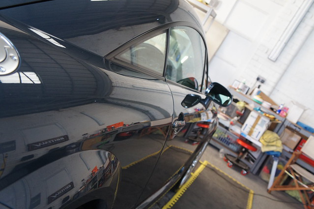

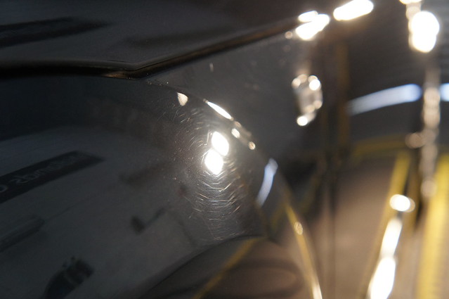

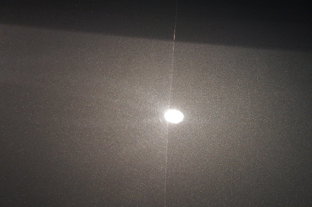

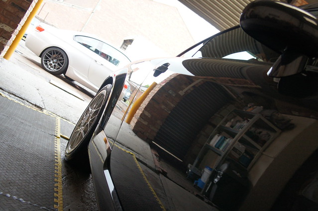

Next we turned our attention to the paintwork.

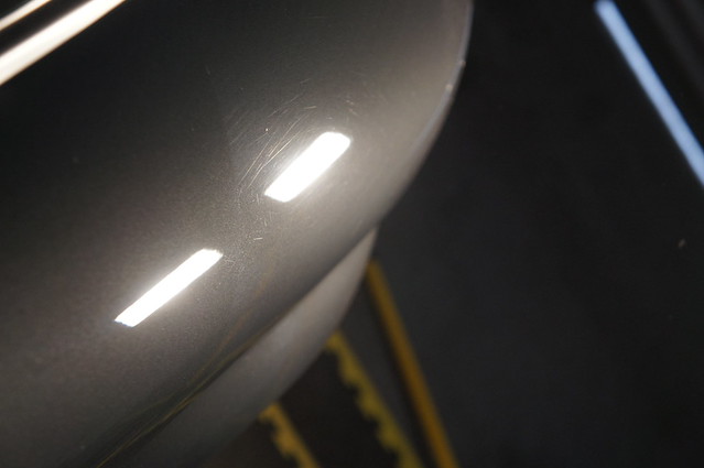

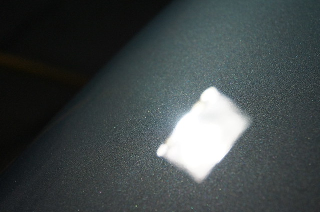

Despite the car looking incredible already, under lighting it was very apparent that the car was littered in swirl marks along with some deeper scratches in places.
After assessing the thickness of the paint to look for signs of resprayed panels or areas where paint thickness was low, we began assessing combinations to use.  The paint was very hard indeed, and required Meguiars 101 via Polishing Pad and Rotary, followed up with Megs 205 and black Lake Country Finishing Pad to refine.

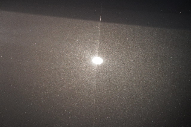

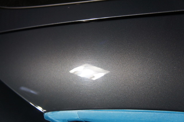

Some of the defect and correction shots:
DSC07836 by RussZS, on Flickr
DSC07837 by RussZS, on Flickr
Before:
DSC07843 by RussZS, on Flickr
After:
DSC07851 by RussZS, on Flickr

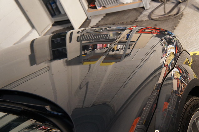

The flake in the paint was incredible under lighting!
DSC07845 by RussZS, on Flickr

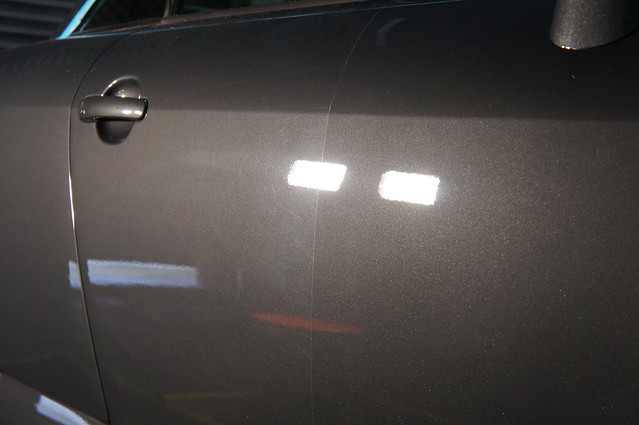

50/50 showing the amount of colour and gloss restored from the correction process:
DSC07853 by RussZS, on Flickr
DSC07855 by RussZS, on Flickr
DSC07859 by RussZS, on Flickr

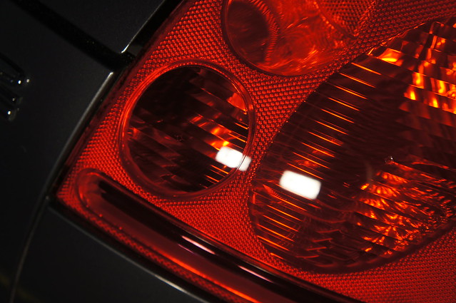

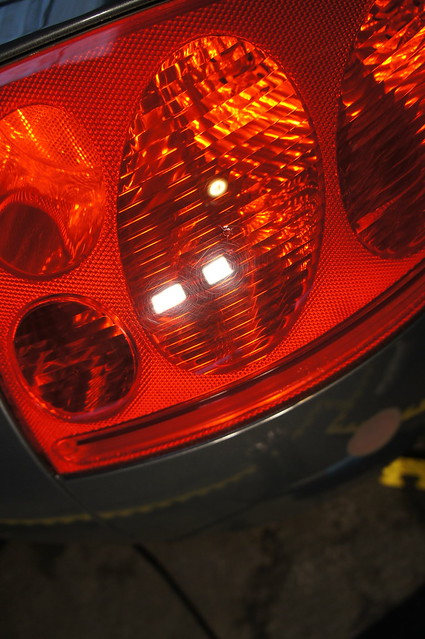

The rear lights were also machined to remove the swirling:
DSC07870 by RussZS, on Flickr
DSC07873 by RussZS, on Flickr

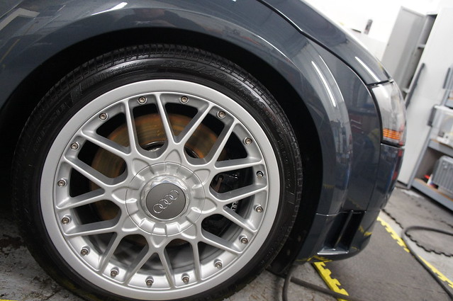

The wheels were treated to Finish Kare 1000P and Auto Finesse's excellent new Satin tyre dressing!
DSC07884 by RussZS, on Flickr
DSC07886 by RussZS, on Flickr
DSC07887 by RussZS, on Flickr

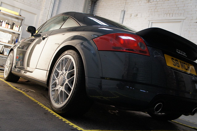

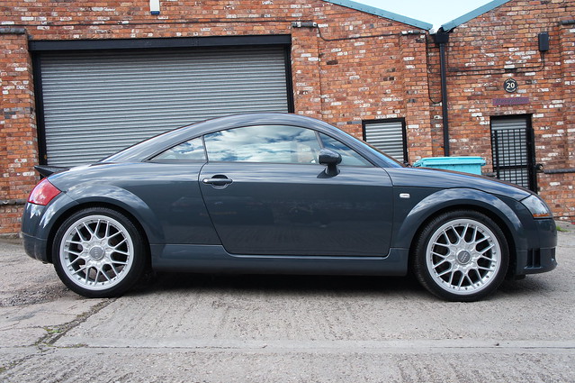

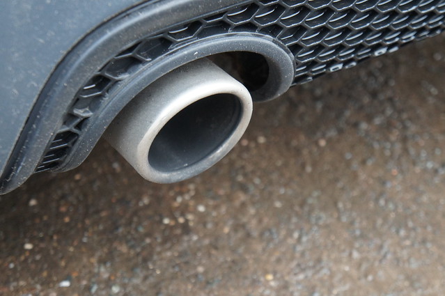

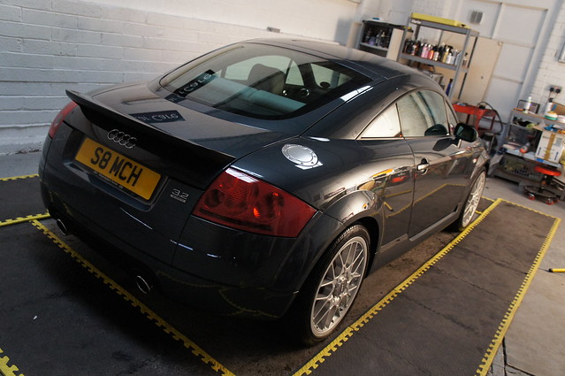

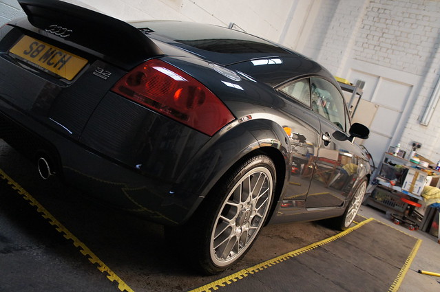

Finally, some afters.  The Sun kindly went in just as I finished up, so a mixture of final shots:
DSC07888 by RussZS, on Flickr
DSC07889 by RussZS, on Flickr
DSC07890 by RussZS, on Flickr
DSC07891 by RussZS, on Flickr
DSC07894 by RussZS, on Flickr
DSC07896 by RussZS, on Flickr
DSC07899 by RussZS, on Flickr
DSC07903 by RussZS, on Flickr

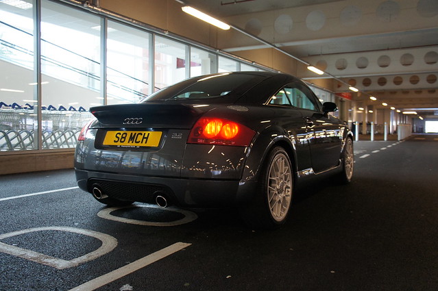

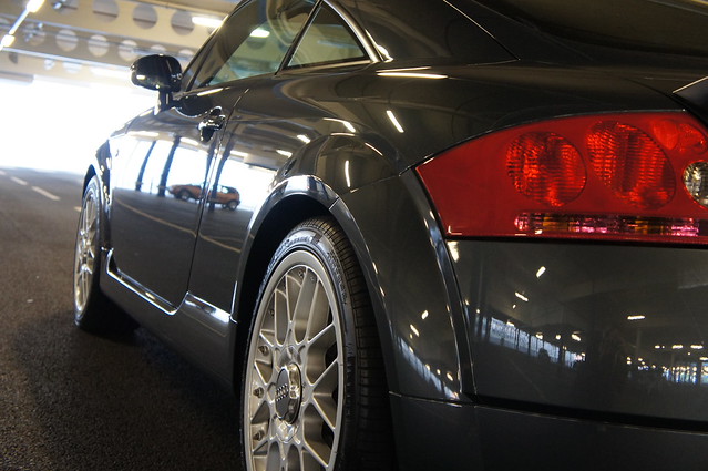

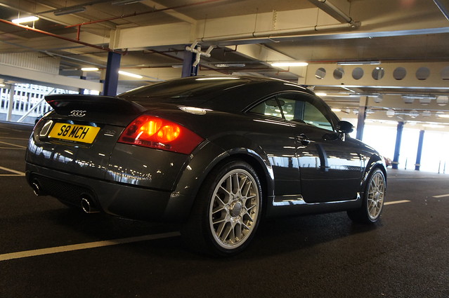

and a few Tesco shots:
DSC07911 by RussZS, on Flickr
DSC07913 by RussZS, on Flickr
DSC07918 by RussZS, on Flickr
DSC07922 by RussZS, on Flickr
DSC07927 by RussZS, on Flickr
