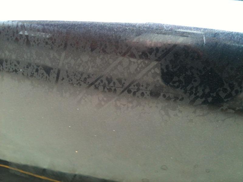

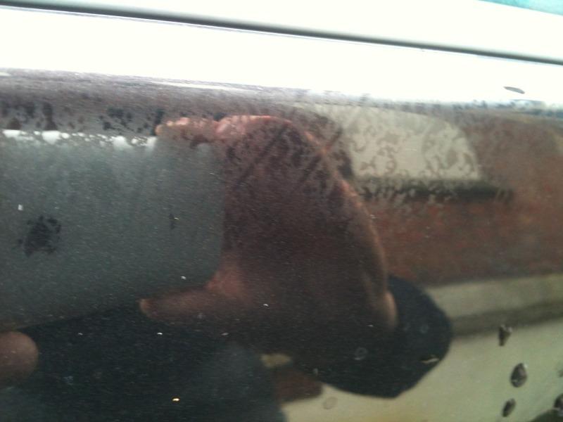

Just noticed this on my bonnet, thought initially it was like tree sap or something but its not.  I checked other parts of the car and its all over it :( :( :( i dont know what it is or where its come from, pics below, it has no feel, its not raised or anything.............very worried right now!  There are a few patches on the bonnet, the one on the pic is just above the door handles and one big patch on the back pannel.....its totally smooth to feel, no different to the rest of the paint work.
ive tried to take the best pics i could, its hard to show in a photo.  anyone know what this is, how its caused and how to get rid of it?? could you detail it out?

Has it been painted? Looks similar to what happened on a friends after it had been painted then a car cover used

If the car hasn't been painted, I wonder whether it's moisture trapped under the clear coat, in which case it may settle once the weather improves.

The side skirts were sprayed the other week but this area has never been touched no?
Moisture under the paint, to be fair it does look like that but can that even happen?

its where they have covered it in plastic sheeting and then probably left it outside.
A proper machine polish should remove it.

Was the side skirts on the car when they sprayed them..if so there has been moist under the area where its been masked of then placed in the oven to dry of

Yeah from what I understand they left them on, so do u reckon thats what has caused this? Cause its been raining all week since having it done I've nit really noticed it.
Is it fixable???

It almost looks like tape residue left after a detail or stuck over un-cured paint. Looks to only be in the clear coat so it may just buff out. Good luck!

Id say its most probably from the body shop due to moisture. But a good machine polish will remove this, as part of machine polishing it generates heat which will also improve the situation.
I get alot of this where people have had magnets stuck to the car and water has got behind them and when the paint heats hot and water is still trapped it caused this issue.

thanks to everyone for their input - i took it back to the body shop, it was what most people said, water getting under the plastic sheeting  had damaged the paintwork
30 minutes later it was back to its old self!
in fairness, thanks to the guys at G and D Smart Repairs Bristol, did it straight away, no questions asked!
