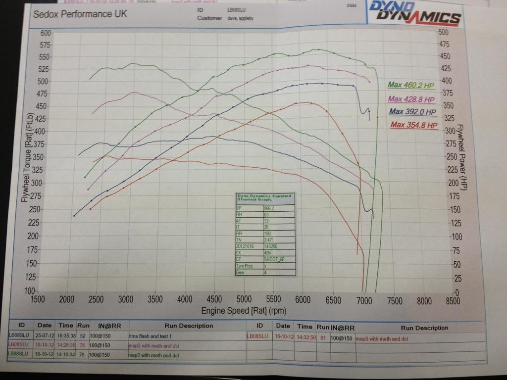

heres a graph showing stock, stage 1, stage 2 and stage 3. Figures for stg1 and stock are high as the car has full bolt-on mods.
(can't get it to show in correct rotation sorry)
