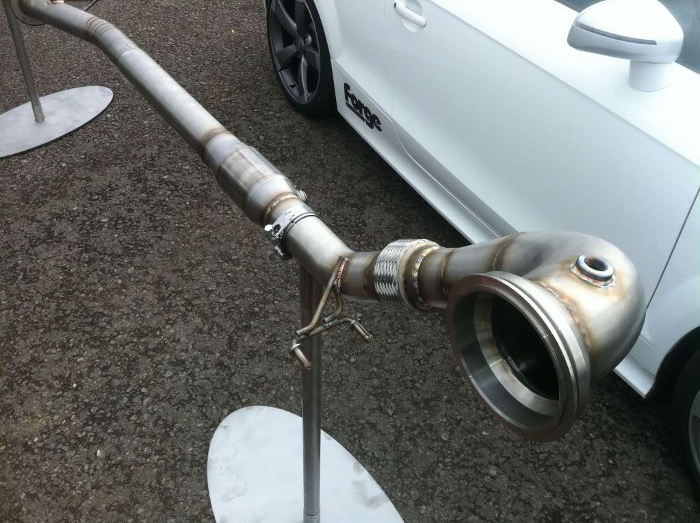

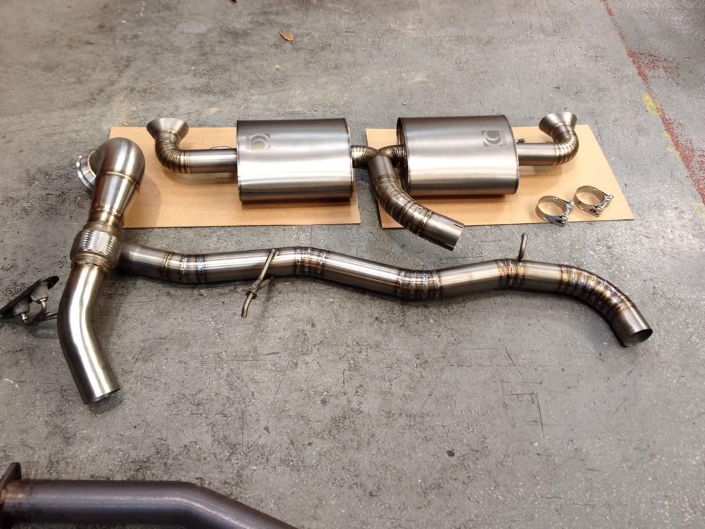

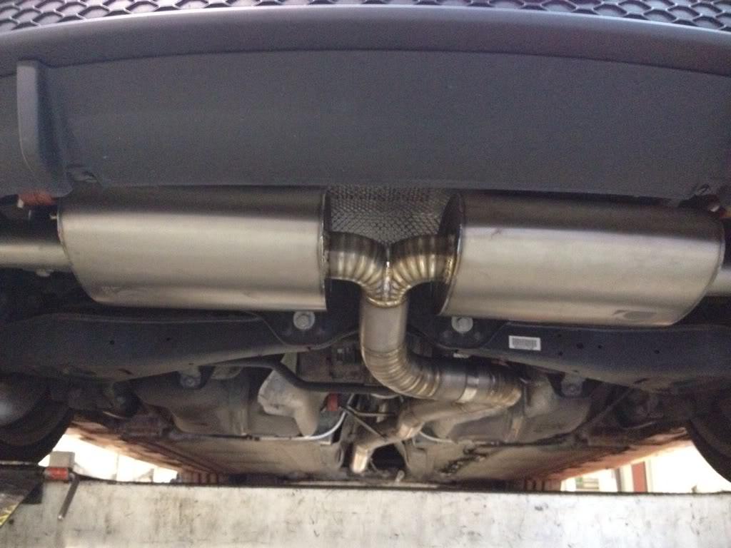

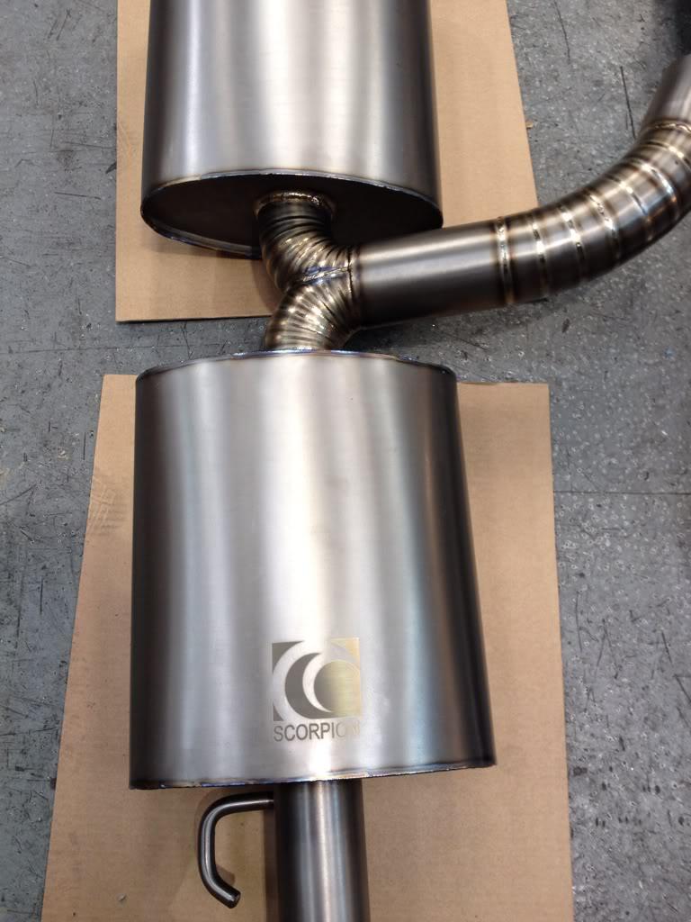

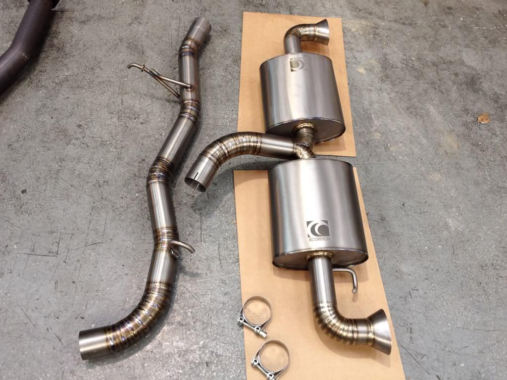

Then I decided to ditch the milltek in favour of a scorpion turbo back titanium exhaust.
This exhaust is the most beautiful piece of engineering I have ever got to touch I must say. Work of art!
And the weight saving is awesome too, i could lift the backbox with my two little fingers!
It turns blue after having got hot!

I bet that wasnt cheap, judging on all the welding done on it!  :scared:
Looks nice tho  :happy2:

love the new brakes ansd the exhaust is a work of art

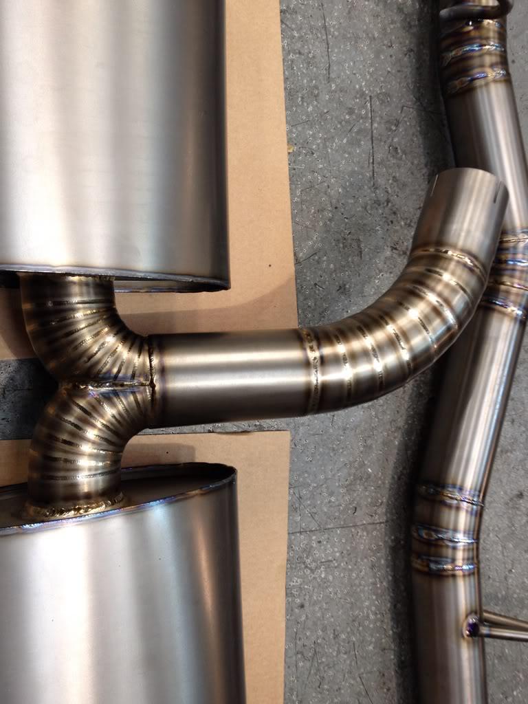

Thanks, it wasnt cheap no, but it is cheap when compared to the titanium exhausts prices of other manufacturers. With the amount of labour that goes into their Ti systems, I would say its actually a good price all things considered.
Its welded instead of bent, as bends decrease the diameter of the pipework apparently.

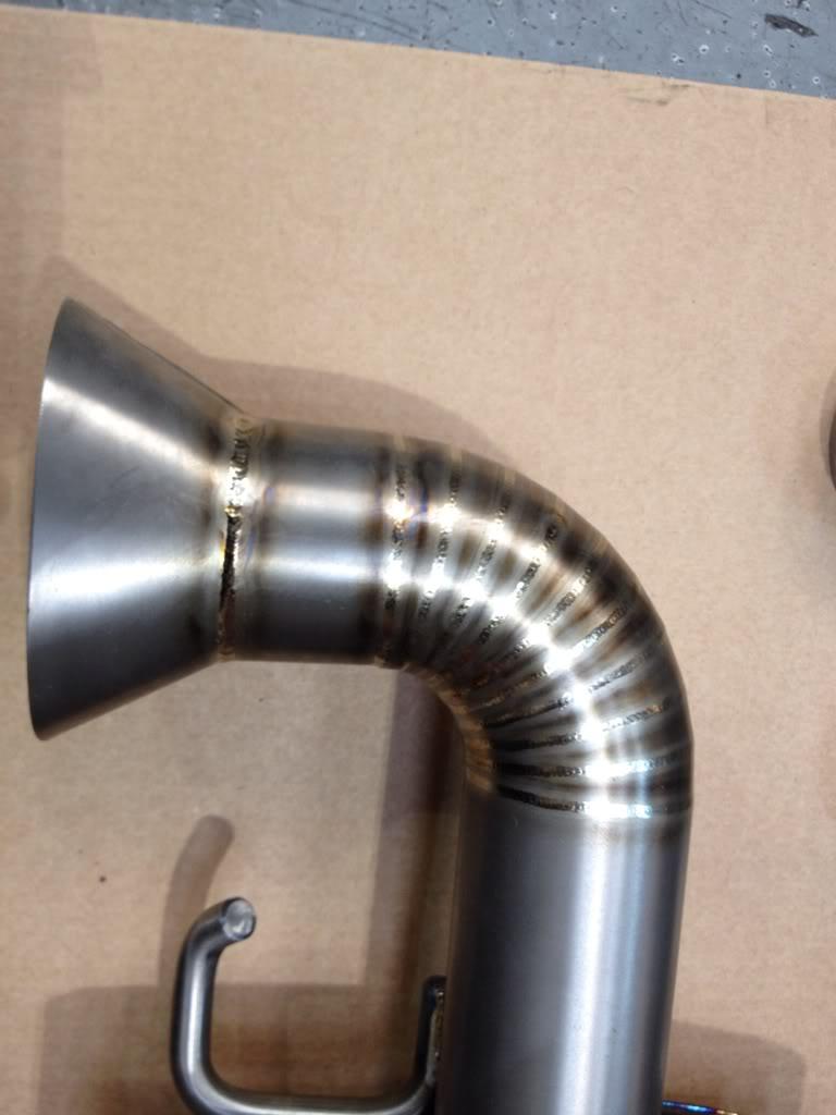

If its done correctly and mandrel bent it shouldnt.
[/quote]
thought mandrel bendind on the exhaust kept the same diameter :surprised:

Wonder if its different for Ti? I was just told the bends where lasercut and then re-welded, instead of mandrel bent, its because mandrel bends reduce the diameter of the piperwork and add extra friction/resistance
More info on the workmanship from what my friend tells me who has some experience in this sort of thing:
A shop bender will crush the pipe to form that kind of elbow on Ti on the backbox.
With laser machines the cuts will roll to a nigh on perfect diameter, then tack them up and the bend will form very well, in the hands of a skilled sheety.
The welds will be done from the outside only, with a purge gas inside the pipe to stop oxidation and keep the weld pool stable. This also means a single pass, almost 'fuse' weld run that minimises distortion and results in a smooth inner joint surface, plus a luvlly jubbly exterior weld pattern.
Yeah.. thats what you REALLY dont want, as it almost halves the diameter on a 90degree bend.
What you get with mandrel bending is a variation in the wall thickness of the tubing.
