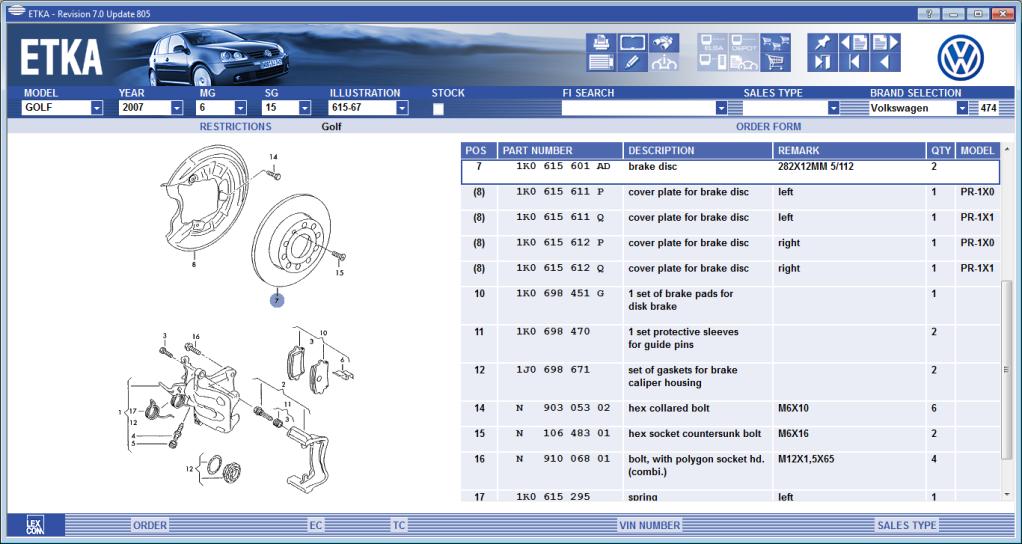

The ED30 needs new discs and pads on the rear so popped down to VW to pick some up yesterday, i'd already got hold of the part number for the 286mm solids (1k0 615 601 M) but apparently this number has been superseded and is now 1k0 615 601AD..
Only problem is that the new number relates to 282mm solid discs? Parts guy even picked some to check and measured them at 282mm dia. He's 100% sure that these are the correct discs for the car and that they have changed the disc size for some reason?
Anyone with ETKA who could confirm please?

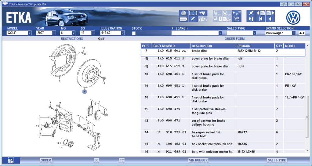

Yep 1K0 615 601 M has been superseded to 1K0 615 601 AD, but this is listed under two different versions for the Mk5, one at 282mm and the other at 286mm :confused:

^^^ No on the GTI/ED30, they are on the R32/S3.
Variant 1 - 282mm
Variant 2 - 286mm
Both listed for the Mk5 2007-2008
Cheers Steve, much appreciated  :happy2:
Seems a little strange to have 2 sizes listed and i'd rather have the 286mm ones but my parts guy will only supply the 282's?
Think i'll have to head down to ECP instead...  :confused:
