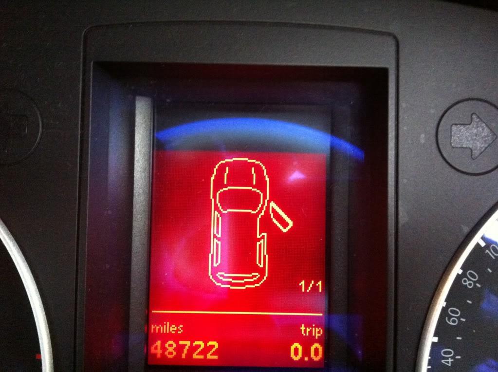

Cheers mate but unfortunately it doesn't end there. Looks like I may be experiencing similar probs to Baz, mine all seems to work ok but I lose the top part of my display where the clock is meant to be.

I hope so too! They seem to be quite helpful though. Its odd as the clock is there when flicking through the menus but not there when on the home screen.
