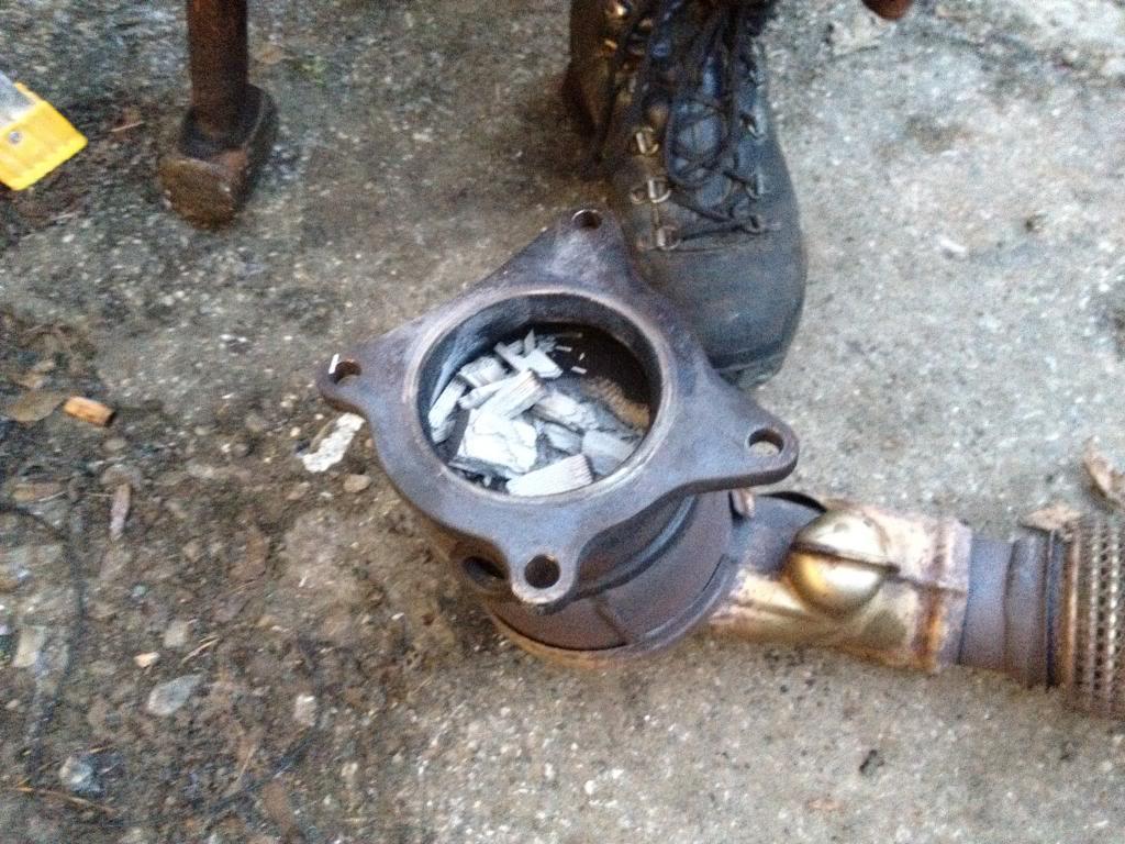

Just wanted to say thanks for the people that helped and advised on the Pre-Cat removal Topic:like Dave from PDT and others
So i finally got around to removing my pre-cat with my mate today. And wow, what a difference. For 2 hours labour, you wont get a better mod.
Bit of a ball ache removing all the bolts (used 3 in 1 penetration oil form Halford - worked awesome on the rust)
Once all the cat materials was chipped out and removed, we then strapped the DP back on. started it up and straight away got a really nice burble on down revs. Took it for a spin, cant believe how more responsive it felt for a such a small cat removal.......it halfs the time of the turbo lag in normal Drive mode, but as soon as you pop it in Sports mode....wow...no lag at all !!!!
Just need my re-map now   :pomppomp: :pomppomp: :pomppomp:
Find some quick pics below:
Thanks for all the help

« Reply #1 on: December 07, 2012, 11:07:41 am »
Excellent, defo going to do this.  What aspect takes the longest?  Getting the system out?
Re: Thanks for the Help with Pre-Cat Removal
« Reply #2 on: December 07, 2012, 11:09:58 am »
taking the f/p of takes the longest to do
Just getting all the bolts lose....make sure you have some penetrating oil...like the 3 in 1 from halford or Duck oil.
