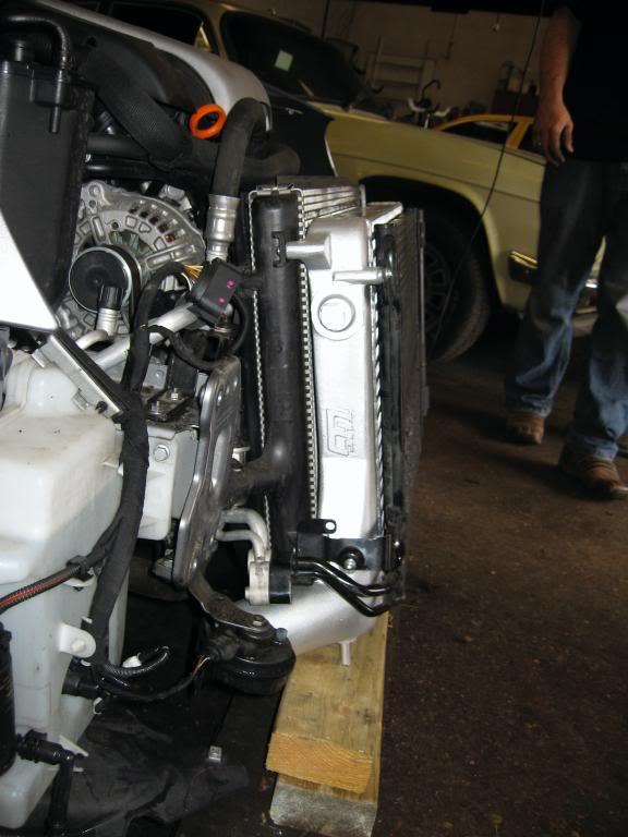

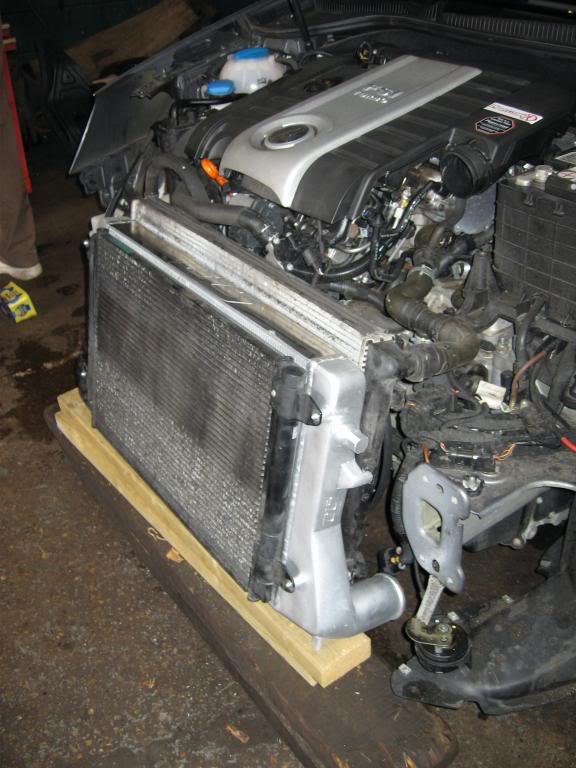

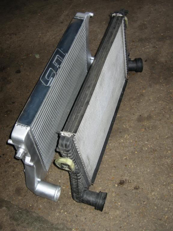

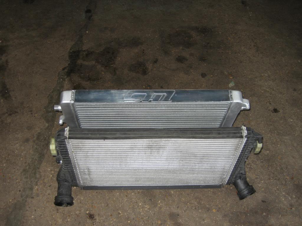

A big thanks to Neil and Ollie at THS Performance (and Neil's dad for the loan of the workshop) for getting up early on Sunday doing this while they were local to me after there day at Inters on the Saturday  :happy2:
A full review will follow in the next couple of days once I get some more miles on the car but initially impression is realy good and it has made a big difference to the car  :smiley:

Looks like a right industrial unit, have you been doing much logging since the install  :smiley:

thats a beast, looks like a real quality bit of kit. id be interested to hear your findings

Initial loggin on Sunday showed a big drop in intake temps. Typically it was running upto 30-40 degrees above ambient when pushing on for a while (so on a 20c day I was seeing temps between 60-70c) but now the highest I saw on Sunday was 20c above ambient.
The other good thing was the recovery of the temps was a lot quicker too  :happy2:

that looks exactly linke the s3 cooler except it has a logo on the top,

It will look similar to the S3 cooler as it fits the same space, but isn't just a rebranded S3 one  :smiley:
