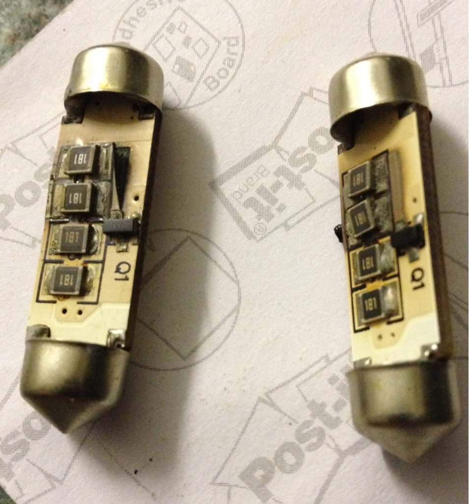

Finally removed the bulbs last night. First thing that hit was the smell! It's like TCP!
Here's a pic. It's clear to see that they have overheated.
Apparently they have a 1 year warranty...
Have replaced them with a pair of VW issue bulbs for now. Still want the white LED look though so will invest in the new year.
