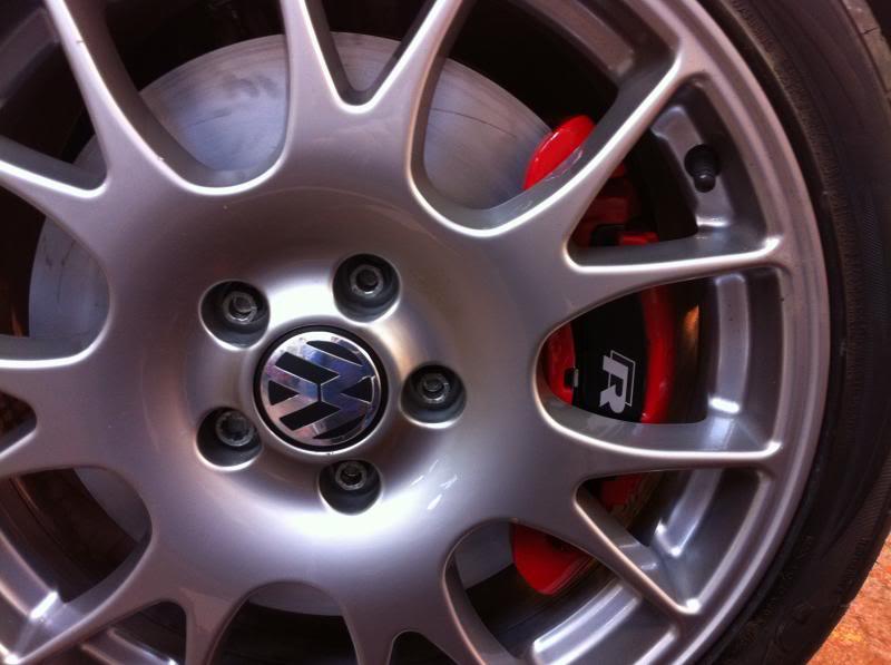

With What...Just done this 3.2 conversion on Saturday,be quick while its still fresh in my memory.

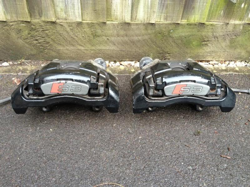

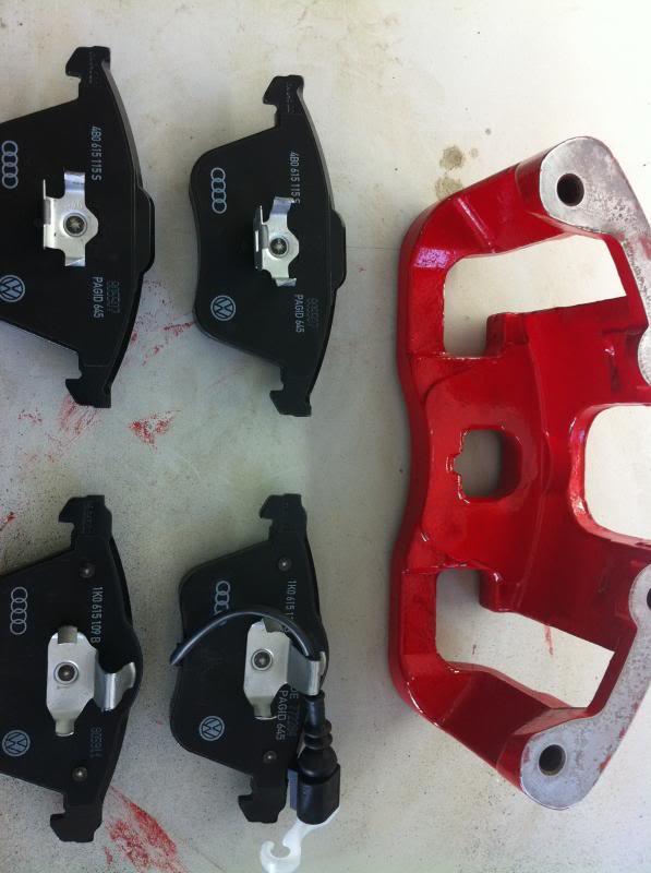

Only problem I had was with the wrong parts, S3 calipers are NOT exactly the same, in that S3 pads and S3 retaining Badges will not be secure on 3.2 calipers,  you will need the pads with a retaining clip on all four pads( S3 have only one clip on inside pad), that way you can use the S3/R  caliper badges on 3.2 calipers.

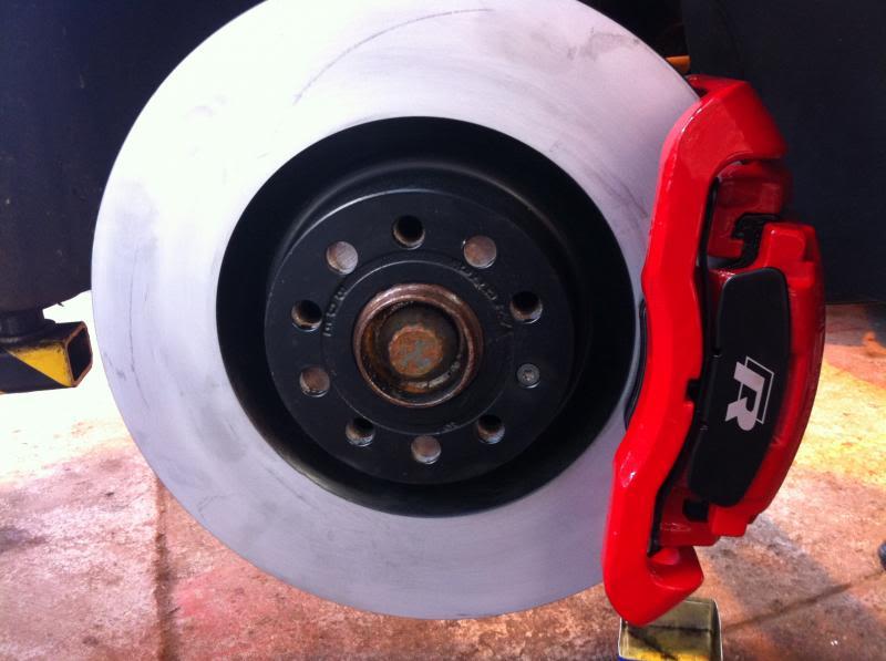

With Genuine S3 Pads(pic without R badge,no outside pad clip), slot in middle of caliper(under R logo) not present on S3/R calipers
These are the correct pads

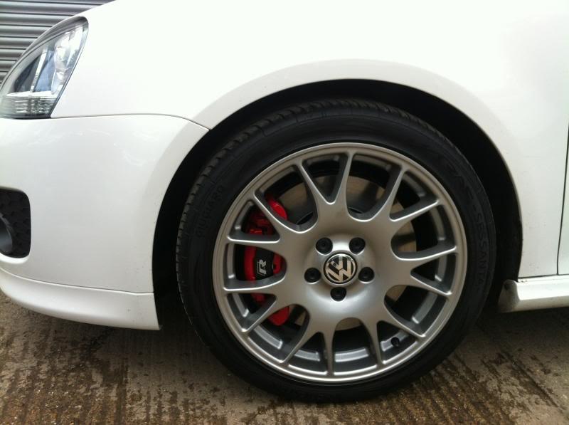

All working,note silver tab under R logo,this holds the R Badge secure.

Parts used
Pads. 1ko 698 151B
Calipers are 3.2
Clips are Golf R, all parts were from TPS, R clips cost just short of £60, madness but i wanted them... pads were £51.80, but of a bonus coz the S3 pads I had originally were £95.

Very easy conversion having done it now with the correct parts and makes the eddy  very assured, what it should have had on from factory.
