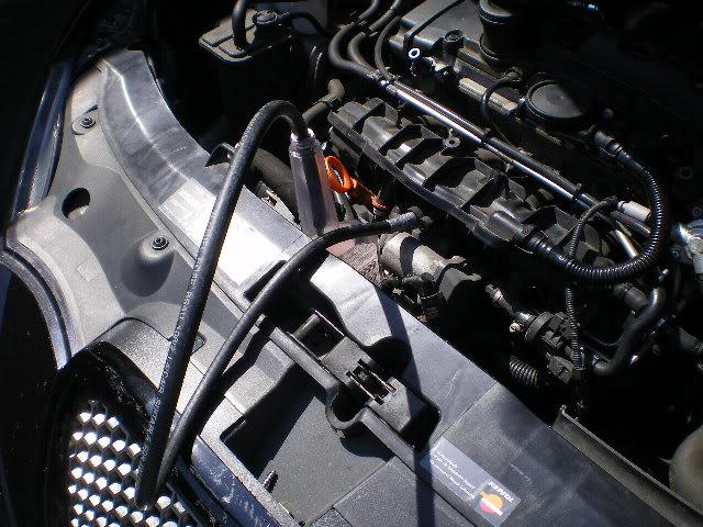

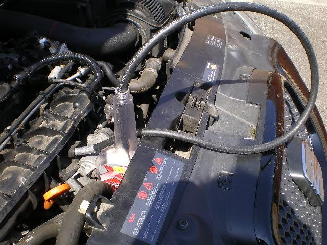

I had a go at doing it the way below, certainly never did any harm,
Quote from: jon-tfsi;2693446
The best way to get these products onto the valves on a TFSI engine is directly into the intake manifold. I have tried it and works. You cant rev the engine though as if you get boost pressure the pipe will be blown out of the port. On the other end of the pipe is a football inflation needle which meters the flow of product (redex in this case). On tickover there is a vaccum which draws the redex into the manifold and over the valves.
