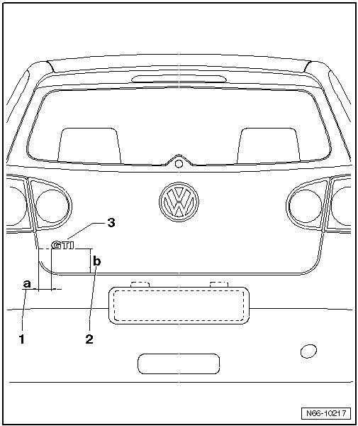

« Reply #1 on: August 06, 2009, 01:15:57 am »
I posted the VW location guide around here somewhere which shows exact location...

Re: Rear badges "GOLF" & "GTI", which side?
« Reply #2 on: August 06, 2009, 06:22:24 am »
GTI's never had a Golf Badge. Should just have the GTI badge on the passenger side.  :happy2:

« Reply #8 on: August 06, 2009, 03:19:34 pm »
Excellent, but what are dimensions a and b supposed to be?
EDIT - found the info myself, a should be 50 mm, b should be 90 mm.  Thats for a non-gti though, and the dimensions are a mirror image on the other side (except measuring from the end of the number).
