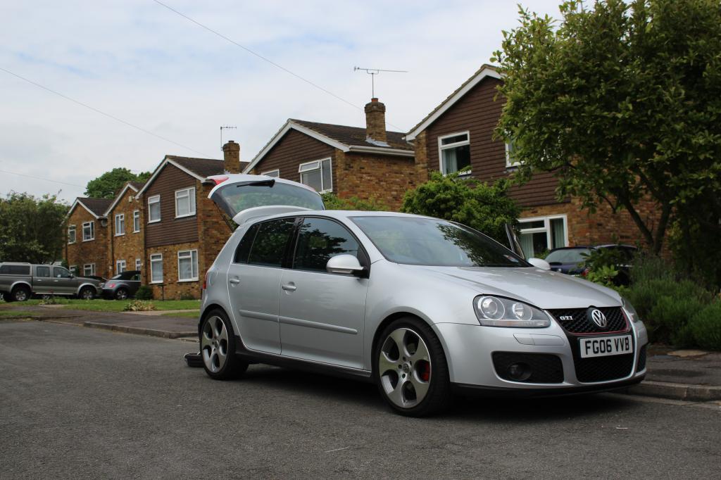

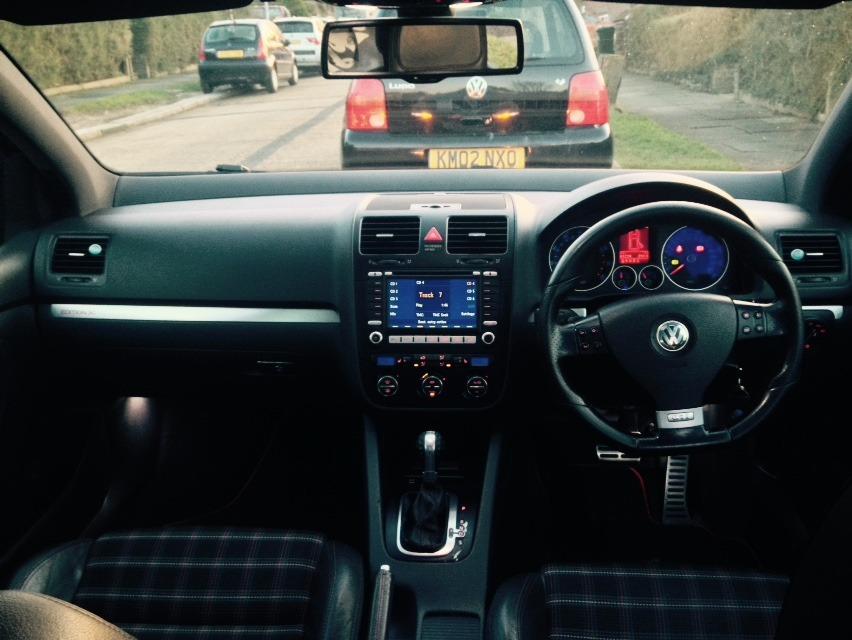

I picked up a 2006 GTI 10 days ago. Spec list
DSG with paddles
Reflex Silver
85k
Cambelt and WP changed with FSH.
Sunroof
Xenons
Puddle Lights
Leccy folding mirrors
A few dinks and dents here and there but overall seems really good condition. Wheels are corroded to hell however I'm quite happy with it.

Hi Jamie
Looks nice
I see it is an import because it has electric seats
check that it has an alarm
Cluster and Key coding

Looks a nice example.
Electric seats. I'm "well-jel" lol
Haha they are so nice! Little things that make all the difference.. if/when I get some Recaros they would be up for sale...  :popcornsoda: :popcornsoda:
