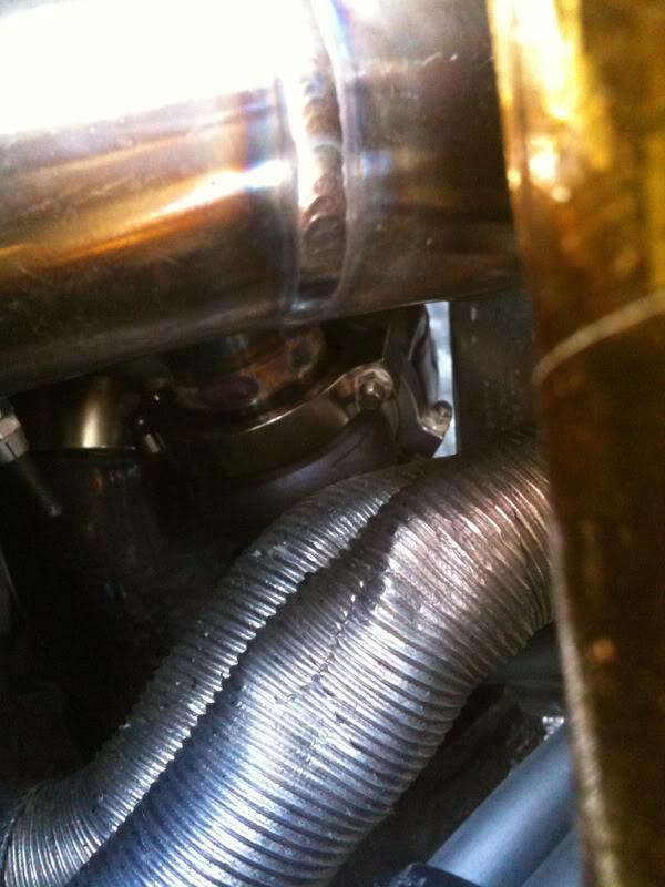

Update..
So after first impressions I was able to have a few hours in the car last night, putting some miles on the new set-up, listening for any strange noises, and generally just bedding it in a little.. All seems great!
First of all, just wanted to do this video to prove, with the right map (REVO) RS4 injectors, cold start is not an issue..
First start this morning, stone cold, had not been ran for 12 or so hours, with a 1.5 degrees C ambient temperature..
No problems, cranks and fires no different to how it did on the K04 with stock injectors..
So after having some more time with the car I can confirm that its very fast of course, but at the same time extremely driveable, quiet when driving off boost, pulls smoothly from 1000rpm with NO problems what so ever, super responsive, and
Again, the thing that has really amazed me about this set up is just how responsive the engine is from such low revs! Ok, for sure it has more lag than the K04, but seriously not 'that' much more.. But once your at 5k revs the difference between the two is night and day! Just amazing..
In terms of performance.. (test completed on private driveway)
I think that 40 - 100 in 4.2 seconds is pretty impressive, considering that its only running 17psi and it was wet!!
Once its dry, or at least, not snowing, ill get some videos to prove this, its seriously, seriously fast!!
I can only imagine in the dry, with 255 R888's, running 24psi and with another 200kg out how fast its going to be.. I guess we will all find out on the 17th Jan!!
On a DSG note, all is perfectly fine, the changes are still lightning fast, solid, no slip, no hesitations, all perfect.. And boost before, during and after a flat out gear change is almost completely consistent! Big turbo 2.0T FSI and DSG is the perfect combination!!
Anyways now for some pictures now there is some light!! Love the install..
Im really pleased with the way it looks, as I had said yesterday the engine bay looks really nice, not like a highly tuned car, and there will be more to come in terms of making it look even more OEM which is the way I want the car to look throughout..
When you look a little closer..
The only problem at the moment is this!!!!
How annoying!!!
