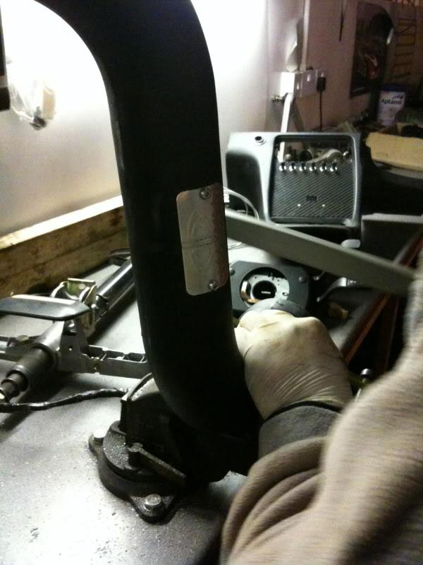

Ok so managed to get another couple of hours on the car today and made some progress with the new intake system that Ill be running..
The reason for this is to make room for the bonnet exit external wastegate dump tube.. Its going to require a fair bit of work, but im sure that it will all be worth it in the end!
Just to note that Im using the same diameter pipe work and MAF housing that I have been running with the Twintake, so im confident that I will not encounter any problems in that area..
So first we fabricated up the bends and mocked up the intake for fitment..
Im using an Evoms filter and filter neck so there was a bit of cutting involved..
And finally the complete mocked up intake off the car.. (marked up with the placement for supporting bracket tab and recirculation bung)
Just a few more bits to do once the intake is fully sorted..
  • Relocate catch can and charcoal canister to pasenger side
  • Relocate washer bottle to passenger side to allow for a 76MM cold air feed to filter
  • Fabricate filter heatshield
So im really pleased with that! The intake is now going off to be welded up and the pipe work ceramic coated..

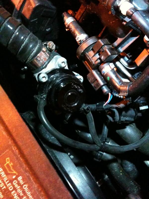

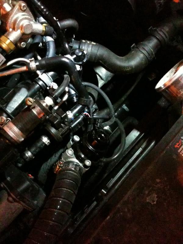

After testing the car before and after with the old and new MAF sensor I decided to fit the Forge Motorsports FSI valve, I had been running the completely standard diaphragm valve..
One off black anodized valve.. (ignore the nasty looking boost tap, getting a nice new one made up on the lathe)
Driving the car now with the new valve it again feels stronger.. All these little bits are adding up and the car feels better than ever!

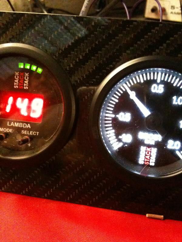

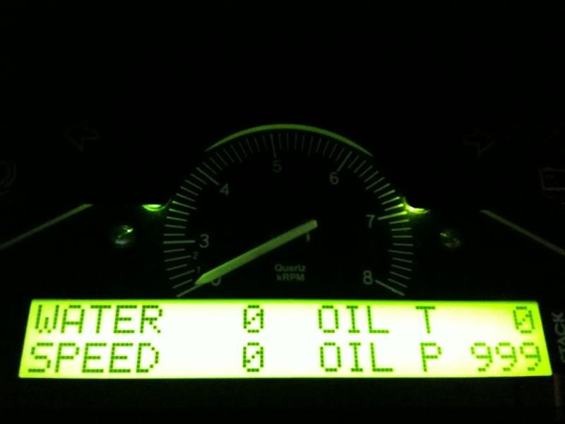

Oh.. And just a couple of teasers!
Offline Poppa Dom
  • Posts: 1553
Re: Jonnyc's MK5 ED30 Build Thread..
« Reply #1429 on: January 07, 2010, 06:13:18 pm »
Ahhhh, got yourself some wideband sensors  :happy2: Looking good Jonny!

The Stack discplay doesn't have enough rev numbers on it.... :wink:
I also demand you flock the dash and doorcard tops.
