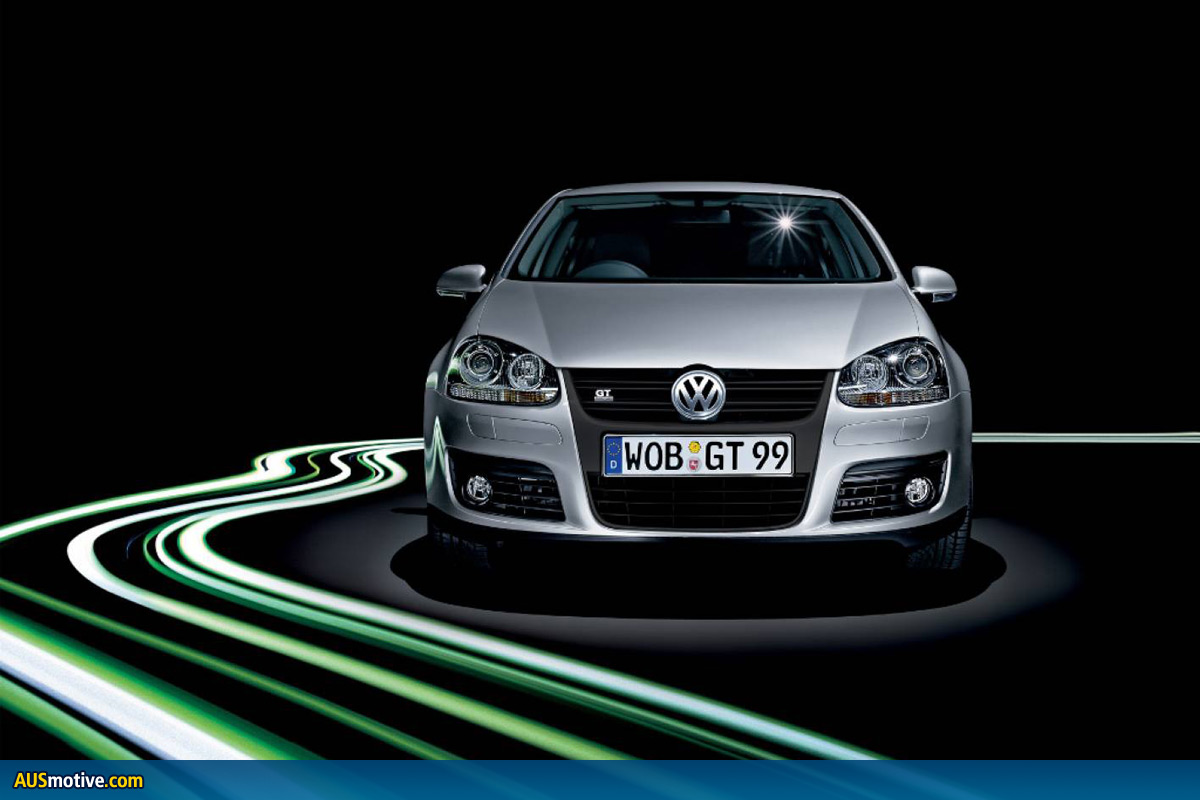

Also what models should he be looking at to get this front bumper:
rather than:
Thanks for any input!

Just seen photos ...I think 2006/07 they changed from old style to jetta/gti front end but 170 might have always had it
sent using my own fingers

power wise 140 will be fine, he wont be mapping. Only looking at the 170 because of the front bumper

I'm sure from 2007 all 140 gt's had udated front end end
