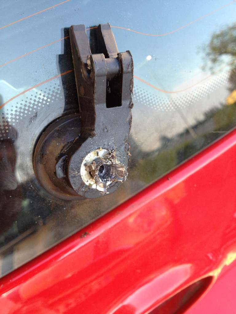

...only found this out after many hours of getting nowhere lol
Ended up drilling out the threads!
