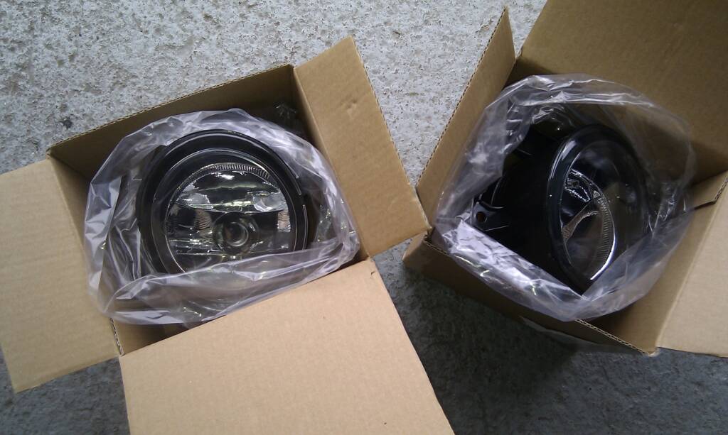

That's a reflector type as in later gti / gt

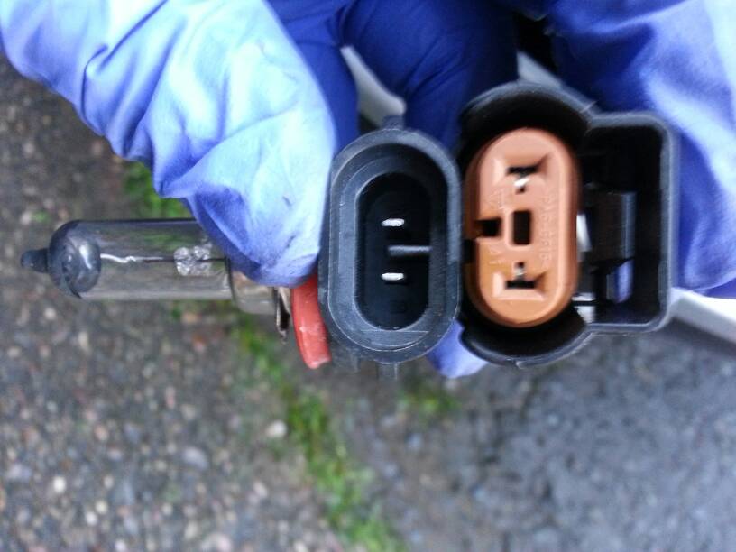

On the left is a h11 bulb and on the right is the larger 9006/hb4 connecter

H11 for projector (05 to 06ish)
H4B for reflector (06is onwards)
There was an overlap period over te 06/56 reg
