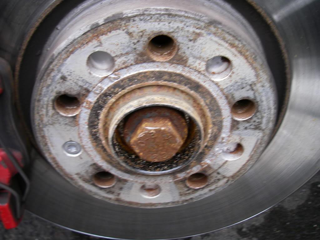

Right, I took one of the front wheels off to have a look, can you confirm for me that there are no Spigot rings in these two shots? I think it should be on the wheel side? If they are indeed missing would it be fair to say they should have been supplied with the wheels or is it up to the owner to get them? Will all good Alloy wheel dealers have them and does anyone know the size i will need?
Thanks,
R

To see if the spigot size is correct, when you have the car jacked up remove all of the wheel bolts and the wheel should still stay on the centre of the hub with all of the bolt holes lined up, if the wheel drops it means your spigot size is incorrect :happy2:
Edit: Looking at those pics the centre bore on the wheel looks like it should be about right, you can measure it yourself, the diameter of the hole should 57.1mm for VAG application, if this is the size of the hole then your problem lies elsewhere
