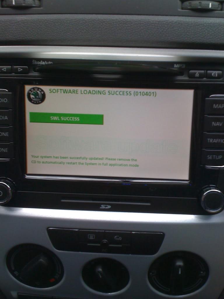

94% through just finishing off on the Gateway update
Will post back on here and on Briskoda when all done but fingers crossed its looking good

Well just got the SWL SUCCESS message so will play about now to see it all works  :congrats:
Carl :happy2:

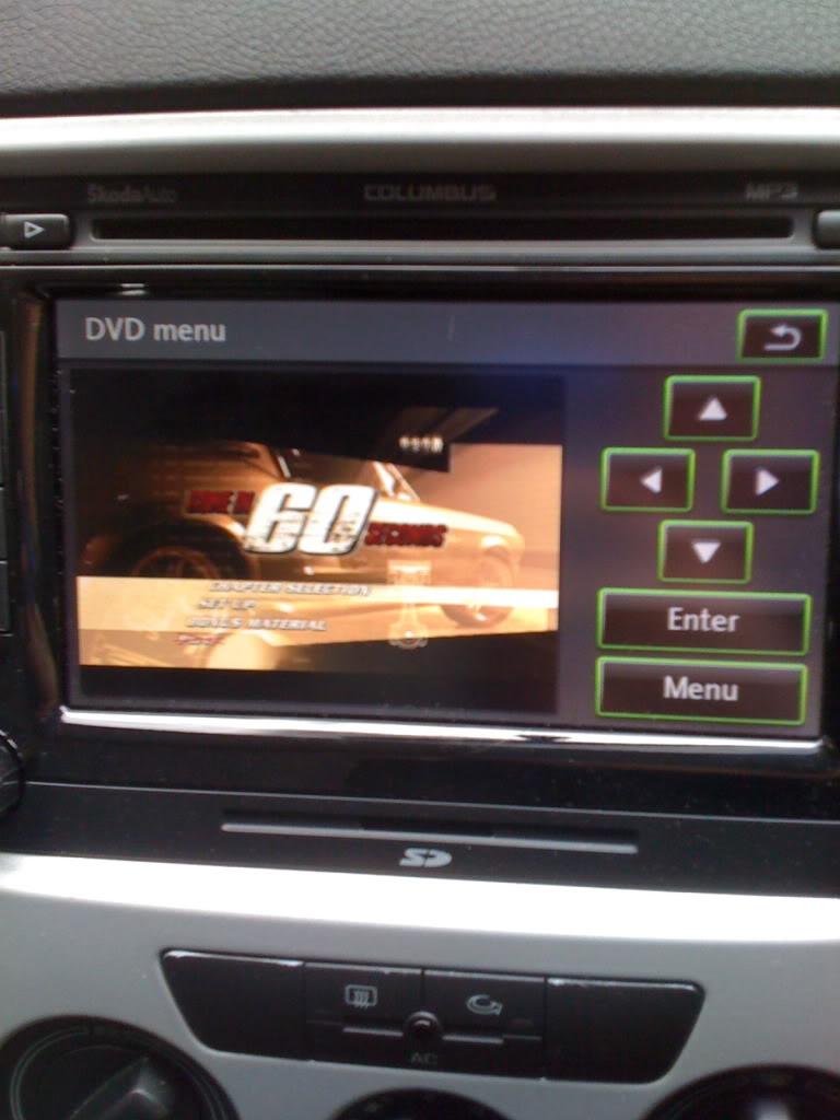

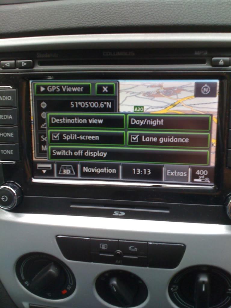

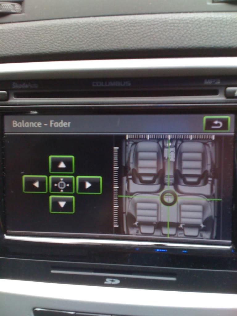

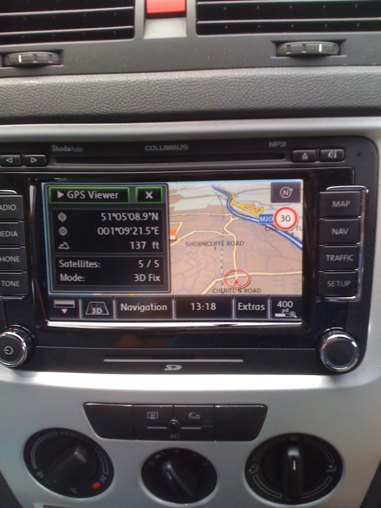

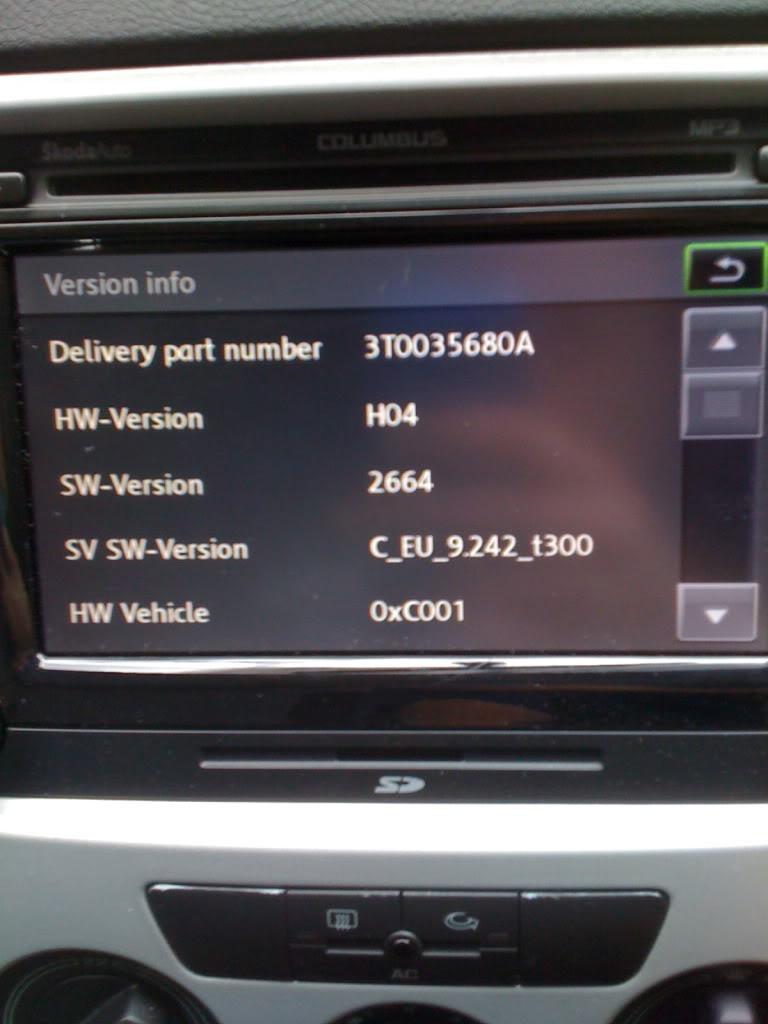

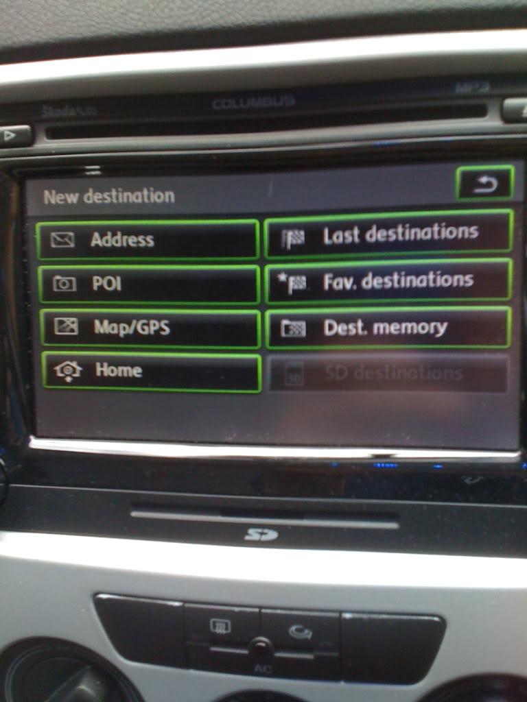

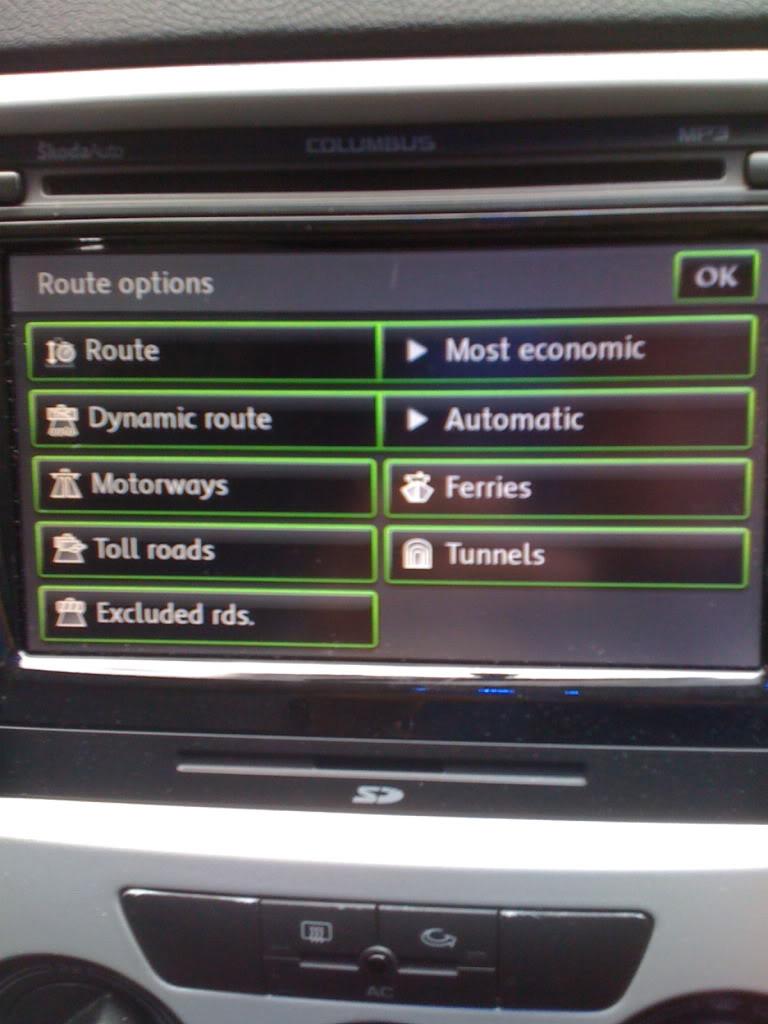

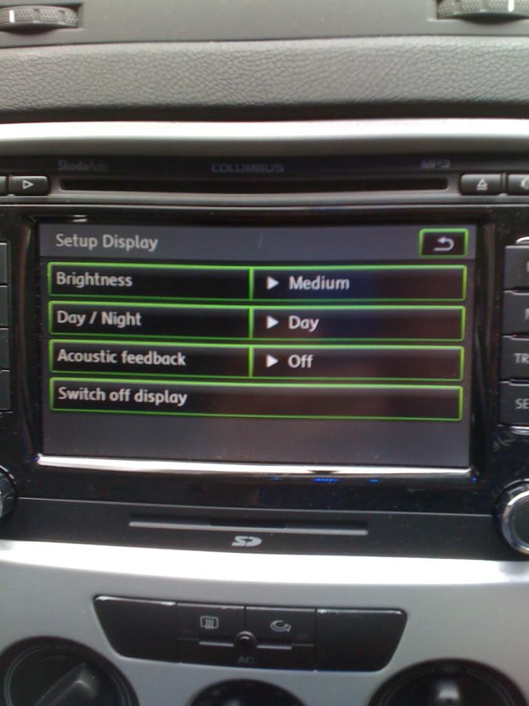

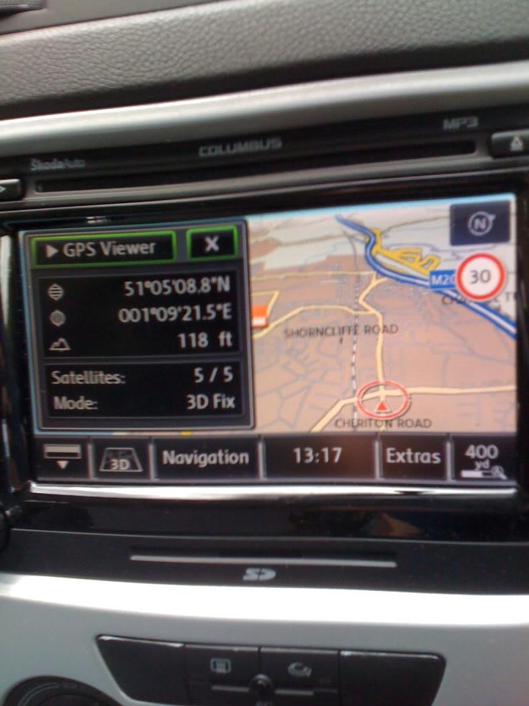

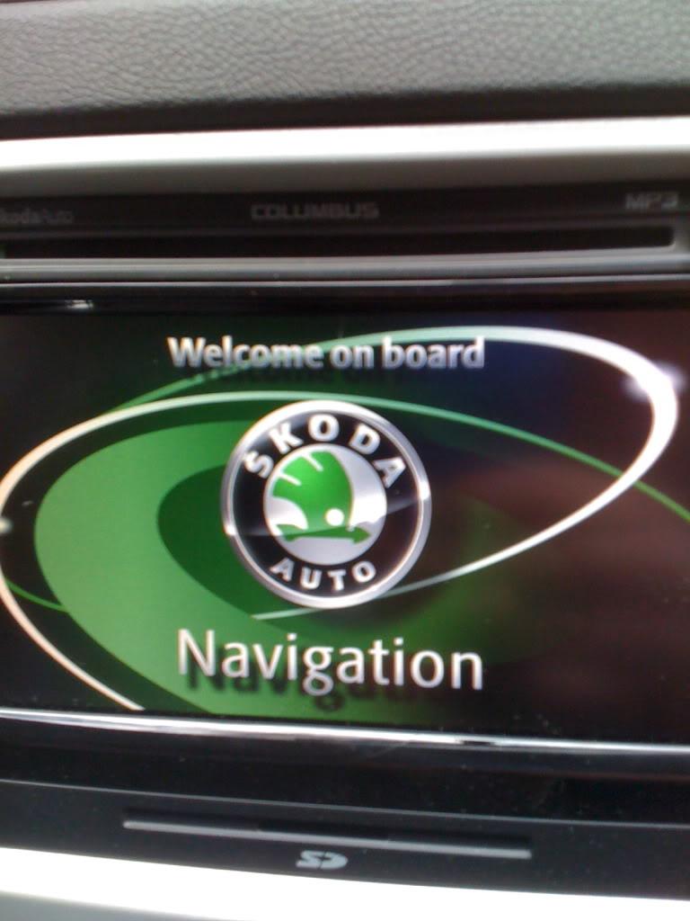

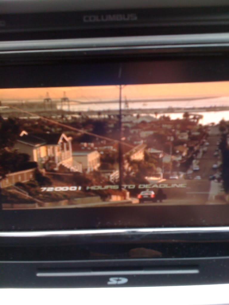

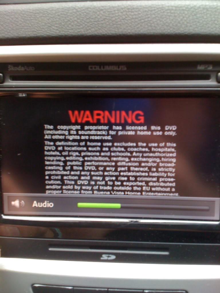

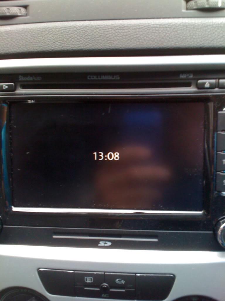

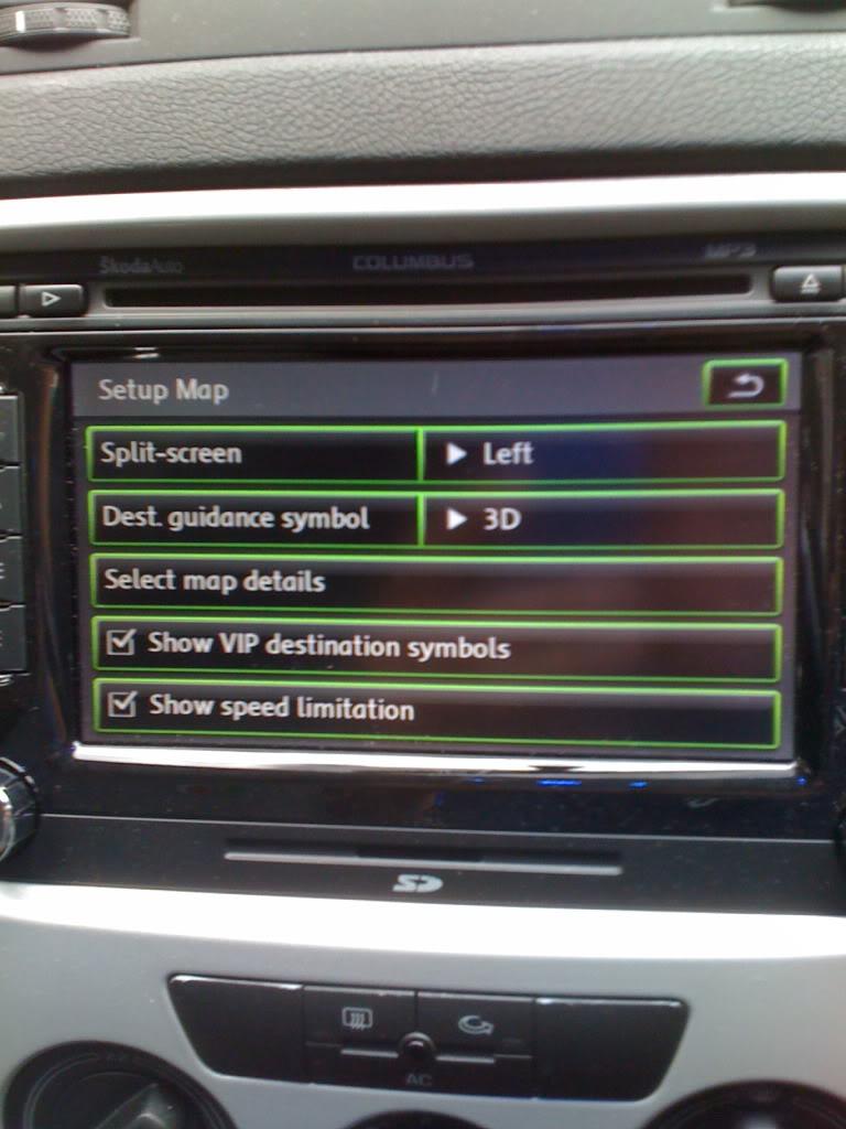

Ok here are the pics for the New stuff on 2664 firmware. (VW units will prob read 2660 iirc)
I know it's Skoda but as i said all units are basically the same just coded slightly different for VW/Seat/Skoda etc
Sorry for the crap pics i took them on the piephone whilst in the car
1. Firmware done (sorry didnt take a pic as i was loading)
2. Menu Showing how to get Speed Limit Display
3. Switch Off Display Setting
4. SD Card entries now viable for Navigation (not sure if they had this before ive never noticed it)
5. New "excluded roads" route Option
6. Visual Balance & Fader
7. Pic Of DVD Menu
8. DVD Working
9. Showing time on Map Display and New Menu enabling Display Switch Off
10. New Style Start up Image (colours more vibrant)
11. Showing Software info (if your wondering why i have a 3T0 unit its because i upgraded my 1Z0 to a 3T0 for some extra functionality a while back if you have 1Z0 it will remain 1Z0) VW will show 2660 i think
12. A couple showing the Road your on Speed Limit display
13. New Volume Bar
14. Showing Clock with unit Off
I know those with a MK2 Superb with this unit from the factory will have a lot of this but for those with 1Z0 units i'd defo recommend it.
The unit seems a lot more responsive aswell and if your wondering why the number of Satellites shown is so small the unit does that after a firmware update for some reason i now get 8/8 satellites.
As for SDHC not sure yet but as soon as i know i will update this thread
If anyone wants any help feel free to PM or ask
HTH
Carl :happy2:
