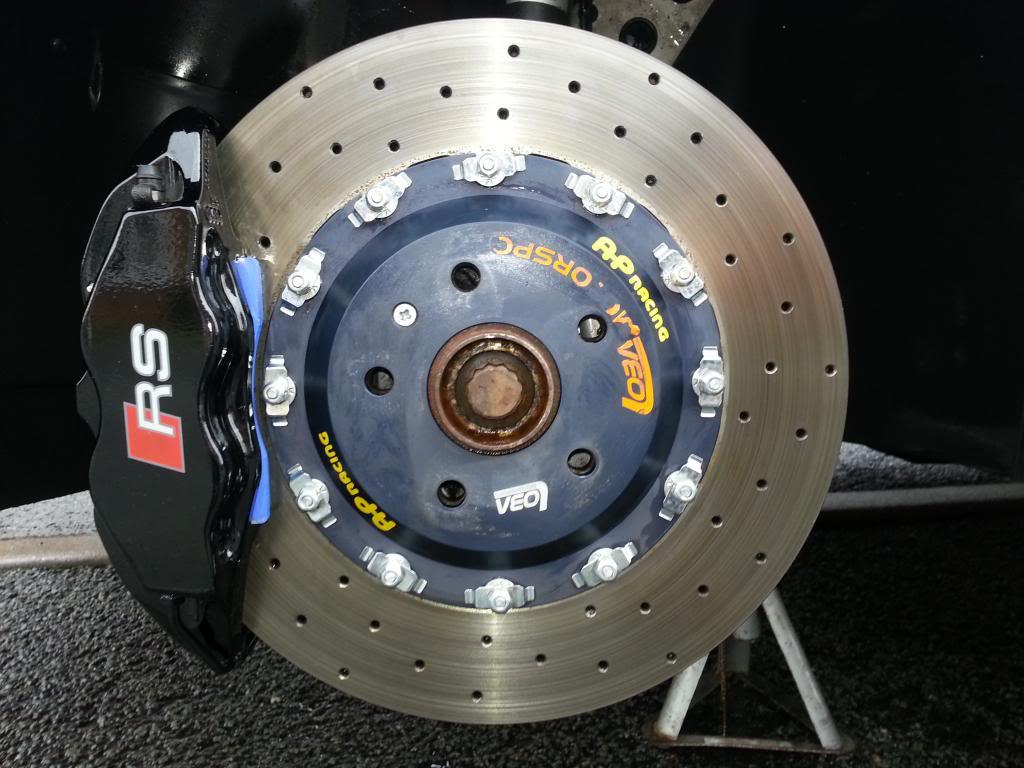

ladies and gentlemen I give you my replacement front and rear discs and pads.
According to the boxes and stickers on the discs they have been fitted 'correctly' however the direction of the cross drilling isnt the same front to rear and offends my symmetry fussiness  :grin:
Before it didnt matter as I only ran front cross drilled
The front vented are 340mm TTS discs (to replace 345mm previously) so it doesnt matter which way round they run (as the airflow is the same fitted either way)
The rears arent vented so doesnt matter either (but were fitted according to stickers)
(out of interest for some discs it does matter based on the internal direction of the vanes, NOT the outer appearance)
What way do other people run?
My preference is to now have the rears swapped to make the drilling match!
The pedal feel is awesome and im really happy thanks to Dave B
pics are looking from passengers side of car, so direction of travel is from right to left (anticlockwise)

the fronts look the wrong way to me mate, just been and checked mine in the garage and they are the other way, not sure how much difference it will make. More importantly you CANNOT have different colour calipers front to rear  :smiley:

really Gaz ? wow
The orientation matches the first set that went on when I moved to S3 brakes! the plot thickens.
They are brembo and were marked L/R sided
maybe I should swap the fronts round then  :signLOL: , waiting for DaveB to comment  :party:

The rears look on the wrong way round to me. Garage did the same to me and I made them swap them. I imagine it makes zero difference however too much for my ocd.

for this scenario with these discs I dont believe theres a 'wrong' way as neither way effects flow, however it upsets my OCD too.

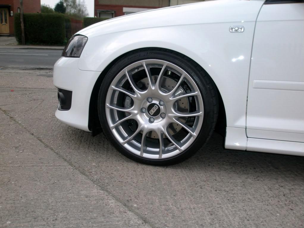

my fronts and Dave has cast an eye over them several times

cool , thanks Gaz, the key point is whether the internal vanes on your discs are directional and dictates a specific orientation  :happy2:

just trying to help  :smiley: my daveb drilled 345's were fitted the same way
in fact no they weren't they were fitted like yours, DaveB needs to come and rescue us mere mortals

Those are fitted correctly.
Dont be confused by the drill pattern tho... as they should be "sided" according to there internal vane direction. If the vanes are straight then (im sure dave will correct me) orientation doesnt really matter that much.
