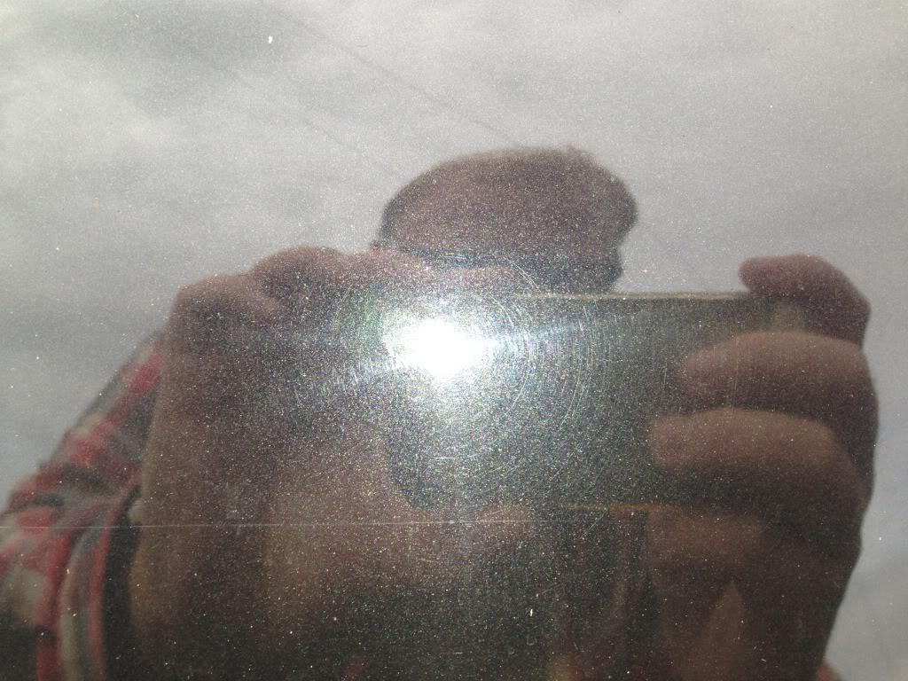

These are commonly referred to as swirl marks which are caused entirely by improper washing and drying. If you never wash your car you will never have swirl marks!  :rolleye:
What causes surface defects, such as swirl marks, hologramming, micromarring?
Swirlmarks are caused by minute particles or dirt, grit, mud, stones, that get sandwiched between your cars paintwork and whatever material it is that you are using on the paintwork.
If your paintwork is completely clean and you take a completely clean microfibre towel, and wipe it on the paintwork, you would leave no marks (in theory anyway).
They happen because of the fine marks and scratches within your paint, and the light hits them and causes them to become refracted and rather than bouncing back straight into your eye, it gets scattered in every which way direction.
Here are some heavy swirl marks
This is caused by years of very poor washing techniques, sponges and chamois, water blades, dirty cloths, etc
As a car enthusiast you will wash your car, and everyone does it, and throughout the washing and drying process, swirls are inflicted into the paint surface. These are what I call little "love marks" , as part of caring for your care you will put little marks into it, tiny scratches. Normal wash marks are as below. This is from my friends Audi S3 that I corrected for him.
Minor hologramming is often referred to as micromarring as well - basically microscoping "marring" (faults) to the surface have been created.
There are also other types of surface defects like sanding marks - where the panel has been sanded for painting and has not been sanded up to the right grit before the paint has been sprayed onto it.
They look similar to this.
You also have "Random Deep Scratches" also known as RDS which are often caused by brushing stones or articles of clothing against the vehicle, maybe with a branch or a button on a pair of jeans or similar. These are not caused by normal washing.
Here you can see some swirls and also an "RDS" (going horizontally about 3/4 of the way down the image, again from my friends' S3.

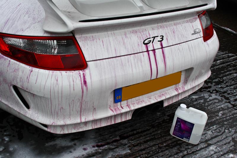

Next you can use an Iron fallout removal product.
Iron is what I find personally gives the most gritty feeling on paint, as by it's nature the particles of iron are rough. They are also the hardest to remove. Clay will remove these but at greater risk of damaging the paint.
Some very clever people found a way to actually turn iron soluble and so Iron X was born. Other products are available but they do not often work as well, stick with the original and best IMHO.
ALL Iron fallout removers smell. This is because of the chemical. The less they smell generally the less effective they are. Iron X cherry is not a BAD smell but it's not exactly a field of roses. They do a Lemon scent one which has no foul smell at all.
What I'm trying to say is, it often smells. Deal with it.  :surprised: :surprised:
anyway - Spray this liberally to the entire car and then allow it a few minutes to react. You would see any reactions leaving long purple lines down the vehicle. This is often best sent on silver or white cars.
Once you've given it a few minutes to react you need to rinse the car off thoroughly. If you have a jet wash and foam lance now would be a good time to use it once again.

Firstly you need to be able to inspect your paint so the best tool for this is a SUN GUN.
This can be a really bright torch, phone light, whatever. However you need something really bright.
Phone lines are only really good on really dark cars and you get a very narrow angle of viewing (as the light power is quite weak)
The best thing for the money is what's called a Brinkmann Dual Xenon which is what I have.
It is a rechargable flashlight where you can adjust whether there is one or two bulbs. It charges up from a US socket (adaptor) or from your cigarette lighter which if you're a traveling detailer or valeter it can be charged while you're driving about.
This is to help you spot the swirls to begin with. This is very important both from a "diagnoses" point of view, that being you are assesing how bad the paintwork is and also when you are in the process of actually correcting the paint, an easy way to verify your progress and ensure you're actually getting the results you want.
Swirls are based on seeing fine imperfections in the paint at many angles. Therefore a stronger light is good so you can move around and see more clearly. It's possible for example, that you may remove a scratch when you look at it from one angle but when you look at it from another it's there clear as day. This is where a sungun and/or strong light source help you. Being handheld it's easy to move about and get a much better view as well.

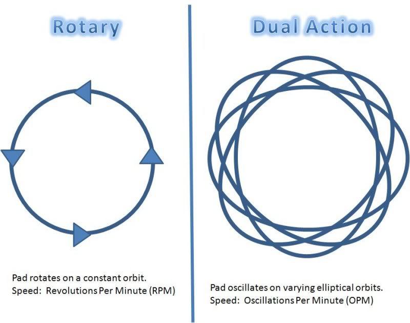

The difference is in the way the heads (where the pads mount) rotate. There are new Dual Action polishers out (the Rupes bigfoot for example) which combine the ease of use of a DA with the speed of a rotary by having a larger throw (cover more surface area basically).
Rotaries as their name suggests are rotary only. They spin about a fixed axis.
On a Dual action, what a lot of people don't understand is that they also spin however their axis is not fixed as such, it oscillates
So machine choice is fairly important but not the be all and end all. If you are really new to the whole detailing and paint correction game then definitely start with a rotary.
DA's work on SPEED SETTINGS eg 1-6 and rotaries work on a RPM basis.. DA's speed settings still correspond to an RPM however that information may be different on each machine, same goes for rotary.

« Reply #13 on: November 06, 2013, 09:47:40 AM »
Yes they do, by removing layers of paint. They work in a fixed pattern (as in constantly rotating about a given point at a given speed). A small amount of dirt will normally be broken down by the pad/polish/machine - No ill effect will be had.
Using your own hand will result in RANDOM patterns.. By hand you can't get that sort of power. more likely to cause marring.
Using circular motions on the panel when washing/drying/applying waxes, means if you are going to put swirls and scratches in, rather than being straight line scratches, which are only visible from certain angles in certain light, you are going to put circular scratches and swirls in, which are visible from most angles and most lights. Basic rules of light  :happy2:
