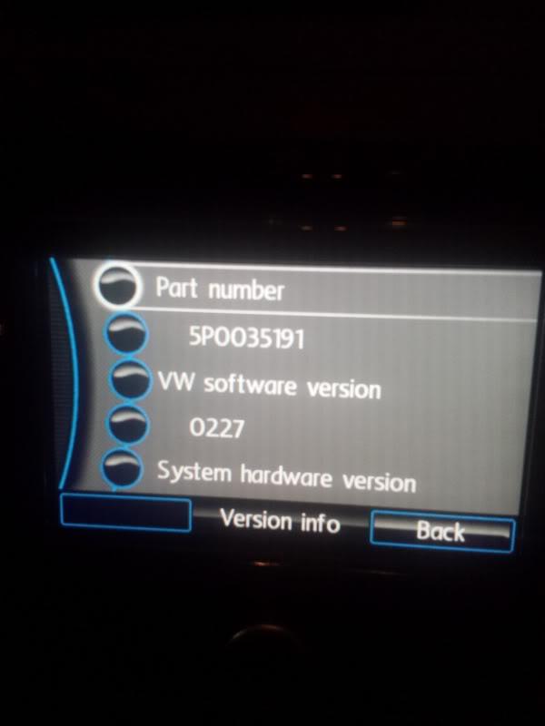

2.Now we need to establish what firmware you current have, With the device on press and hold the setup button for around 10 seconds,This will display a secret menu the 3rd option will say versions scroll down and select that. As you can see in the picture below my original firmware was version 0227.

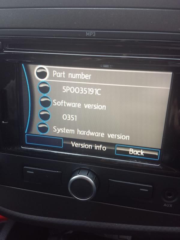

6.After about 45 minutes the update will have finished and it will have ejected the disc. If you now press and hold setup again you should now see version 0351 like below.

8.Once again when completed press and hold setup and it should display V0351 like below.

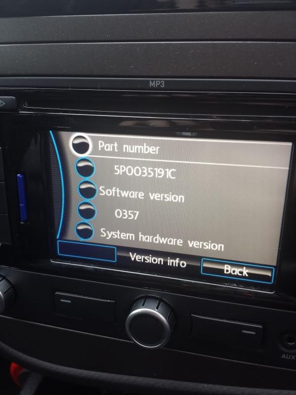

11.Update finished, device booted and press and hold setup, go to version and you will see  0537 like below.

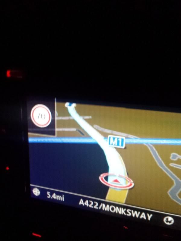

1.Option to turn on road sign display, This is now tested and when turned on it will show a small speed limit sign in the top corner like in the image below.

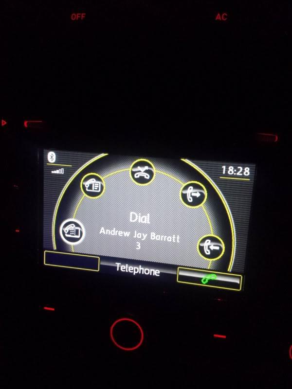

3.Phone button on device - Previously on Version 2xx the phone button did nothing other than muted the device, on Version 3xx the phone button now displays options like call, previous calls etc, see image below.
