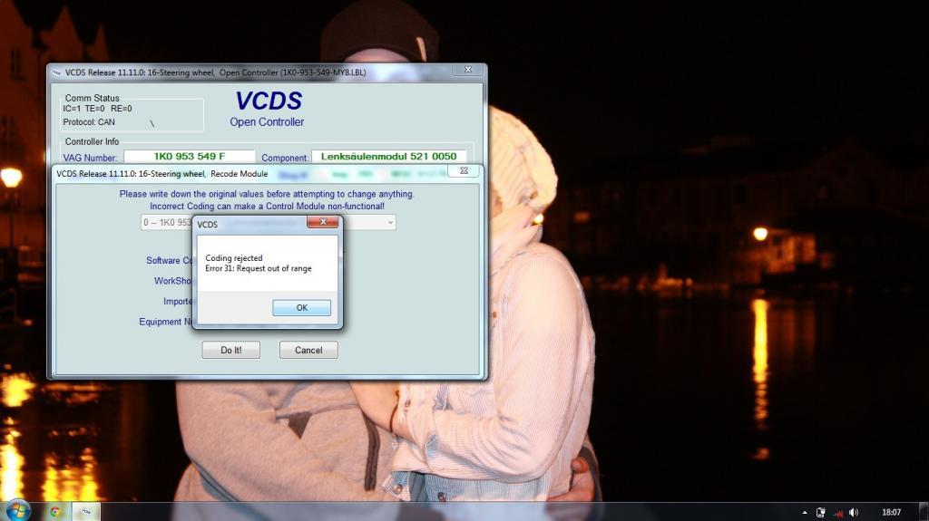

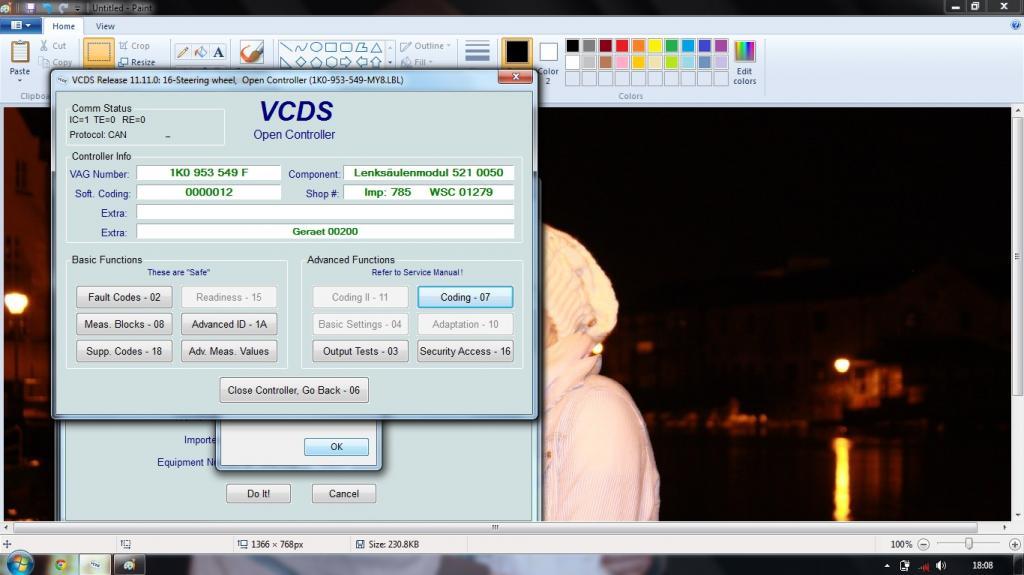

I'm stuck, fitted the stalk, done the long coding on Engine. Went to activate on steering wheel, put in the coding 0000032, I get a error. Pics below. Any ideas?
049412 - No Communication with Cruise Control Module
               U0104 - 008 -
             Freeze Frame:
                    Fault Status: 01101000
                    Fault Priority: 0
                    Fault Frequency: 1
                    Mileage: 142161 km
                    Time Indication: 0
                    Date: 2000.00.00
                    Time: 17:47:33

was the diagnostic wire present?

sorry, can you dumb that down? the vcds lead or you on about the little black wire? all that was in the kit was fitted by a mate of mine who works for vw/skoda.

Under Faults on 16-Steering Wheel says coding 01044-Control Module Incorrectly Coded

« Reply #4 on: November 30, 2013, 06:27:27 pm »
code it 42

« Reply #5 on: November 30, 2013, 06:34:25 pm »
it accepted 42. that be all? now just go for a test drive?

« Reply #6 on: November 30, 2013, 06:45:22 pm »
yes

« Reply #7 on: November 30, 2013, 06:51:22 pm »
Thank you, it worked. I looked at that list on ross-tech and it doesn't label my car or module with a highline dash which mine has got.
