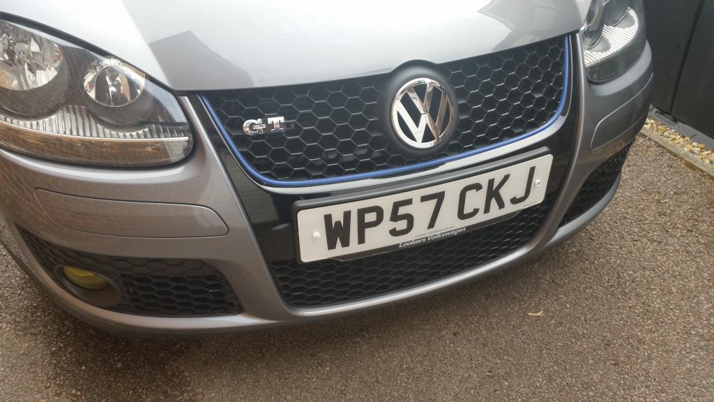

Just picked this up last week for  its only the 1.9 TDI with 130k on but had the flywheel and clutch done at 125k and belt and pump done at 115k so bargain i thought!
Heres a few pics of how i got it

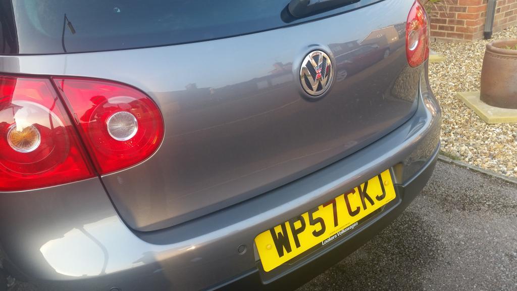

She has a crack in the rear light but ive bought a full set off a guy on here for £15 so going to give them a lick with some tint spray i have laying around.
Also back bumper has a small scuff and crack so going to buy a replacement on saturday along with one of these:

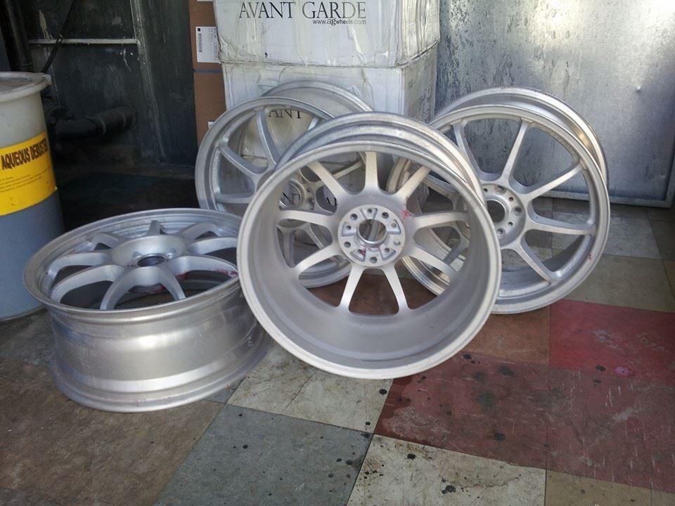

Just picked up some 18" Merc wheels today for £400 with the tyres so this weekends job is to bore them and souce some long bolts, any help would be great ( the audi TTRS style wheels in the first pics are up for sale if anyones interested)

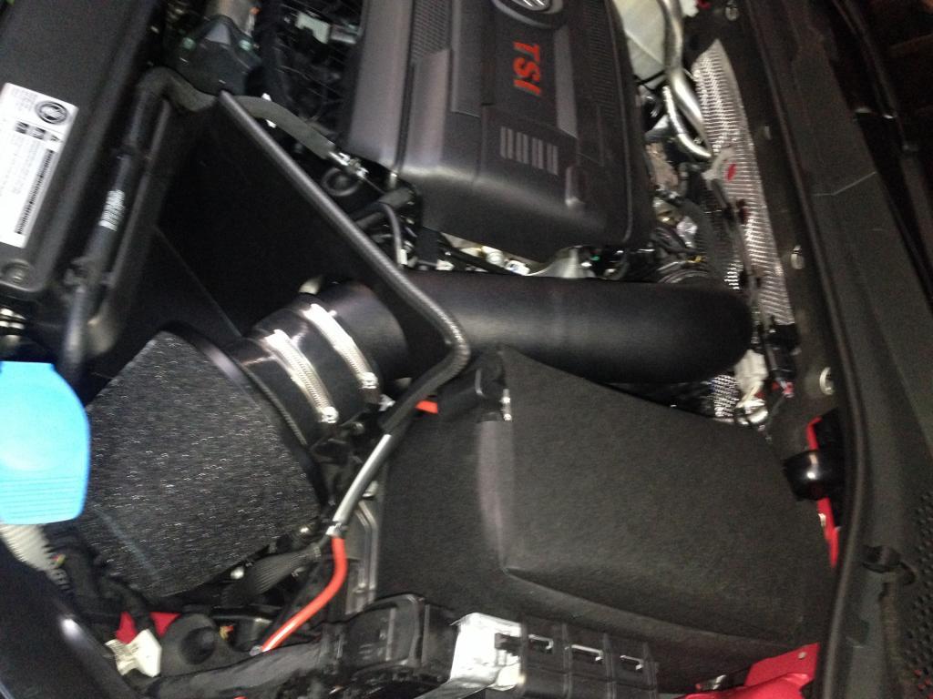

And also, just a bit of advice, stick with a standard paper filter on these TDI engines. Foam filters can ruin your turbo.  :happy2:
BcPitta
yeah the merc ones from m12 to m14 bud, and ive always had diesels and never had any trouble with the foam panel filters ? i just like the fact i can wip it off and clean it every other month. any particular reason why it might ruining a turbo?
xjay1337
Yeah that's a ball ache with some merc wheels :(
There are absolutely no gains to be had from a foam filter on these engines. Their filtration is less and the dirt which gets through will damage the turbine blades in the long run.
The standard intake is not limiting whatsoever and has been used in cars with over 300bhp without issue. Paper filters are £10 from the motor factors so it would take at least 4 services (every 10k for arguments sake) to recoup the saving presuming you paid £40 .
If you want to allow more flow without causing any damage look into a S2000 paper filter - However again these don't really provide any benefit unless you're running huge turbos and have cold air feeds  :happy2: - However they would allow slightly more air to flow due to a larger surface area and are paper rather than foam/cotton so filtration remains high. FOD damage on these turbos can be terminal.
